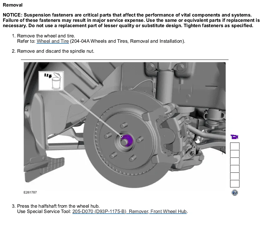

Remove the rear wheels one at a time and check that the spindle nut is tight. I believe it is a 32 MM socket. If you are unable, take it to any decent local repair place (obviously not Ford) and have them check this. if one or both is loose, have them apply red loctite to the threads of the nut and torque them back down.

Les Schwab, Christian Brothers, Meineke etc. in your area? This nut coming loose and making the exact noise you have in your video is a known issue. The Axle may be tapping back and forth inside it's splines. Unsure if the socket will fit into the hub bore hole of the wheel if you remove just the center cap
