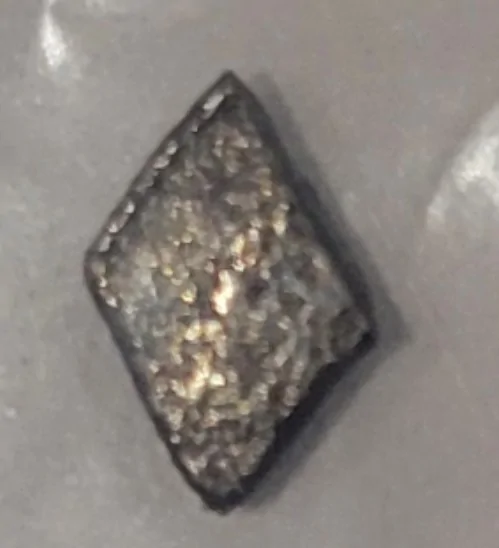

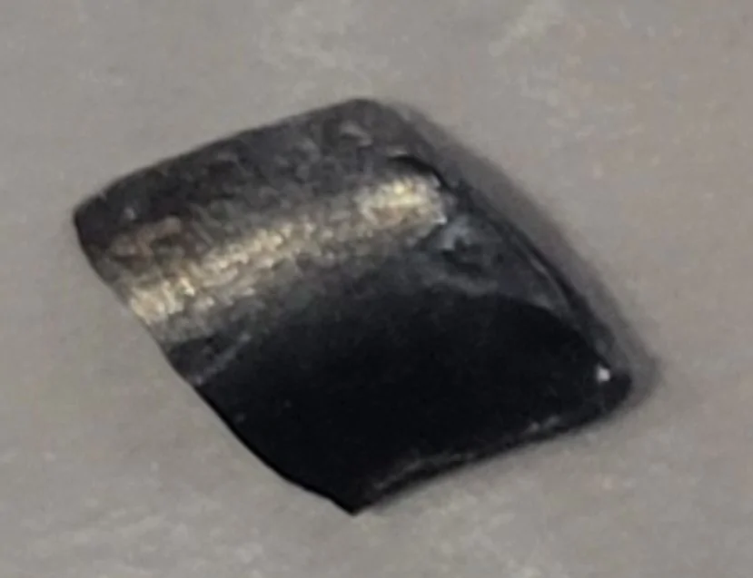

Found this today. Any clue what it may have come from or how much I should be worried? First oil change w/ the magnetic plug (clearly worth the money), so I'm not sure if this is a new issue. I happened to save the filter from the last oil change. I cut both open, and there's a few slivers and a little glitter this time, but not much. nothing notable in the older one.

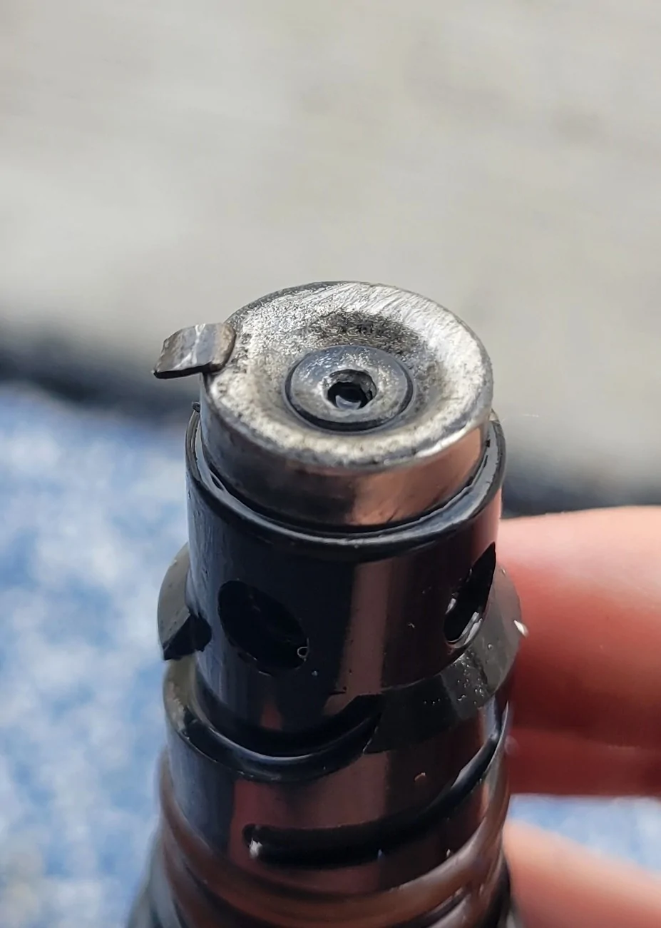

Those aren’t bearings that’s steel from the valvetrain. Most likely a failing roller/follower or lash adjuster. Pull the valve covers and check for a bad roller or cam lobe

much appreciated.
