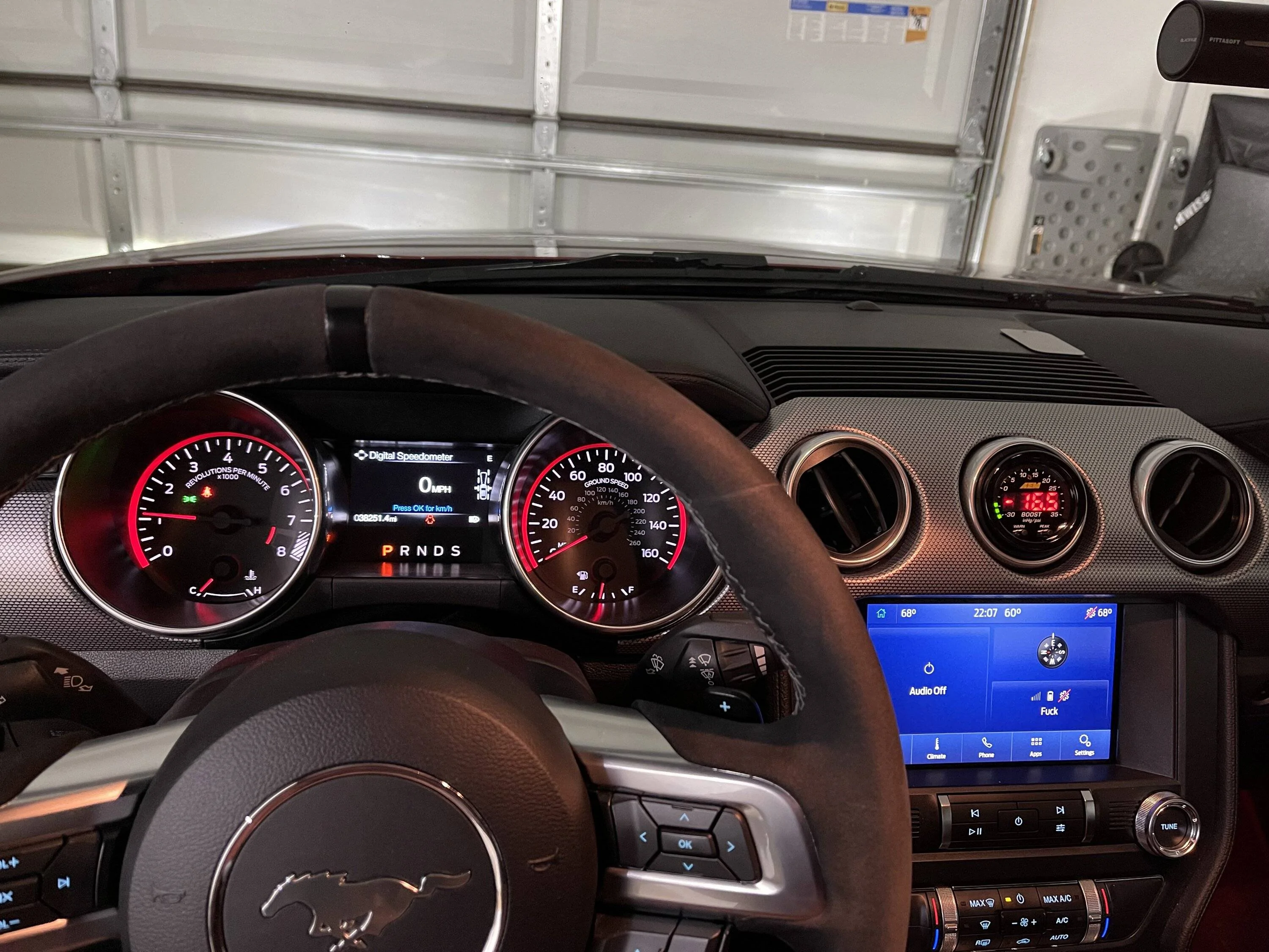

Yup, I had the P3/raxium gauge on my last car, and it did have a "zero" function. I like it because it can also be wired to display all sorts of stuff like ethanol content (with an ethanol sensor), AFR, Coolant temp, Ignition timing etc.

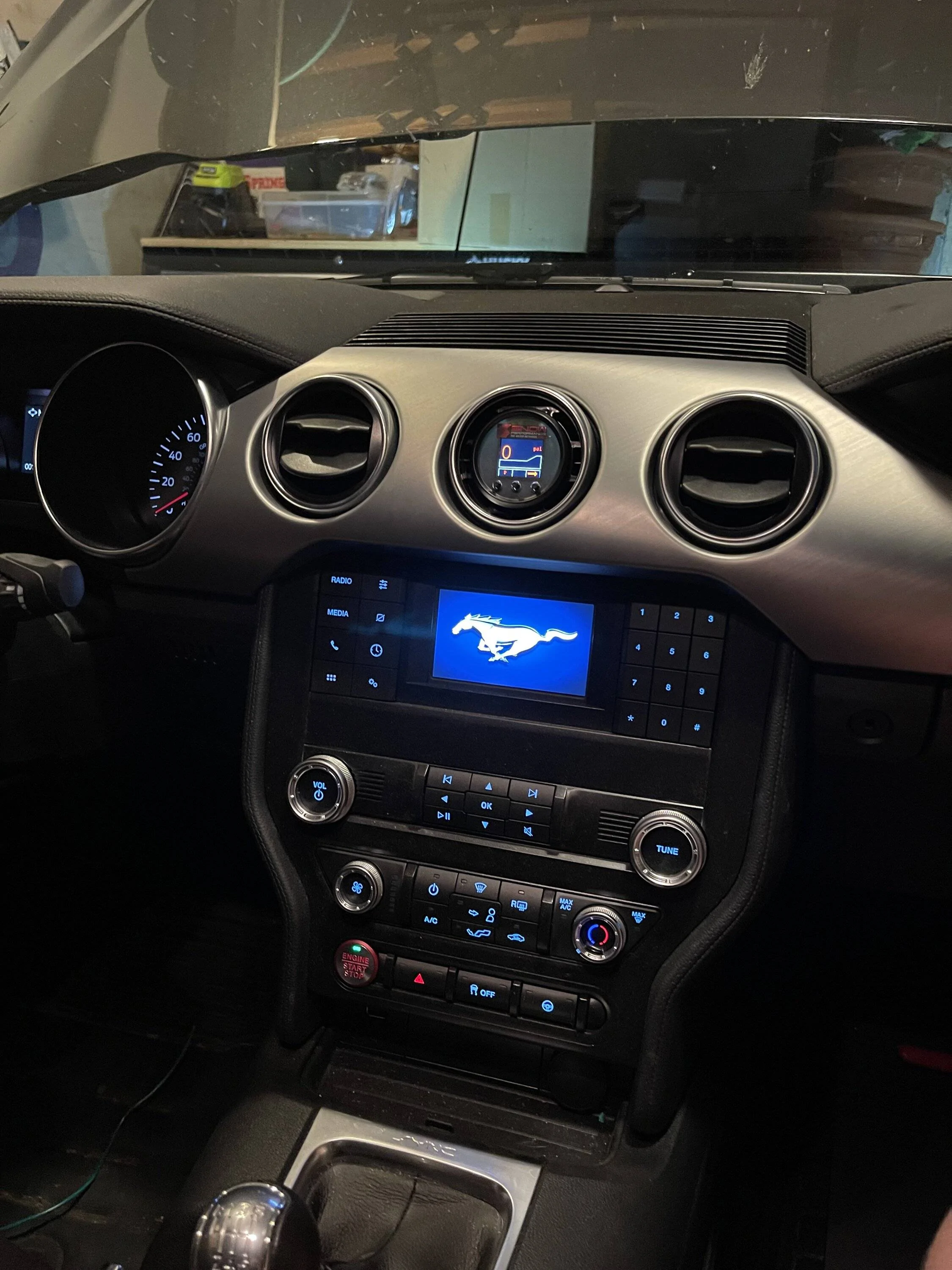

The AEM X-Series boost gauge is what I use. It has a 0-5v MAP output that I run to my HP Tuners MPVI to data log actual MAP. It also has a peak memory recall that I find to be more convenient than trying to look at a gauge in the middle of a pull. Only downside is the gauge’s MAP sensor is sensitive to vibration. The instructions specifically state not to directly attach the sensor to the engine. I screwed my (first) sensor straight into the boost reference port on my Whipple and it died in about 8000 miles. I now have it mounted remotely via a vacuum line.
Another nice feature is it’s really slim and requires very little depth to mount. I designed and 3D printed a mount that goes in my center vent and angles the gauge towards me.
