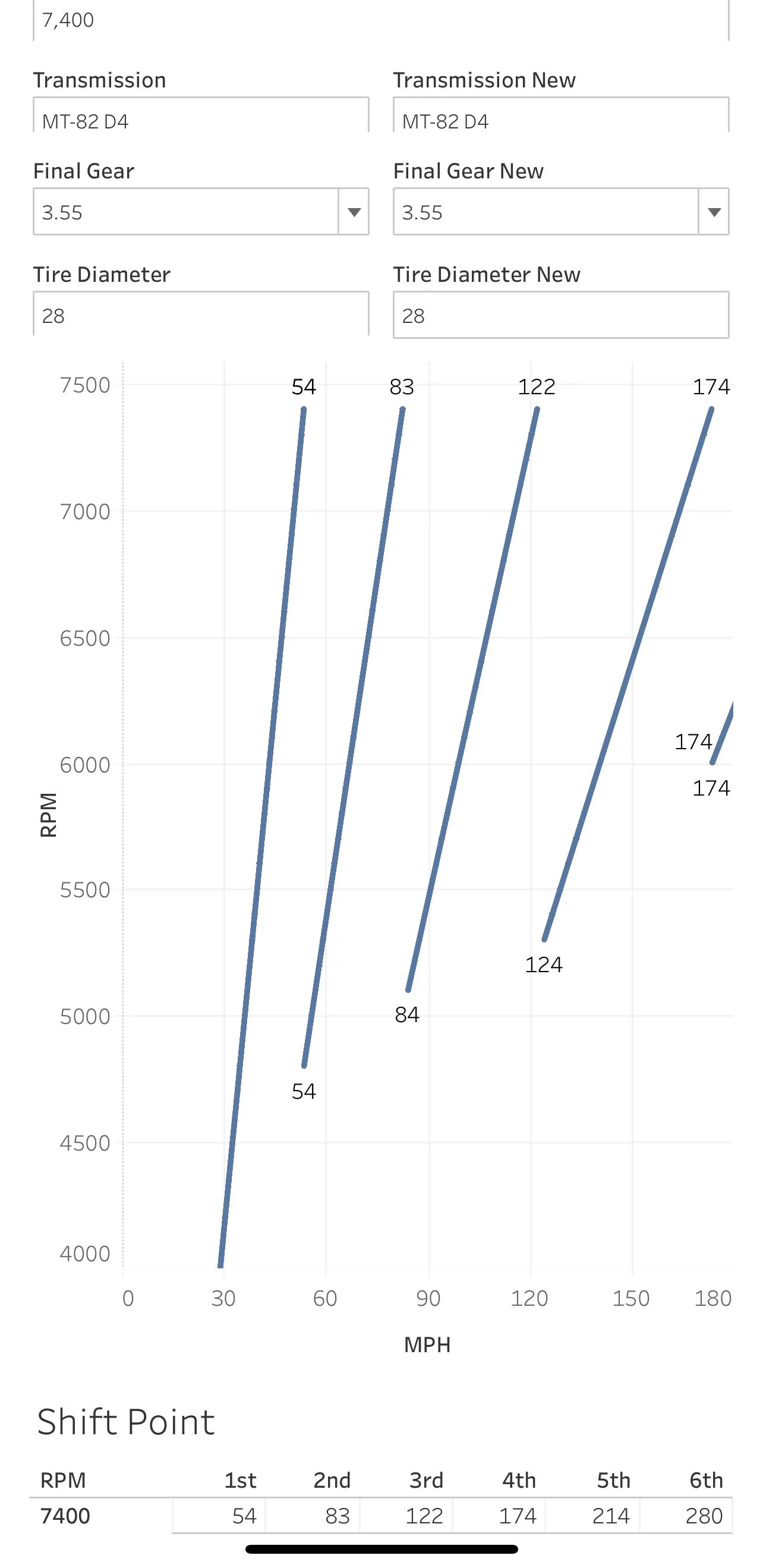

What are probable overrev issues on a Coyote 5.0? Factory redline is 7400 (Gen3). No ticking noises heard... Valves? Bearings? Piston rings? I honestly have no idea. Would it cause damage if it hit 8000 for 2 seconds? What rpm is 75mph in 2nd gear on an MT82 D4 car with 3.55 gears?

2nd gear in the stock Mustang with 3.55 gearing is about 6970 rpm at 75 mph.
