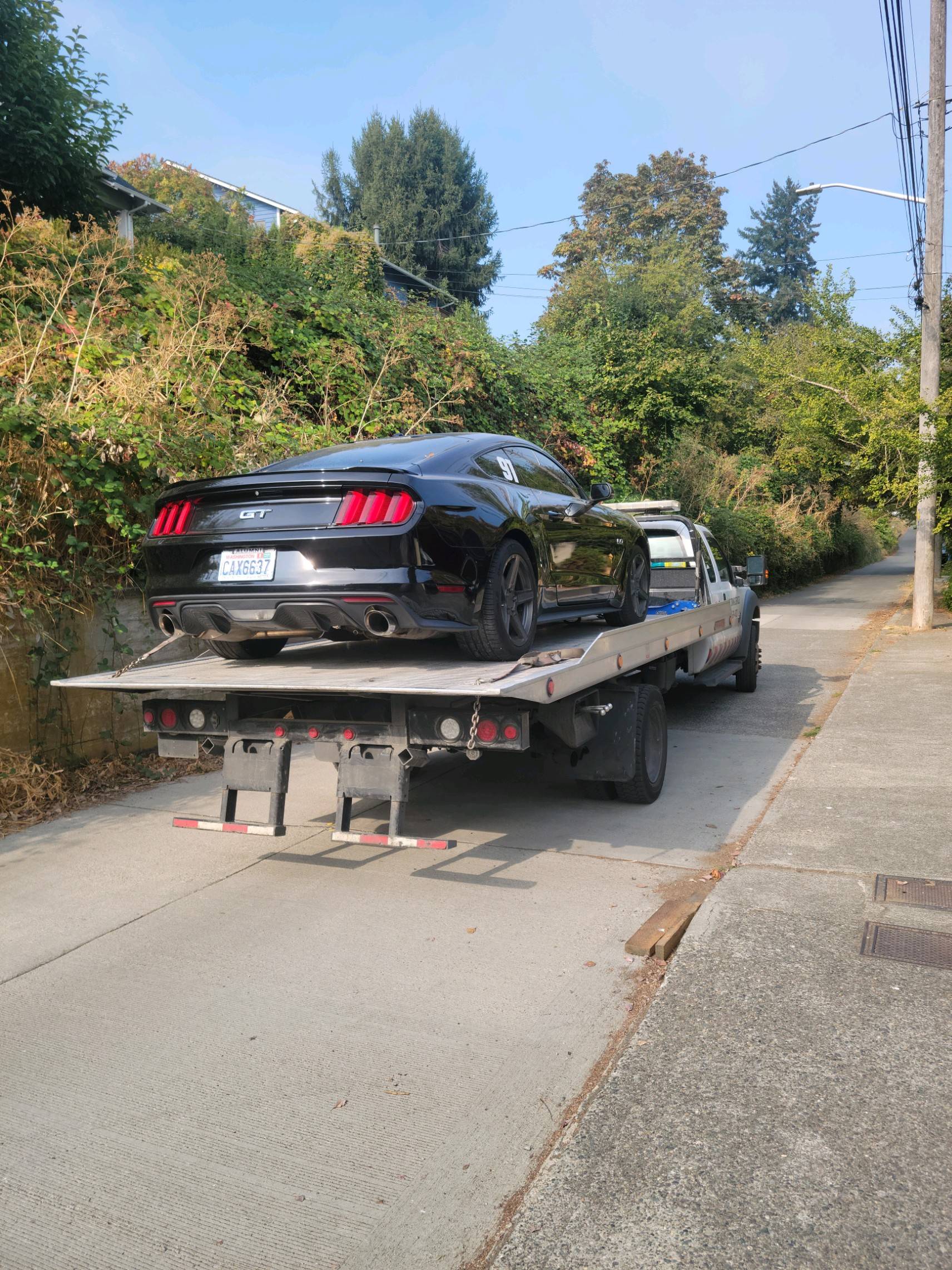

Like many people, I’ve dealt with my stock MT82 issues, and scrambled to find the solution. High RPM lockout was annoying since my car is tuned for max power at 8k rpm, and I grew to resent the car because of this flaw. Eventually it gave out on track.
