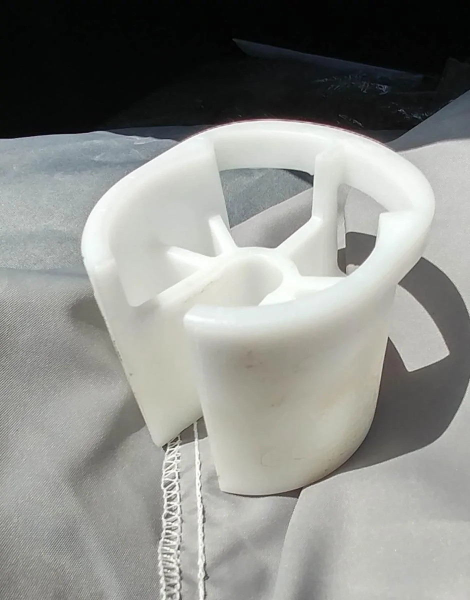

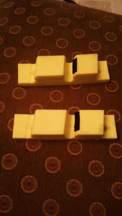

I got them out , and it was not easy !!....Okay I just drove it and it feels much better...Let me ask do they have them in the rear as well? the car is still a little bounce-y.... Oh and I race a new corvette and lost..badly..lol In my defense..I did not want to floor it....but still..that car is fast....oh well back to the yellow spring "things" what else can make the car so bouncy ?
Maybe mine was a little easier cause I had more miles on it. Neat little souvenirs though... Adds character to the experience. But they should've been removed from the dealer.
How did you remove them?
Don't know about the rear for yours but mine didn't have any and I'm assuming they're only in the front to aid in loading/unloading the car.

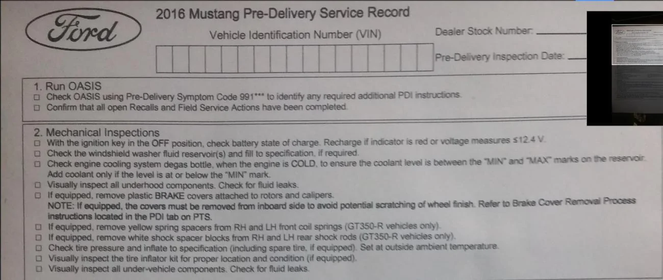

Gentlemen That OWN R's only listen up...lol see PDI list below See #2 half way down the list..:thumbsup:
IF you had the spring spacers on the front and had to remove them yourself then I assure you the dealer forgot the ones on the back as well.:doh:.These are not on the normal GT350 but only the R's :shrug: Everyone that has a R should check to see if they are still on the car.:eyebulge:..When off the car will ride great !!!!!!!!! :headbang:
No brother they are on both ends, and the back are not possible to remove with out lifting the car...the front was removed with a pair of piers and good old fashion brute..:paddle: You might want to check yours
This is going to be so funny if everyone's R had this crap still on them...I can not wait to hear how well everyone likes their R's with these spacers off of them....I put 100 miserable miles on my car ...thinking bad thoughts the whole time..Do not get me wrong the car is fast, loud, beautiful, and turns on a dime...it was just the bouncing...Im so happy I started this thread...thanks again P.S...This Ford PDI guy almost ruined my R experience for the first impressions anyway..lol Now I can enjoy my car..
