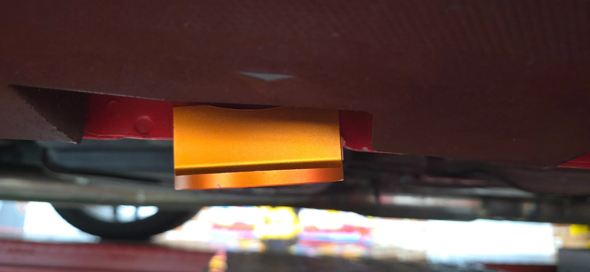

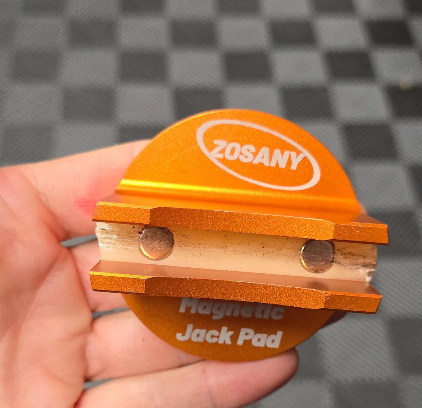

I’ve been using this one I got from Amazon. No problems with it and it has a strong magnet. Twice I forgot to remove it from the rail and did some driving and it stayed on.

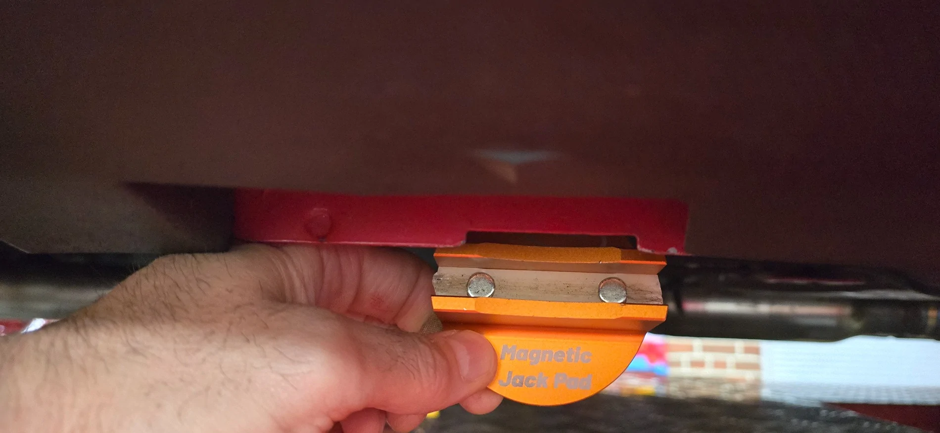

I have these but they're a little small. Works good in the front of the car. But the rear of our cars have this notch right by the jacking arrow. The nylon Magnetic pad barely spans the gap and you really have to pay attention to placing it so it doesn't fall into the gap. If it was an inch bigger in diameter it would be great. Ymmv.

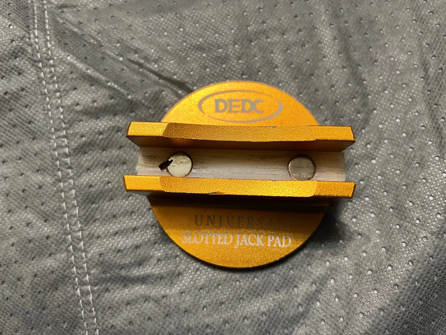

I have been using a set from eBay which looks the same as pictured in posts 2 and 5 for a couple years now.
I've noticed that at least one puck does not attract as strong as originally and can fall off before I get my Quickjack positioned.
I think the concept is good but the implementation is a bit lacking. The pressure on the nylon block is so great that it steadily wears down. That exposes the magnets more which can then crack. Then the puck does not hold on as strong. But recessing the magnets more only reduces the attraction force.
A cobalt magnet's pulling force increases faster with diameter than with its thickness. Obviously the magnet diameter is constrained by the channel width.
To me, the design could be improved if they were to put in a third magnet. So these pucks could be modified DIY, but that involves sourcing the appropriate magnets as well as drilling with a flat-tip bit such as Forstner. If mine continue to degrade perhaps I will try that.

A third magnet would be nice but I wonder how much it would affect the integrity of the nylon block..At $10 a piece, I'll probably just toss it once a magnet falls out and get another. If it lasts a couple years, that's a fair return imo.

Yep done that. "Wheres that damn....hey its still there "

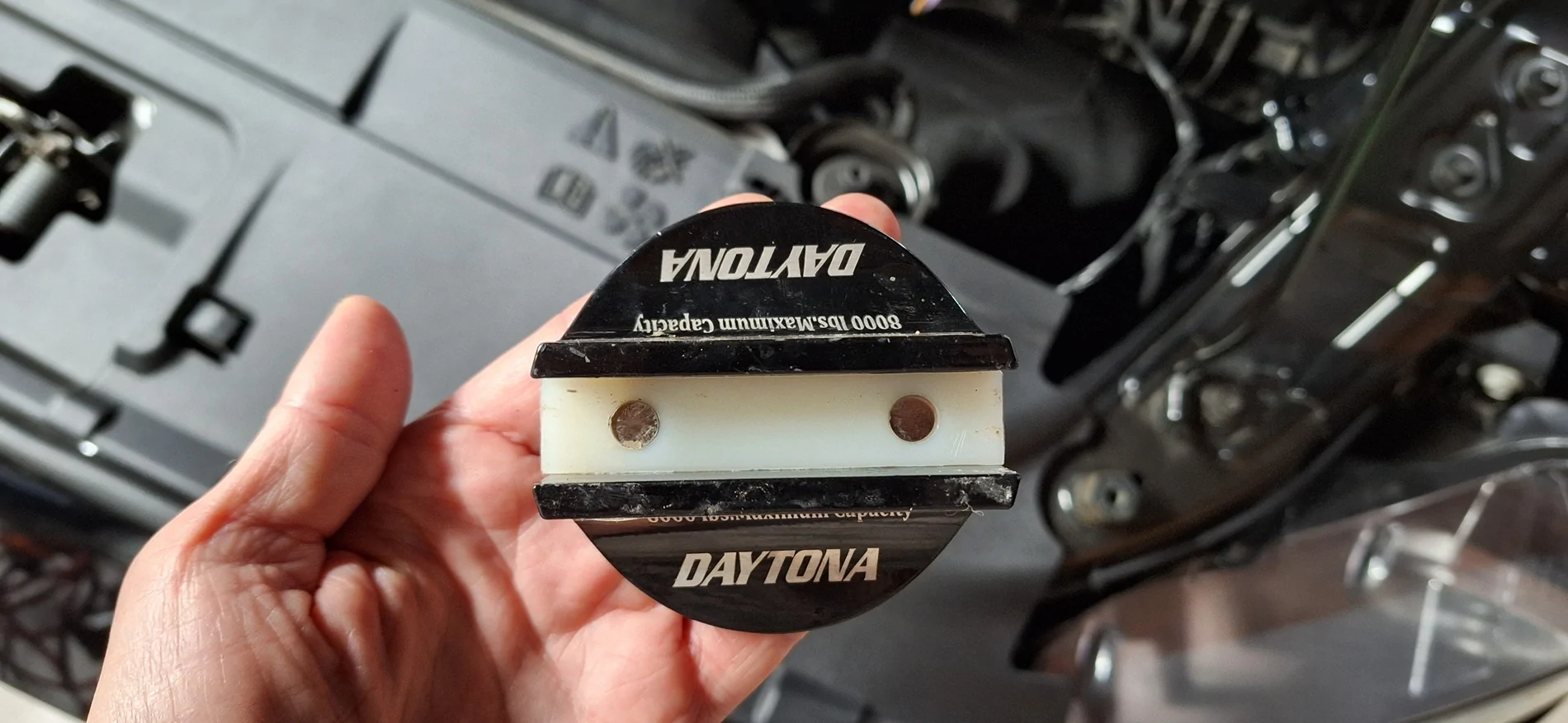

Harbor freight had some. Magnets don't seem particularly strong (or large) but it holds itself to the pinch weld and that's all it needs to do.
3in diameter.

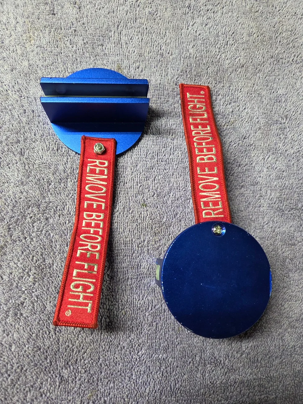

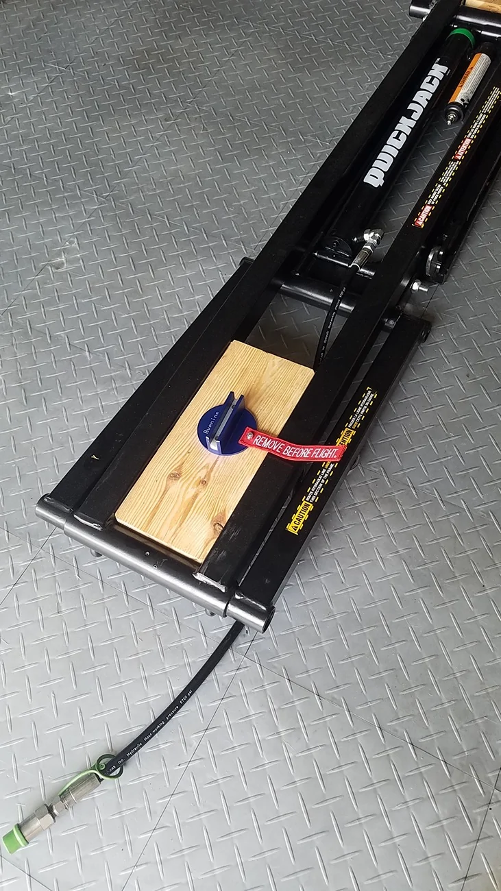

I added tags that show and remind me to remove them. Some on ebay already come this way.

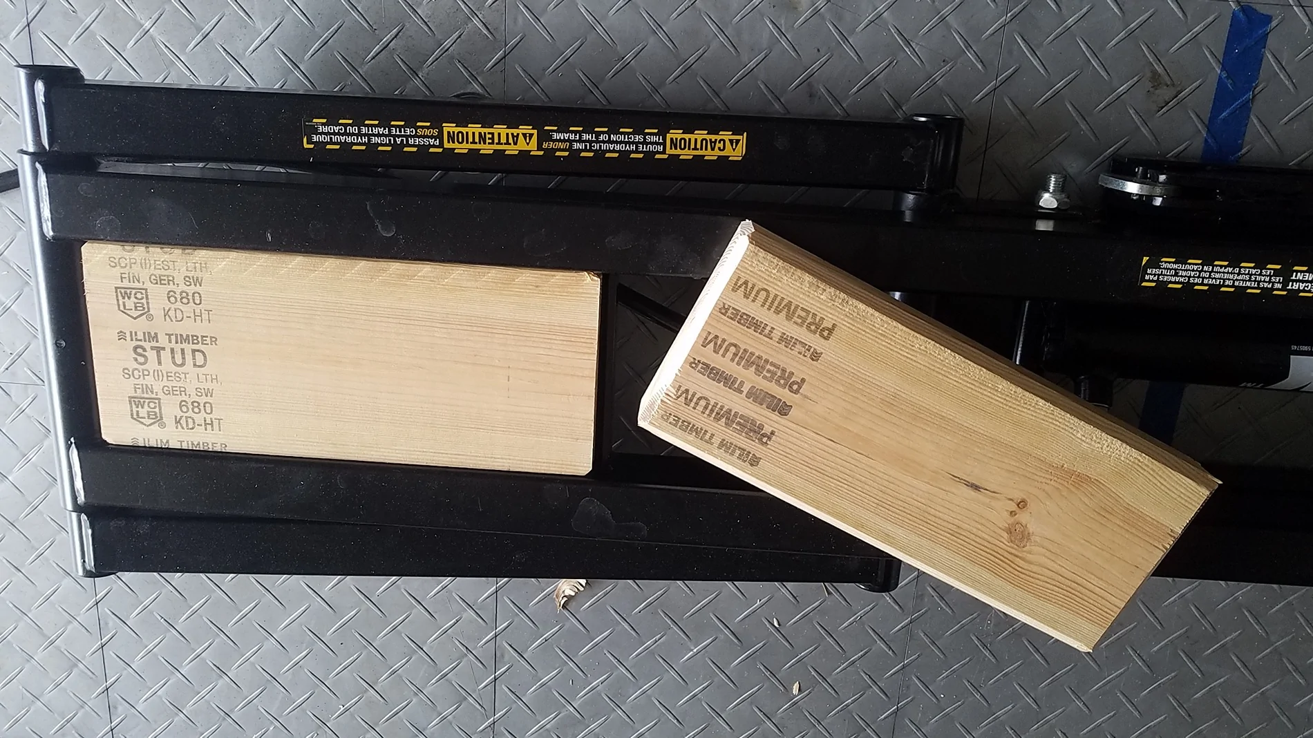

I cut down some 2x6 board to fill the Quickjack trays. The pucks sit on top of the wood blocks.

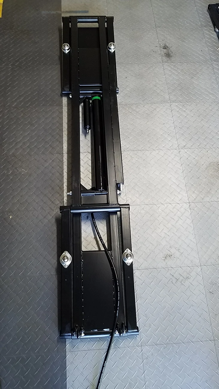

I also installed four roller balls to the bottom of the Quickjacks. You can just see the edge of one at the end of the red tag.
I beveled all the underside edges of the blocks to clear the corner welds in the trays.
Location of the roller balls. I drilled/tapped holes straight into the lower frame.

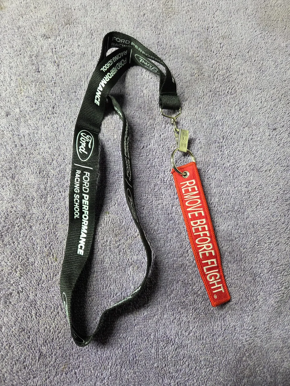

@bucketlist asked where I got the Remove Before Flight keychain tags.
If I just search "Remove before flight" on eBay, I get several seller hits. Here is a direct search link with results. A 3-pack is common. I suggest ordering two (for 6 total), which gives you 2 extra after putting them on your jack pads.
One can be a key chain, or whatever. I put one on a lanyard, and then I may hang it on my steering wheel as a "Don't forget" reminder to check something before starting or driving my car.
Note that the key rings didn't work with my Quickjack so well, so I modified the pucks such that the tags screw onto them directly. I updated the photo in my previous post. I know I saw eBay jack pads that already come with the RBF tags but I didn't see them in those results.
