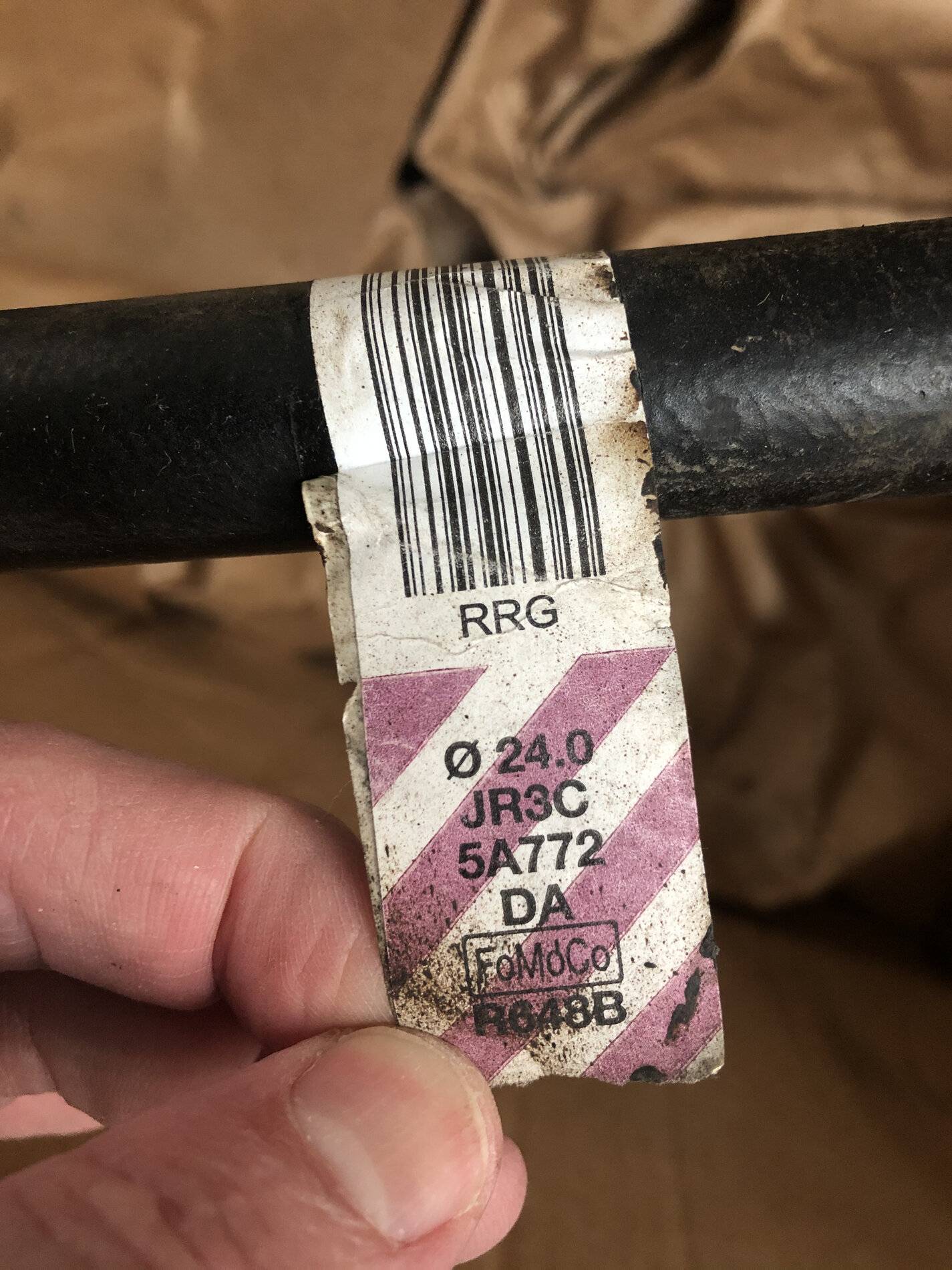

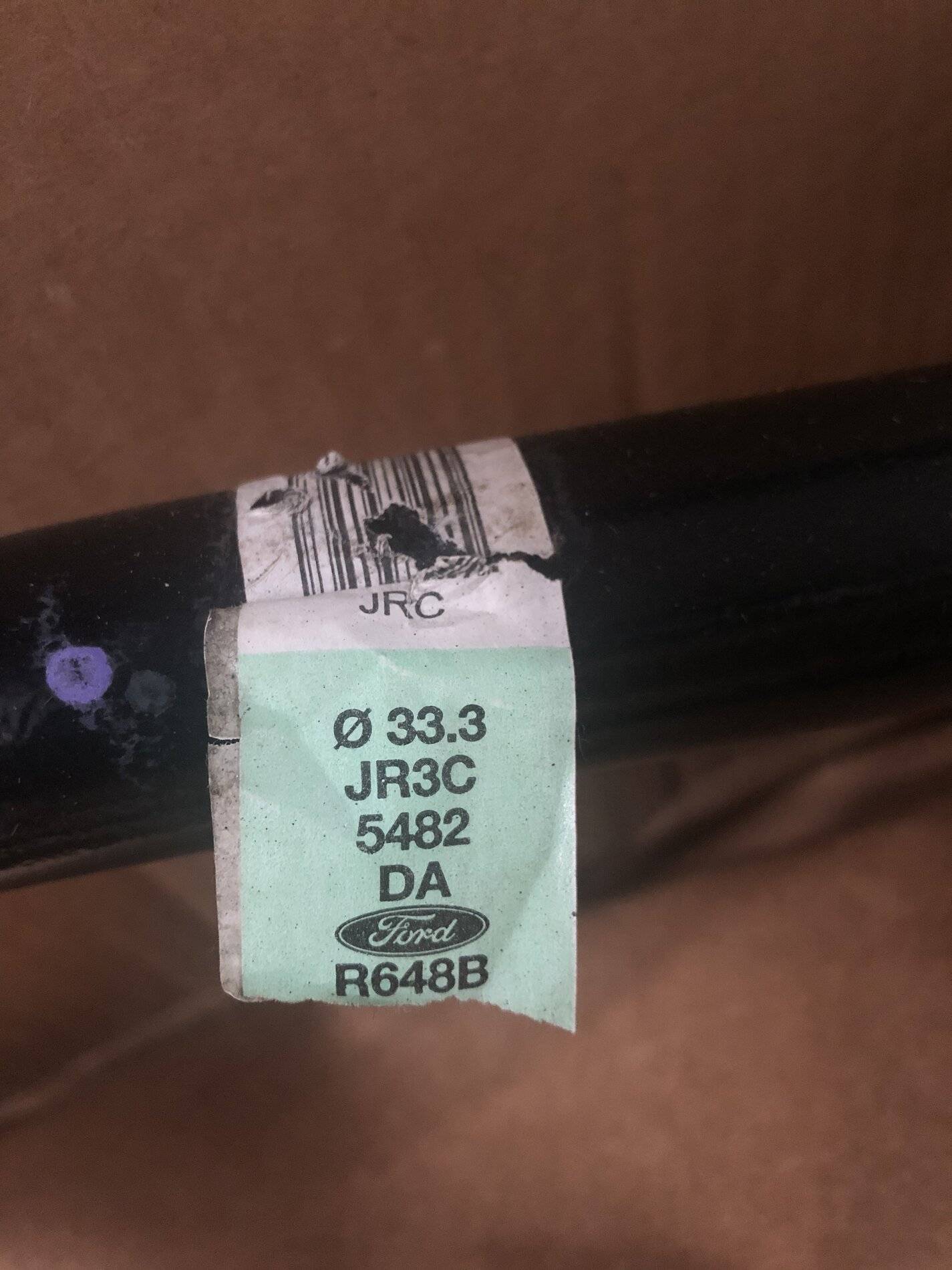

I’m installing PP2 sway bars this weekend and will check the end links again.
If you have caliper handy - would you mind measuring diameters of both bars ? I don't if I have seen those measured / posted anywhere.
Here you go...

Thanks ! Didn't have to measure even.
These have weirdly thick paint for some reason, but the OD agrees with the tags.
