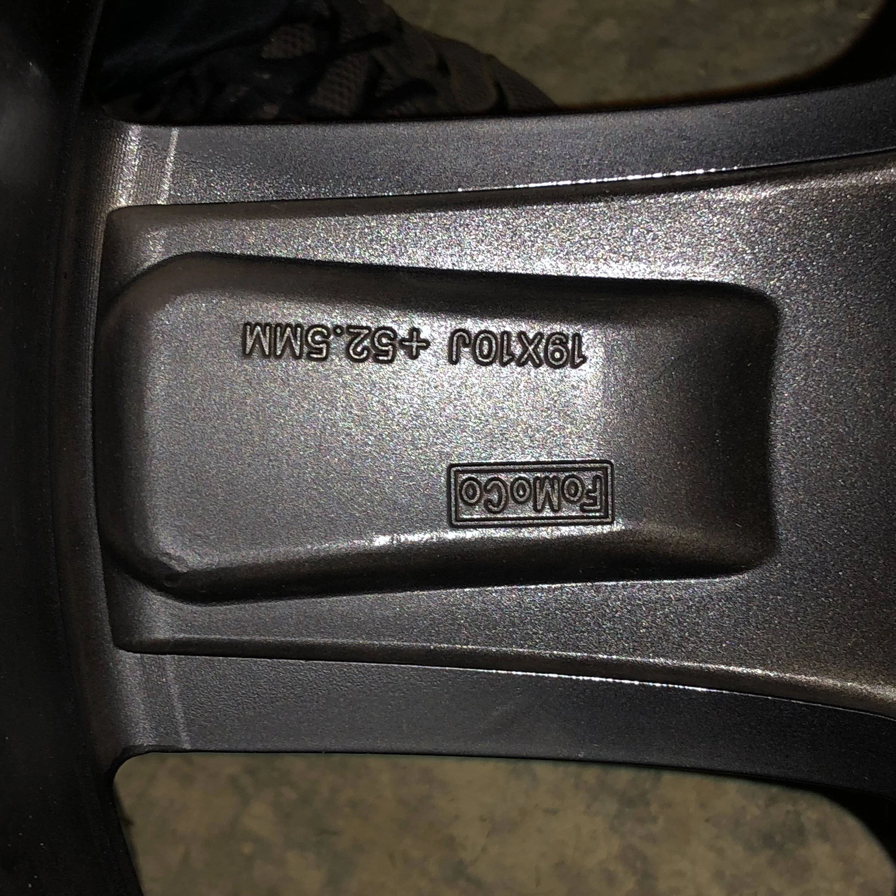

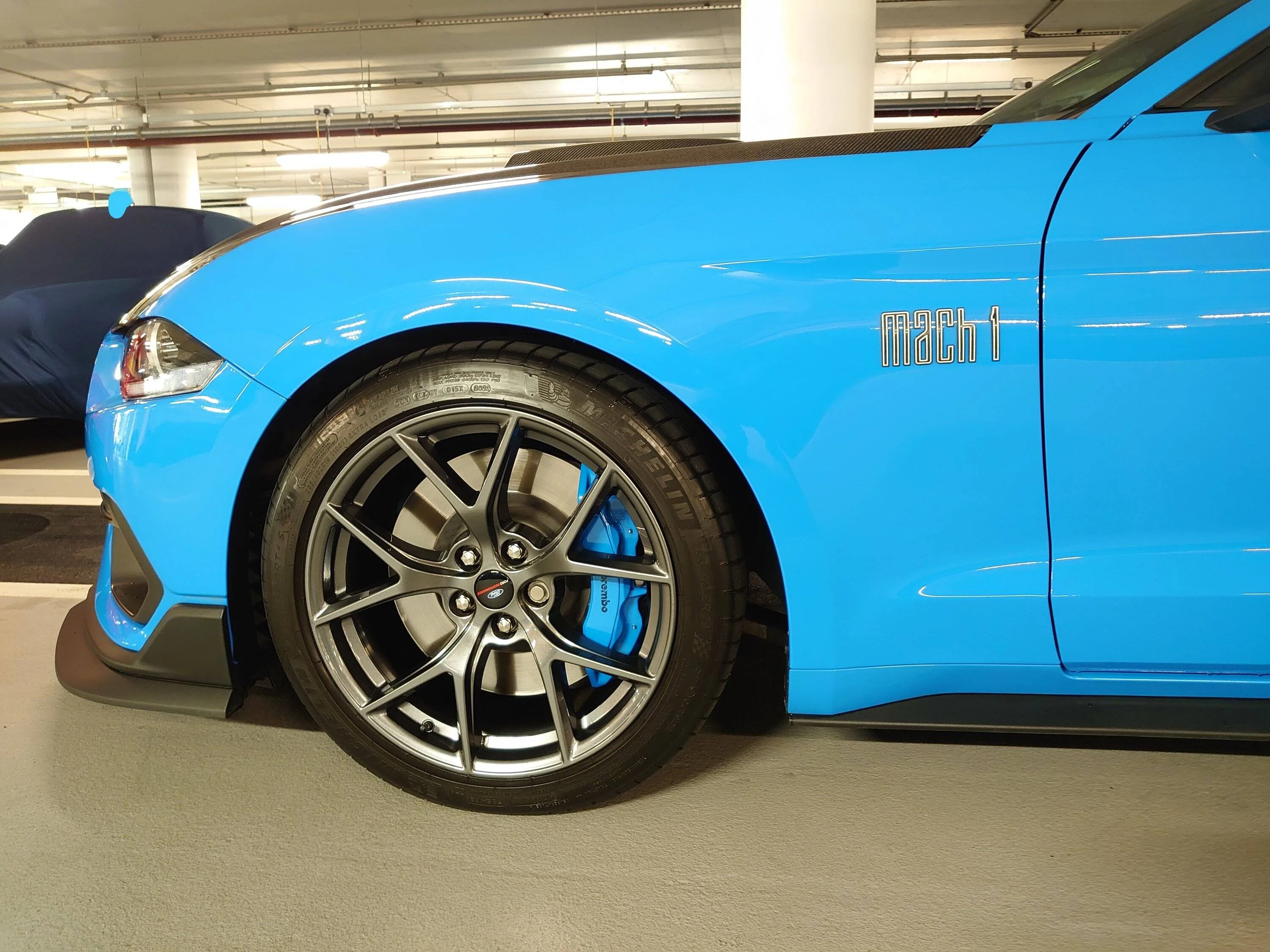

Yes, that's for these wheels below. I don't know the standard wheel offsets, sorry.

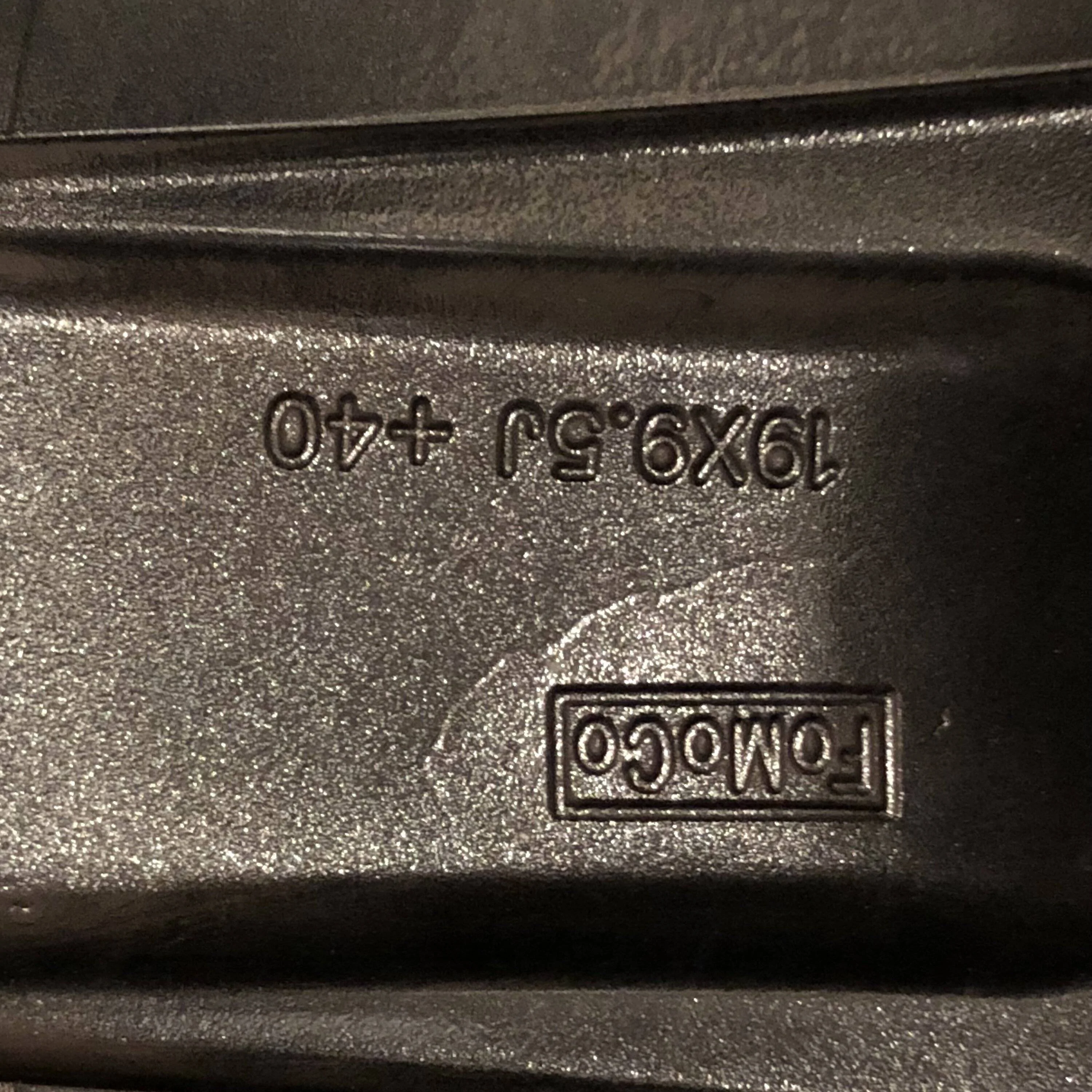

Base 5-spoke, Sorry for the upside down pictures…
WD Pro
Jan 18, 2018
132
6,823
13,674
United Kingdom
Lime GT
Well at least I flipped them over for you when I pinched them for that other thread linked above … :crackup:
