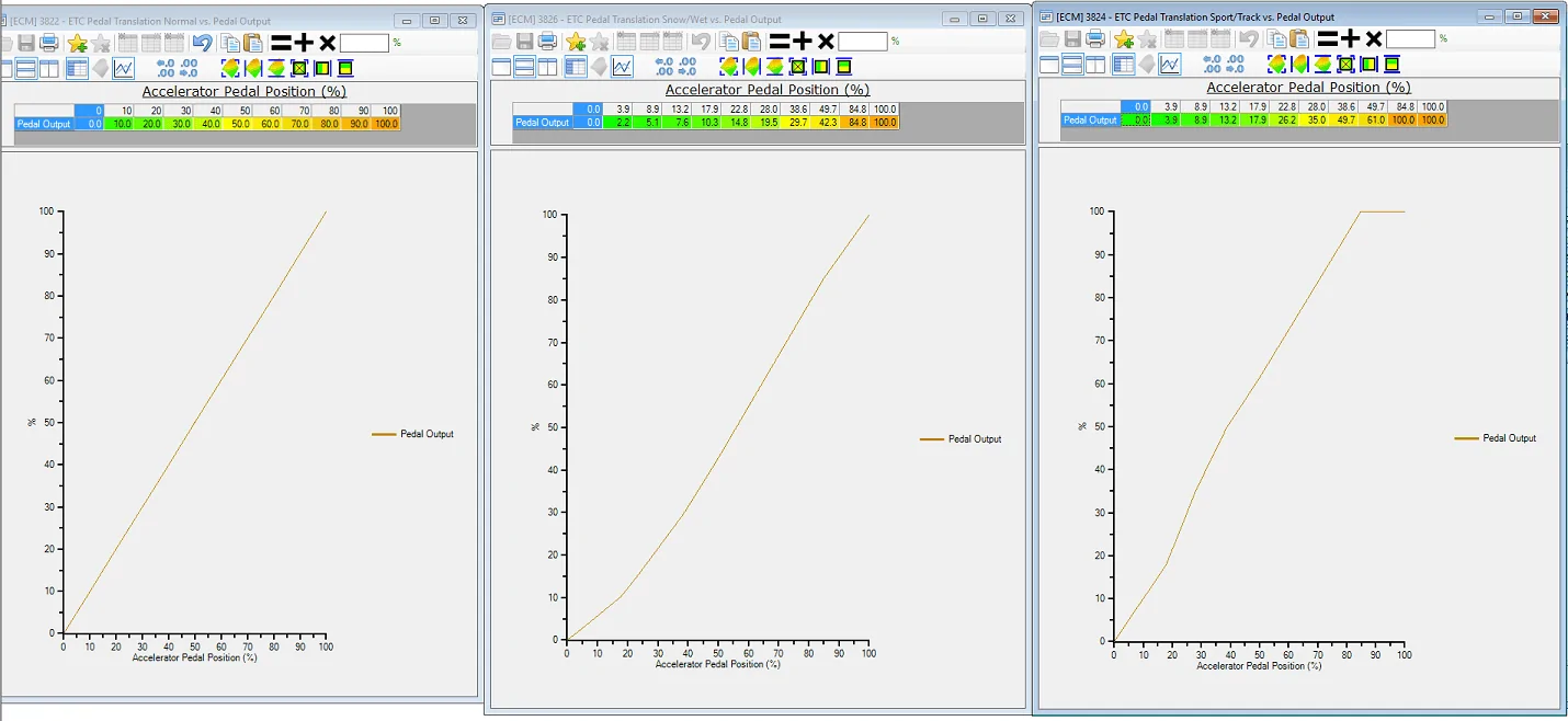

Here's how the throttle mapping looks. Left: Normal. Middle: Rain & Snow. Right: Sport+ and Race track.
On a M1 the throttle opening in track mode is linear so 50% pedal = 50% throttle (same as normal mode) - it's been done purposely by Ford in an attempt to keep the track guys smooth when applying power exiting a corner etc.
Those settings per drive mode can be altered by a tuner or using HP Tuners etc :like:
Note that none of these setting affect engine power, 100% pedal is 100% throttle is 100% power in any mode.
Does that help ?

That does help thank you, so its different to a Bullitt where it was notably sharper in track Mode. In Sports Plus, what do you think 50% pedal = ??% Throttle?
Yes, I believe sport and track use the same mapping in the Bullitt (like the GT).
So if you look at the graphs above and draw some lines on them, 50% pedal is approximately 60% throttle in sport and track on a GT and a Bullitt :like:
So in simplistic terms :
GT & Bullitt :
  • Tame throttle = wet mode.
  • Linear throttle = normal mode.
  • Aggressive throttle = sport and track modes.
Mach 1 :
  • Linear throttle = normal and track modes.
  • Aggressive throttle = sport mode.
