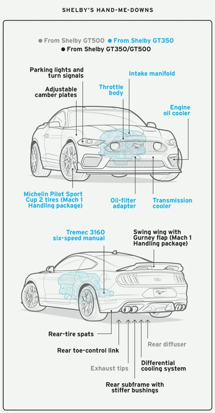

I bought my Mach 1 last week and was reading the forum about the Mach 1 being a parts car so I started researching. This is what I have found, these are from supposedly experts but they are still human. Are they right? Add or subtract, I would like to build a list of this:
BULLITT
Engine – Modified Bullitt Engine
SHELBY GT350
Air Intake
Brakes
Intake Manifold
Oil Cooling System
Oil-Filter Adapter
Stiffer Bushings In Front And Rear Subframe
Differential Cooler
Tow Link
Incandescent Park/Turn Lamps
Tremec Six-Speed Manual Transmission
SHELBY GT500
Rear Tire Spats
Rear Axle Cooling System
Rear Toe Link
Rear Diffuser

Then this chart is off saying Mach 1 has GT500 exhaust tips
BlkMach10510
BlkMach10510
Mar 9, 2023
40
1,317
2,387
2023 Mach 1 10R80
So ford is saying unique 4.5 and other "experts" in the field are saying GT500, not anyone on this thread.

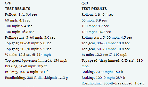

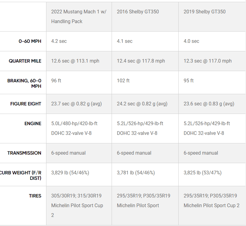

Initially I had the same feeling, but it appears in testing atleast that the M1 or GT PERF PKG 2 had better or near matching stopping distances when compared to GT350. The issue here isn't so much about brake components ect, its traction limited by the tires. Plus the numbers move around quite a bit as tire condition, temps, and surface friction come into play, lots of variables.
I think I saw a thread of someone swapping the rears out for the Shelby parts, not sure on that.
https://www.motortrend.com/features/ford-mustang-mach-1-shelby-gt350-gt500-test-data/
https://www.caranddriver.com/review...ck-level-2-vs-2019-ford-mustang-shelby-gt350/
2019 Perf pkg2 vs 2019 GT350

I think it's really more about repeated/sustained usage. The GT350 brakes are better suited for reducing rotational mass, and dissipating the heat from hard repeated braking. The one time "how fast can we stop this pig" metric is great for say an emergency stop on the highway, but the Performance pack brakes show their weakness when you get them hot, and I imagine the handling of the MACH 1 would also slightly improve with the lighter 2 piece rotors.
