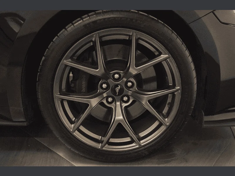

I was wonder the exact Opposite before I order a extra of Mach 1HP wheels for my HP Mach 1.if aftermarket GT350 fit a moch 1 HP 19āby 11ā front didnāt want to go down to a 19ā by 10ā in front with a 285/35r19

I really just what something different or lighter wheels that wouldnāt break the bank and could of kept my 305/315 r 19 tire sizes. All the other S550 wheels are 10ā wide for the front and isnāt big enough for 305
So u think the 19 by 11ā & 24mm offset will
Fit the Mach 1 handing package.
