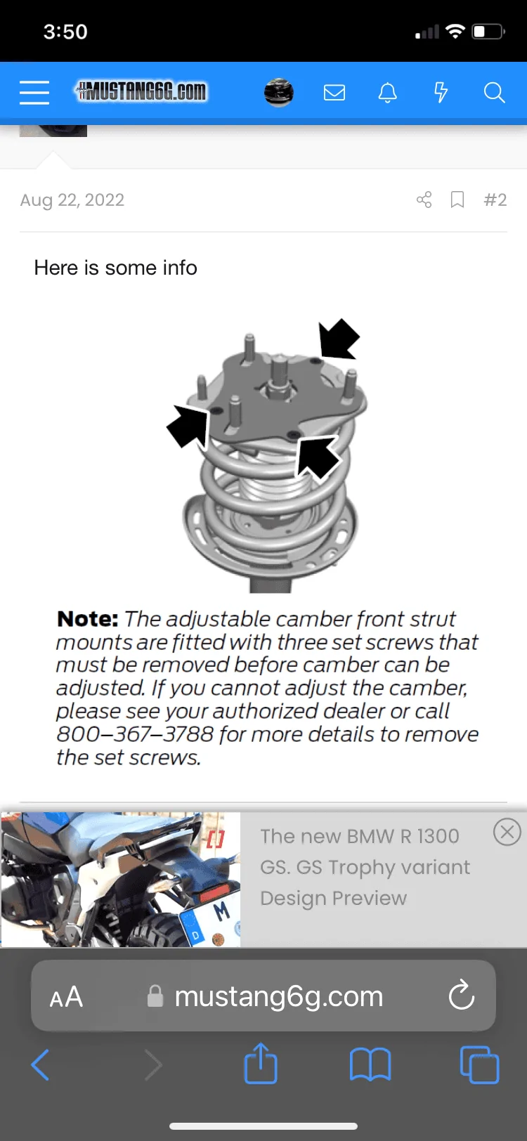

Forgive my ignorance, but I have a question regarding the adjustable camber plates by Ford performance,
If anybody is aware of the three set lock pins on the camber plates, I understand that you are supposed to remove them before you install and set your camber adjustment but my question is do you have to reinstall the lock pins or are they just there set from factory?

You wouldn't be able to put the locating screws back in, as the holes won't line up after you shift the plates
