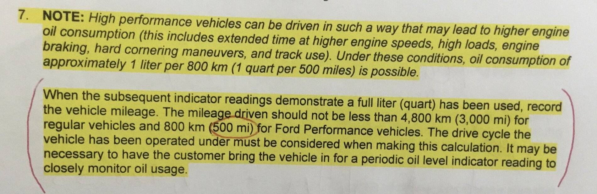

Have you done an oil change yet? Either way I would get the dealer to document it ASAP just so you’re covered. I know Ford has acceptable levels of oil consumption but their limits are way higher than I would ever be comfortable with.

All that means...is now you can burn one quart of oil every 500 miles (instead of the non-performance 1,000) and they won’t do a thing for ya 😂

I think those comments were for serious track use with sustained RPMS up near redline. Unlikely, but Ford is trying to cover the bases. BTW, with my Bullitt I changed the first time at 1,000 miles, 500 of which were very gentle and 500 of which were heavy throttle.

I just got off the phone with a very nice guy at the Ford performance Track Attack facility.
I asked him specifically if the Mach 1 is a "Ford Performance" vehicle because there has been confusion on this. He said positively it is or it would not be in the Track Attack program. ...
