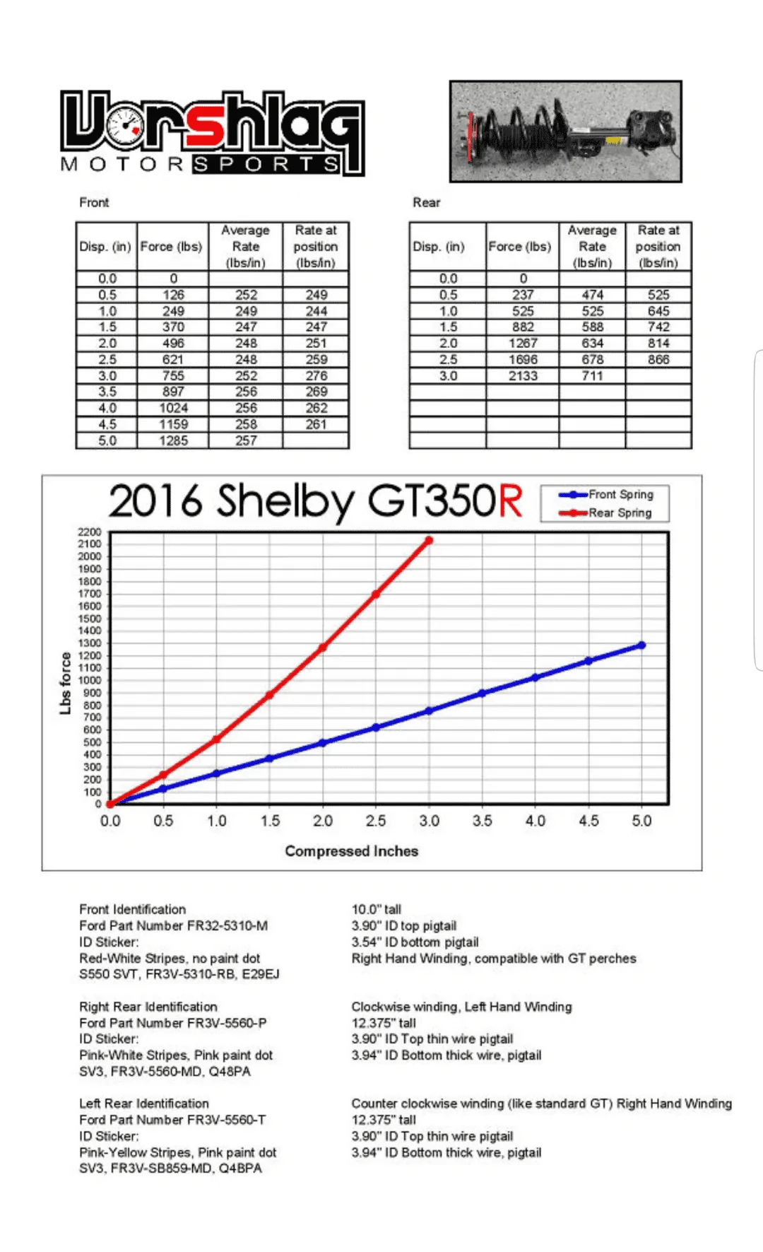

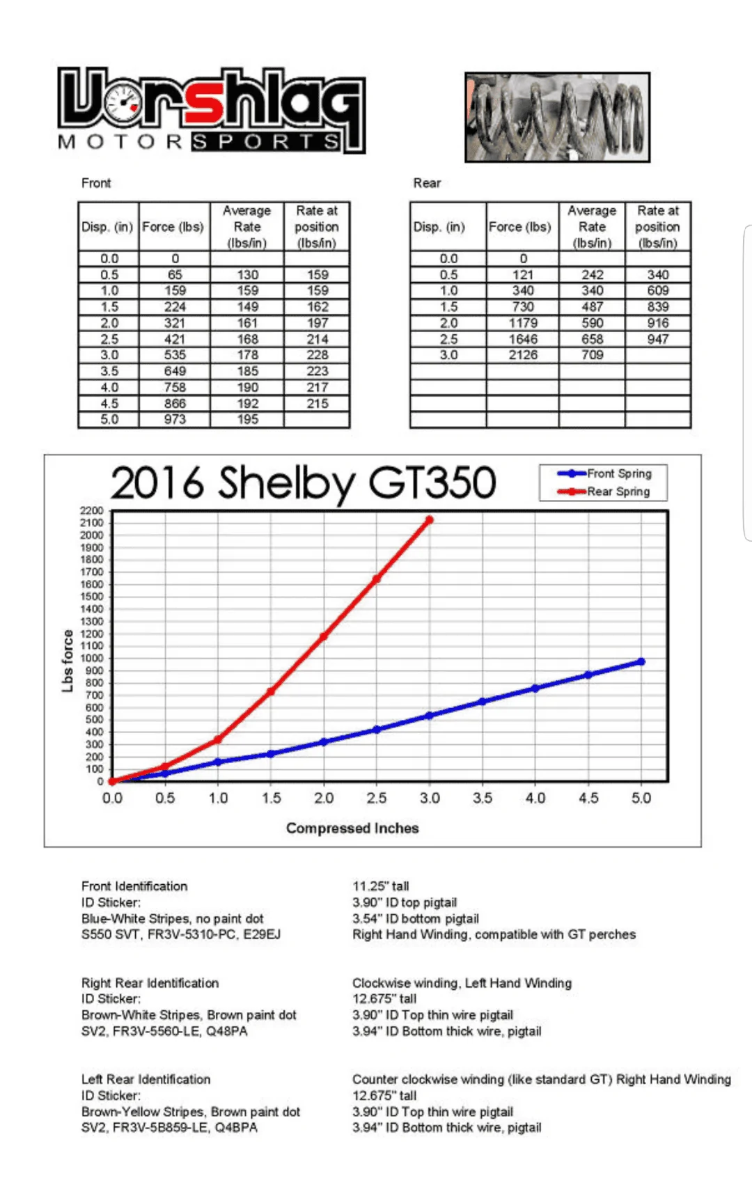

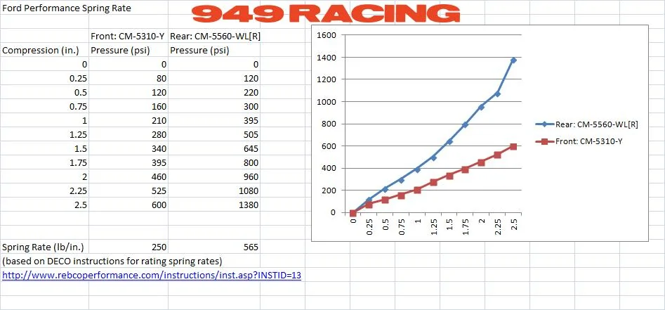

You guys comparing the force column in the Vorshlag results to the 949 results? What are impressions/rationale of the FP rears being softer combined with their differing design? I wonder if the softer FP springs are engineered to complement the presumably stiffer FP bars that were just released?

Out of curiosity, why an inch? The tables don't to me suggest anything is falling off prematurely or acting anything other than as desired. I suppose it makes sense that the R front springs are stiffer, and the softer FP springs may have been intended as replacements for the GT350 springs rather than the R type. But I can't see anything in the data itself.
Like many people here, I picked up 30 series tires, 'R' springs, splitter and wing. So I'm looking for numbers to validate my pre-existing decisions.

The reason I'm curious about these rates is I'm contemplating which set up I will go with for next year, and there are a few choices. My goal is to avoid lowering the car if I don't sacrifice performance. I could go with R springs and rear R bar; I could go with R springs and the new FP bars; or I could go with FP springs and bars.
My anecdotal thought is the FP bars are designed to complement their springs. At first glance it seems the R springs and FP bars are a good option to avoid lowering, but I wonder if performance will be sacrificed? With the notably different rates, particularly in the rear, I question the right option to take. Any of the tech gurus have an opinion on this?
