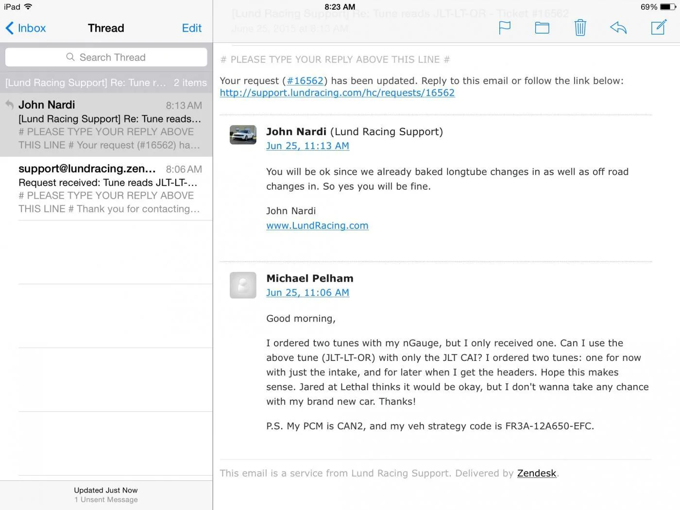

So I received my nGauge, but it looks like there's only one tune under custom files. It reads JLT-LT-OR, which I believe is my secondary tune I asked for (future use when I get long tubes). My primary tune should just be for the JLT. Am I missing something?

Nuff said. Big thanks to Jared at Lethal and Lund. Now to go install :headbang:
