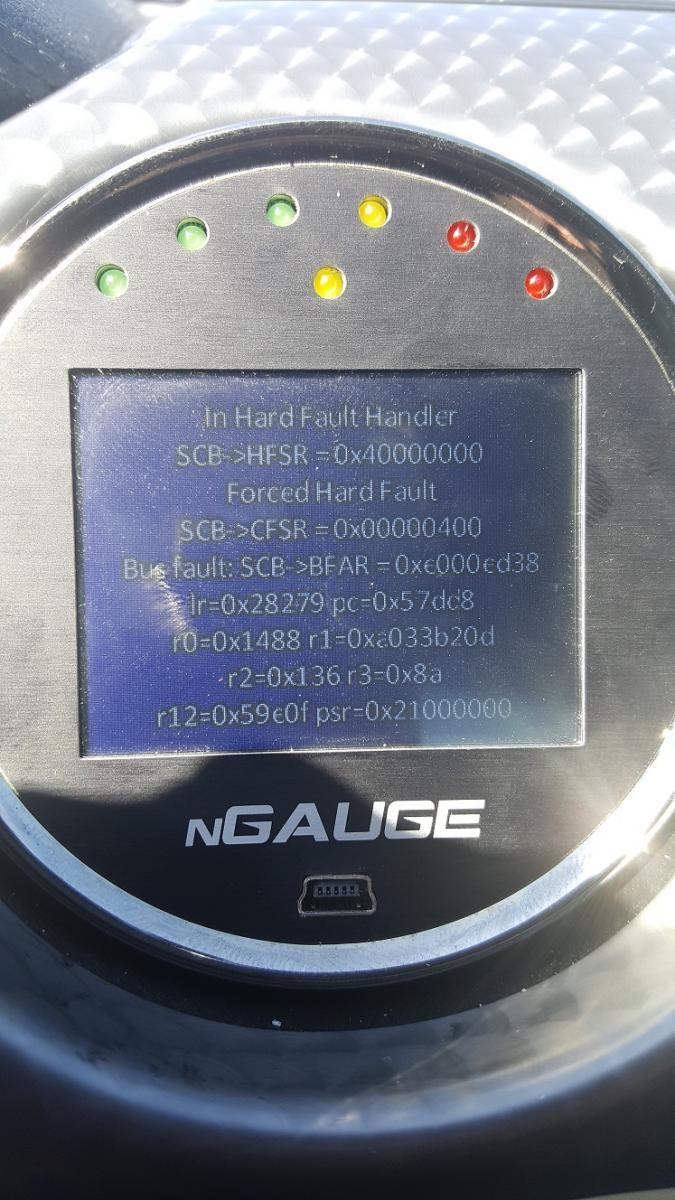

So, I have successfully completed my Procharger stage II and OPG install. OGP was a PITA but the charger was not so bad. Still waiting on tune from Lund but had some issues with the ngauge during my first set of logs and wondered if anyone has had this issue. The gauge threw a forced hard fault (pic attached) and turned off a few times during dataloging. Later in the day it was working normal. Installed in blocked off ac vent. Heat maybe?

Heat for sure. Update to latest firmware to fix. I RMAd my first gauge as it was doing the same thing, was actually pretty bad ass to see a BSOD when I was driving and explaining the gauge to my dad. They wanted to test with it and sent me a new one.
Generally if it's extremely hot in the car to where your breathing habits change don't turn the gauge on until the air has ran full blast for 3-5 mins. Or move your car to a cool area

Thats what I was thinking. Latest firm has been installed. Guess its is the cost of doing business in south Florida.

Texas here, you may want to log a case with Lund anyways. They will take care of you. Once I found the workaround I just offered to help them troubleshoot and it wasn't a big deal.
