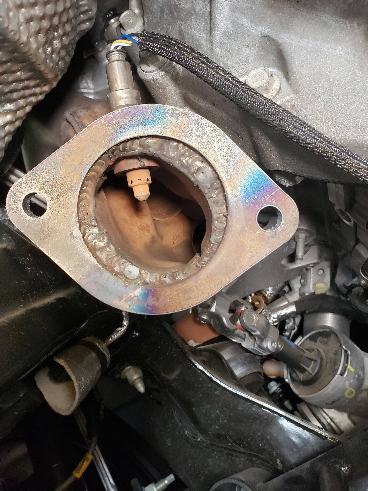

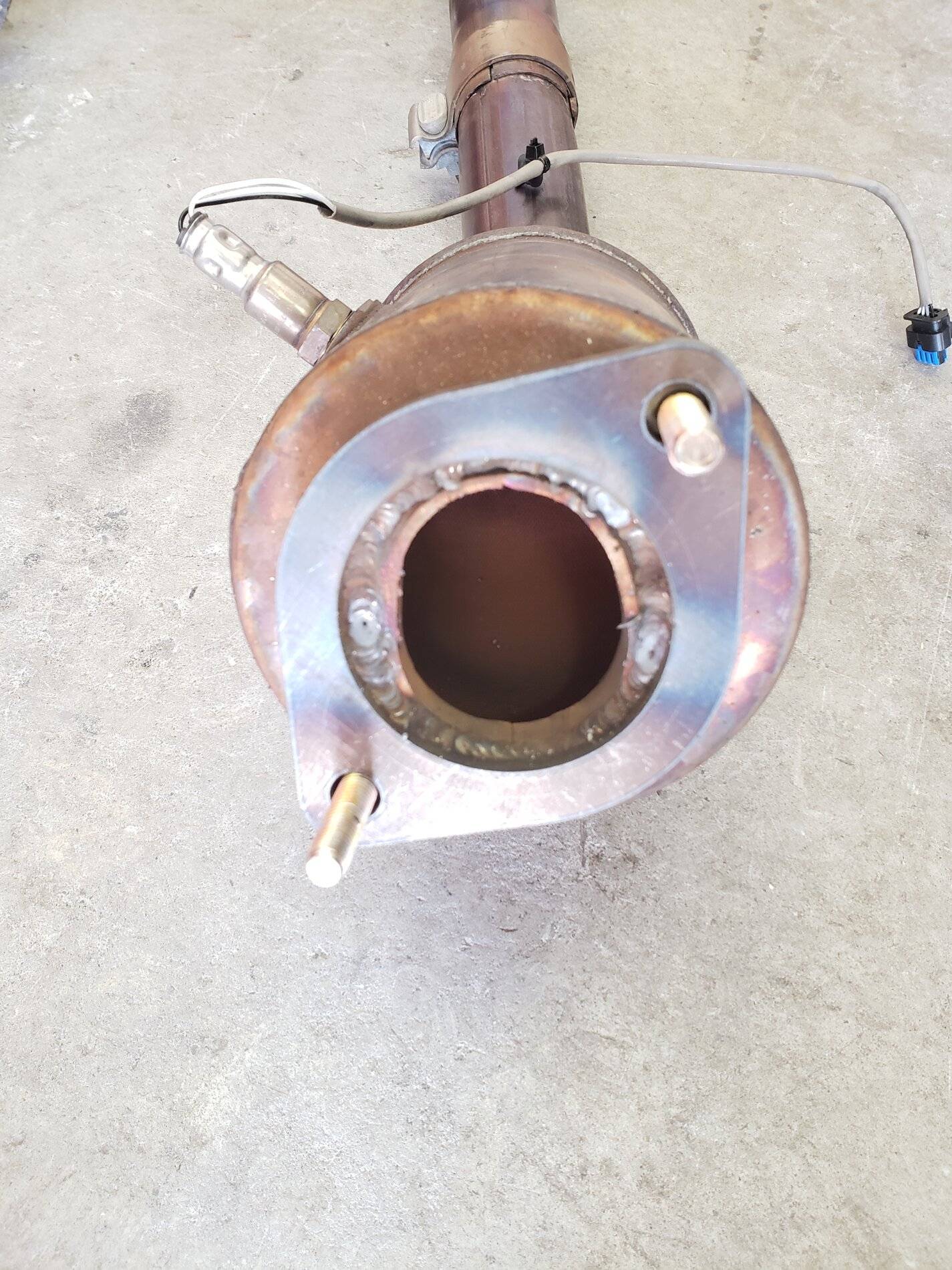

Cat delete and flange welded onto the OEM cat for re-installation later. Not as much HP as LTH, but the next best thing. OEM cat re-installation is simple.
