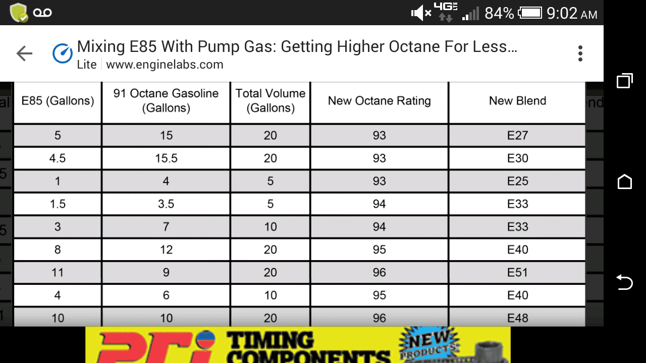

I also have concerns about octane boost additives. I came across this mixed fuel chart...
Will mixed fuel vs fuel additives reduce your concerns about ecoboom?

we can't just run e85 right. i can search on that.

I run 93 gas with factory tune. but I've talked to a few people who have ran E30 and E85... And have been told you can run E30 with a tune, but E85 requires both a tune and mods. But I don't have any direct experience (except for E15 in my 2.0 Fusion), and also would appreciate more information! Thanks!!
