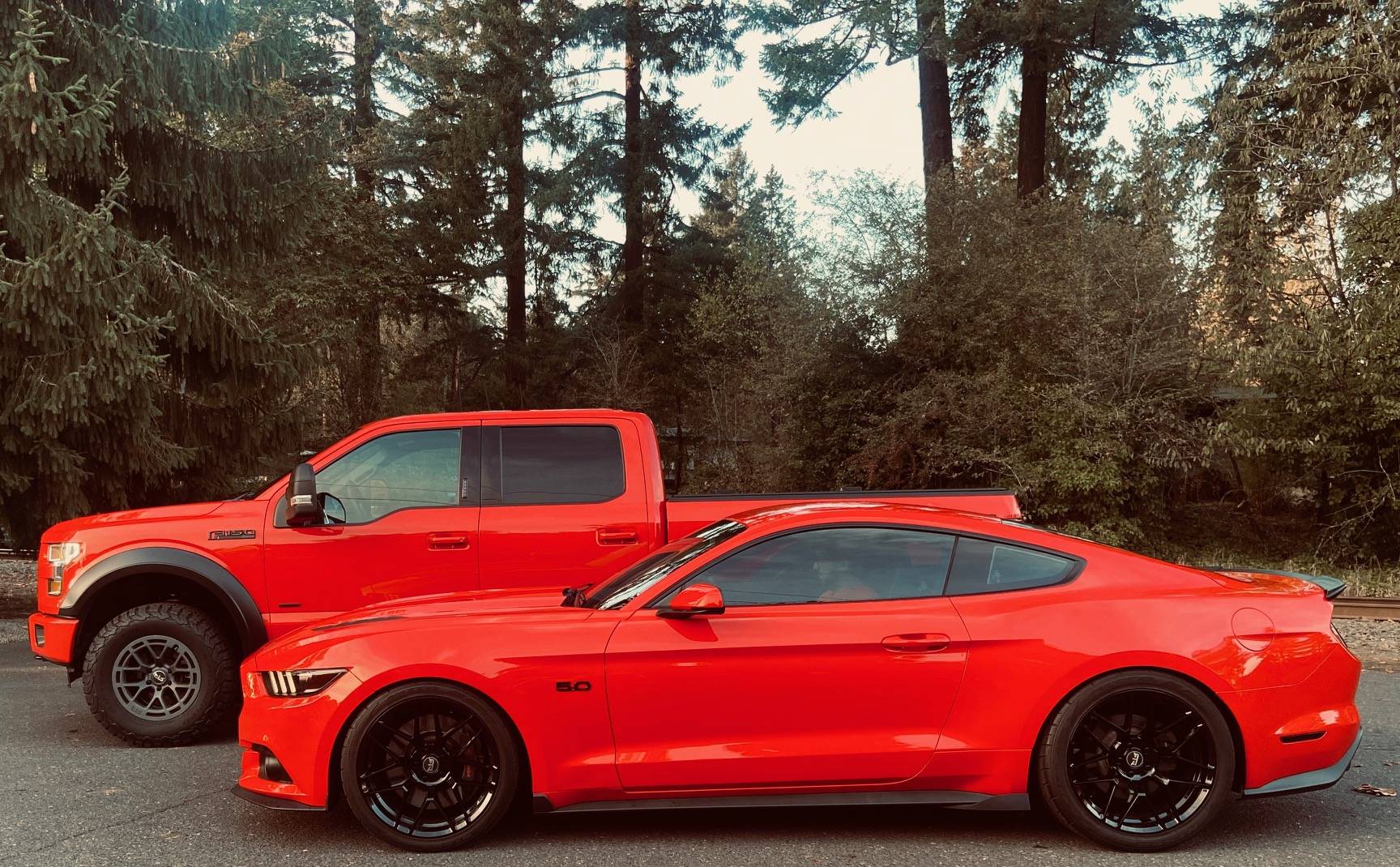

I did the Ford Performance X-springs on my PP1 and am quite pleased with the results.
What are your tire sizes? I just ordered some new Vossen wheels 20x9.5 +25 front and 20x10.5 +45 rear and going to be doing the Ford X-Springs when I get the wheels installed? The stance on your car looks perfect! Thanks!

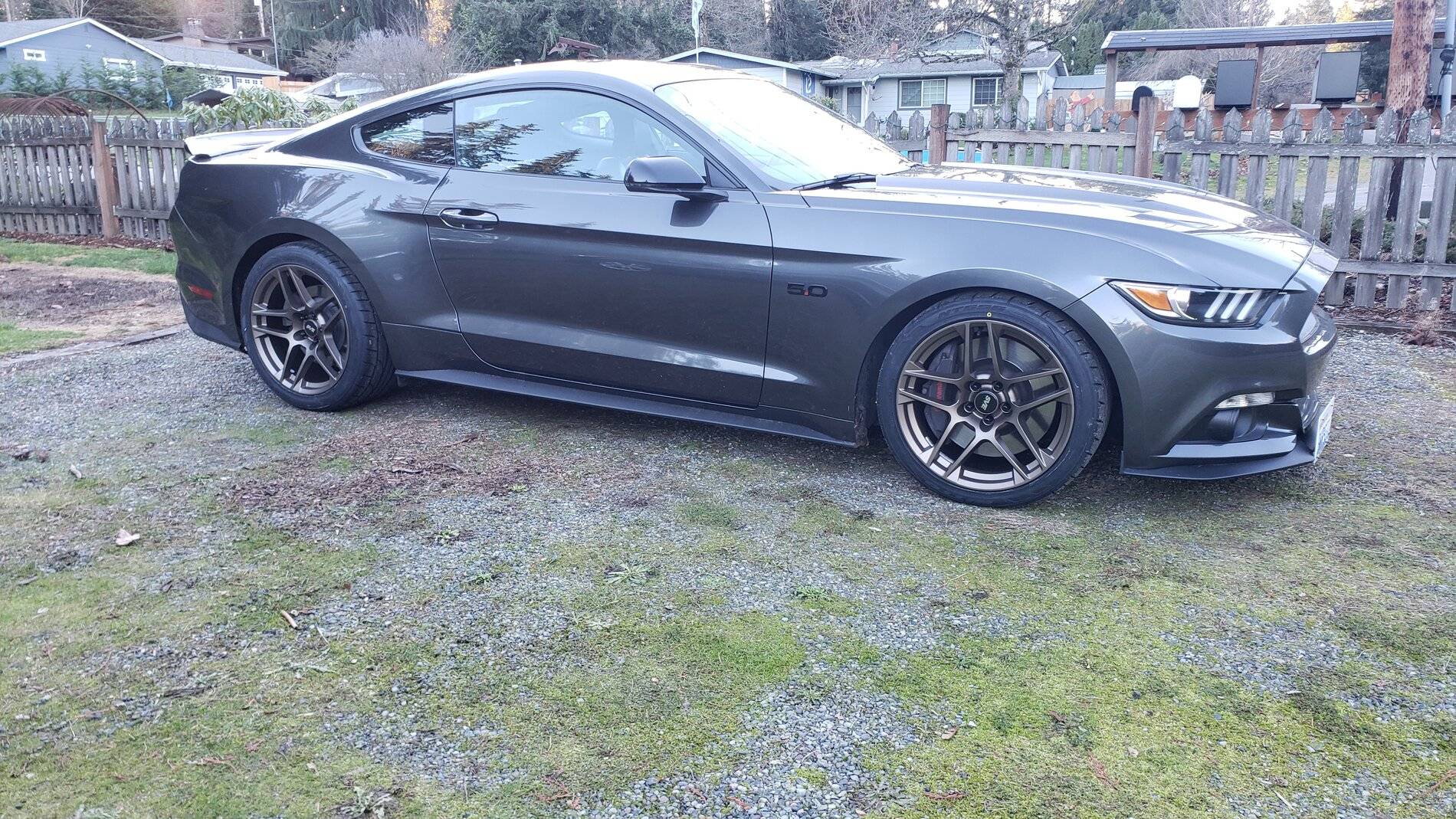

Another Ford Performance X-springs vote here, I'm running 19x10, 19x11 SVE X500 wheels. The X-springs don't really seem to be any harder than the OEM PP1 springs, and look much better in terms of wheel gap.
I've got a staggered setup on my car, so the tire sizes are as follows:
Front: 275/35/20
Rear: 305/35/20
The previous owner of my car installed these right before I purchased it and can honestly say I wouldn't have chosen anything different.
As far as the springs, I installed those around a year into my ownership. My experience with them is similar to Riley's where I did not notice a difference in ride quality between the x springs and my PP1 springs. I can't speak for any other brand of spring because I haven't tried them, but there was a peace of mind factor for me getting a product from the OEM.
