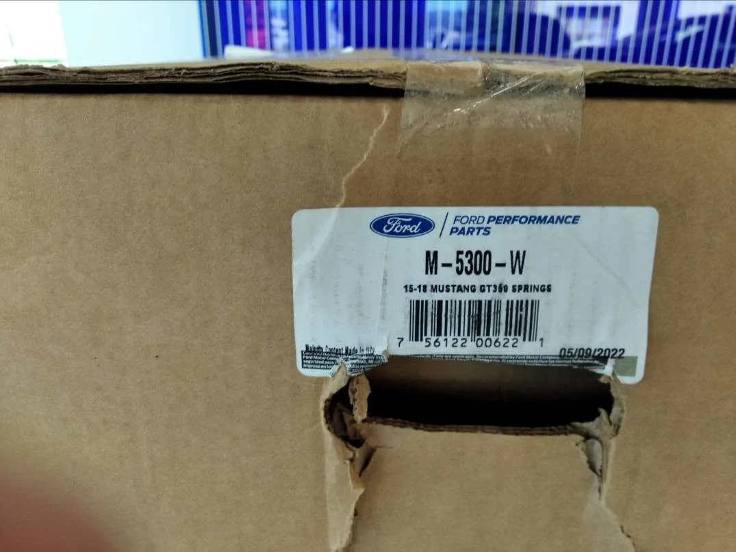

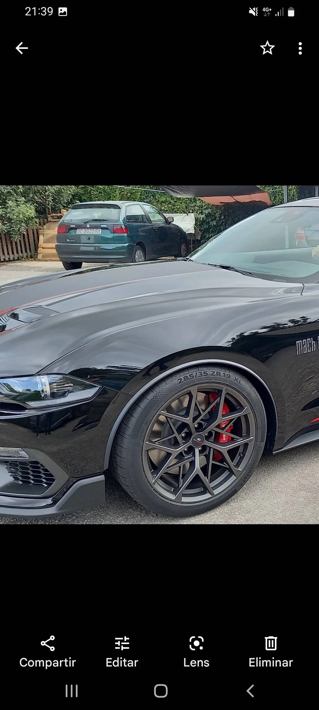

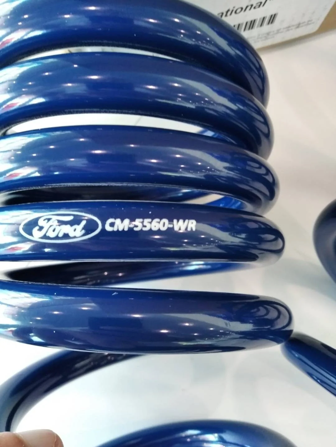

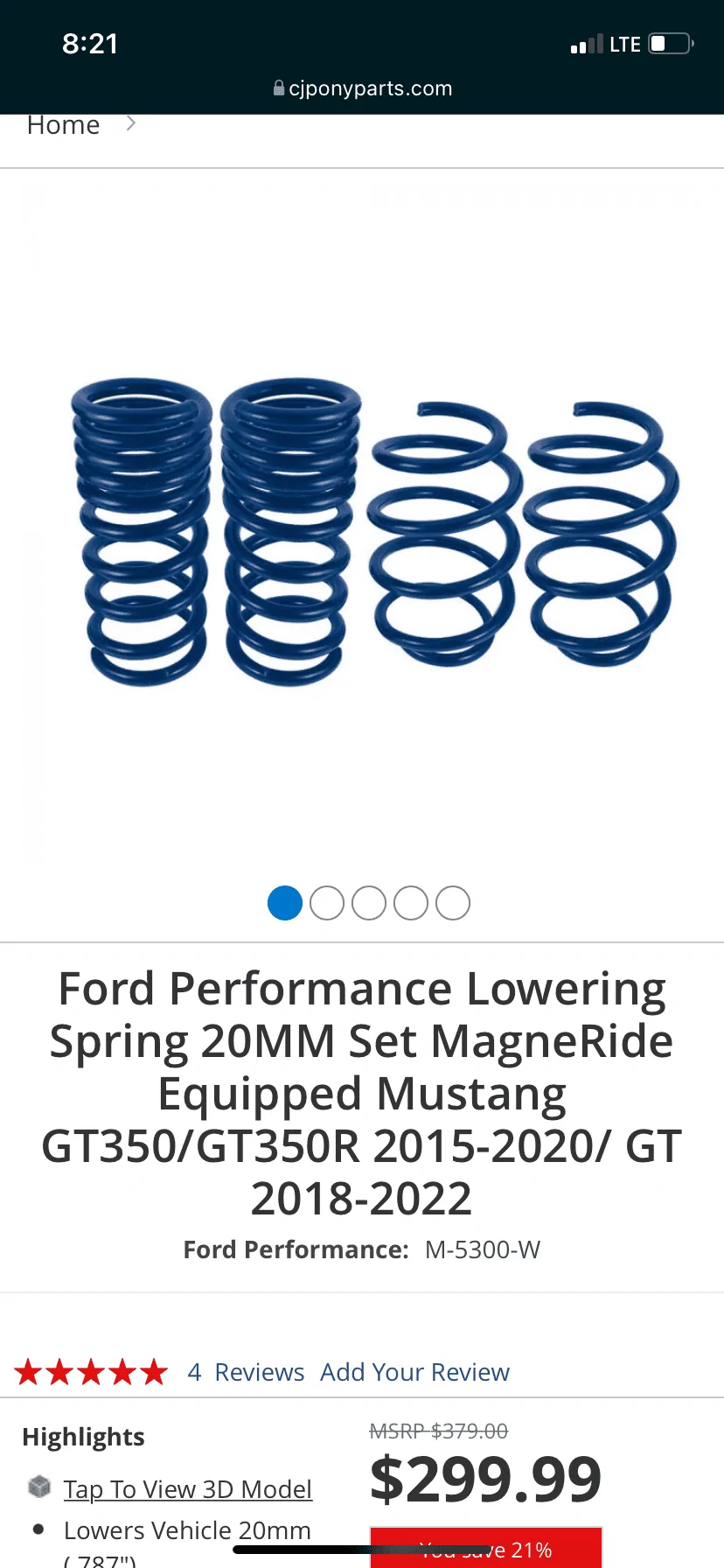

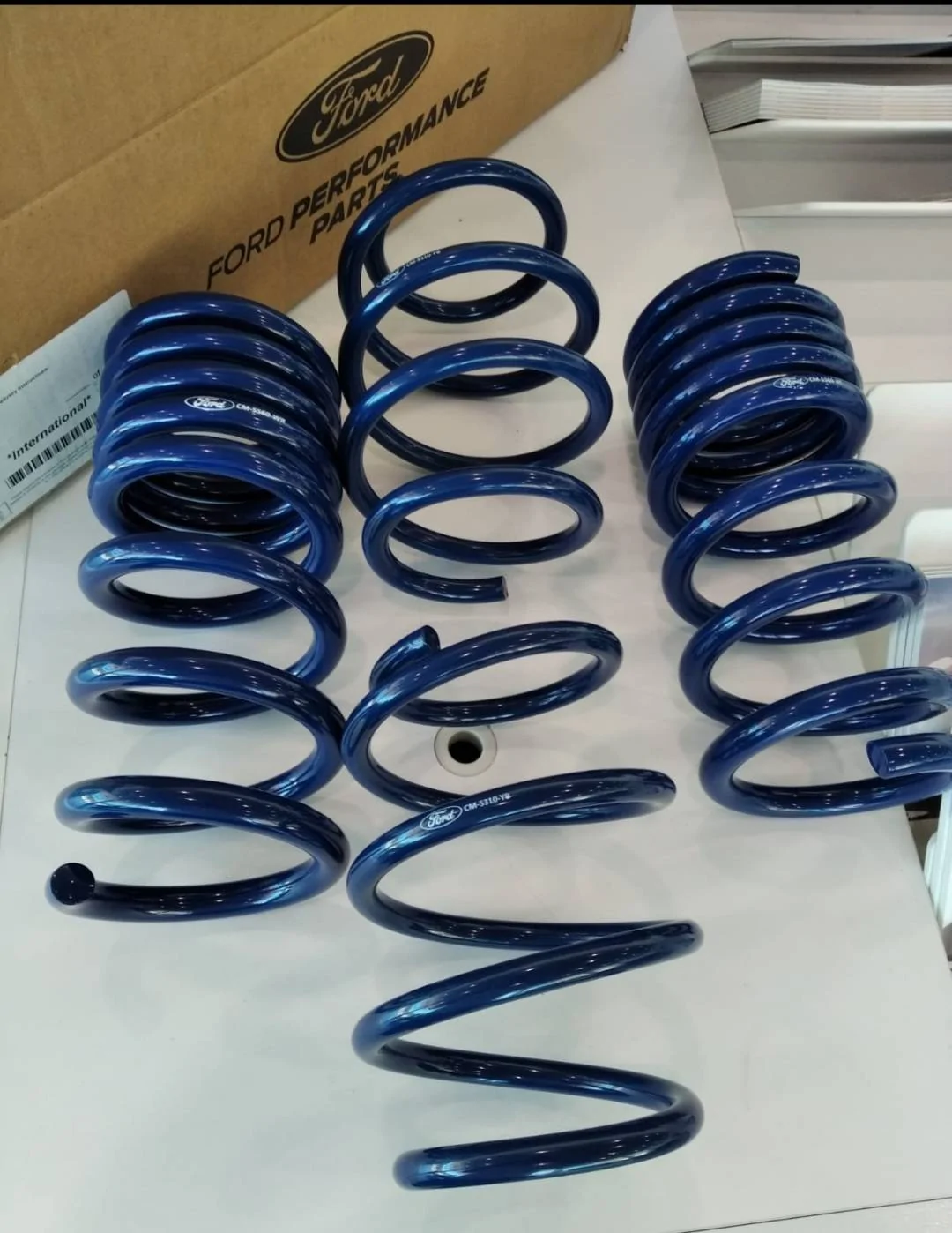

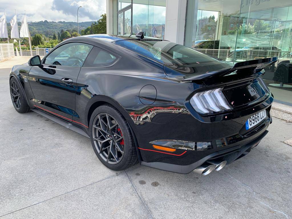

Hello, this is my experience. I placed these Ford Performance M 5300 W springs in my Mustang Mach1 2022 (magneride) and the stance is very aggressive and despite not having friction or problems, I see a greater drop in the front compared to the rear...
I've contacted CJ pony parts because the reference numbers you see in the photos are different, I don't know if they're right....I'm confused! I'm afraid that I made a mistake and broke something! Help

This is my apparence
