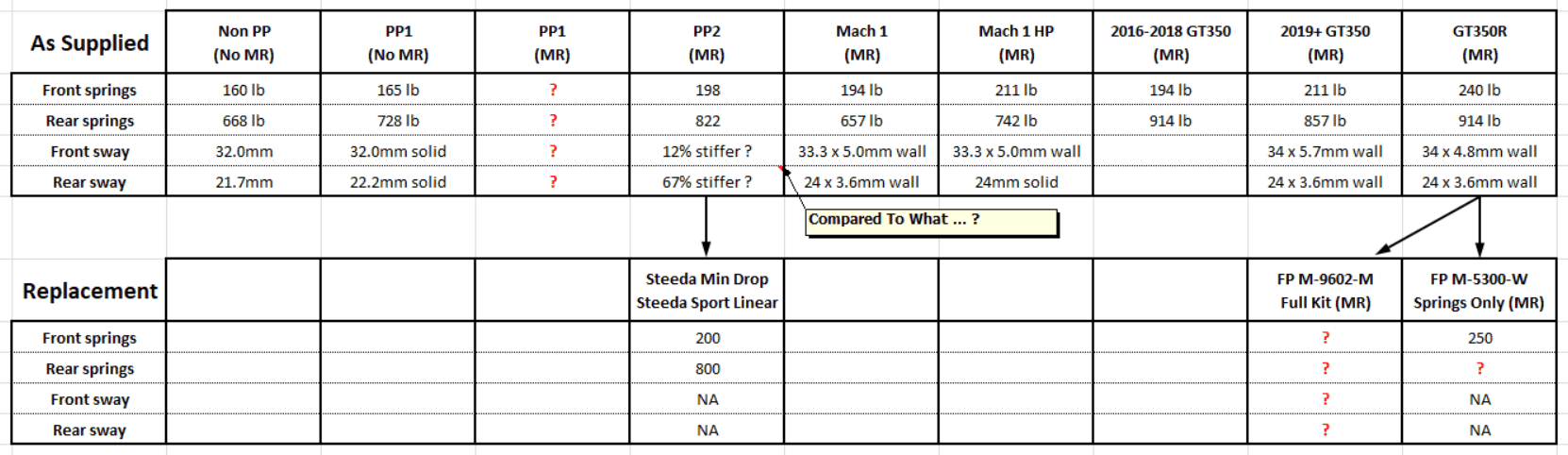

I'm pretty sure the M-5300-W is what's currently on the PP2 cars...
WD Pro
Jan 18, 2018
132
6,810
13,651
United Kingdom
Lime GT
I’ve been working on this from info I’ve come across on here and the net - I think the ‘W’ fronts are stiffer than the PP2 :

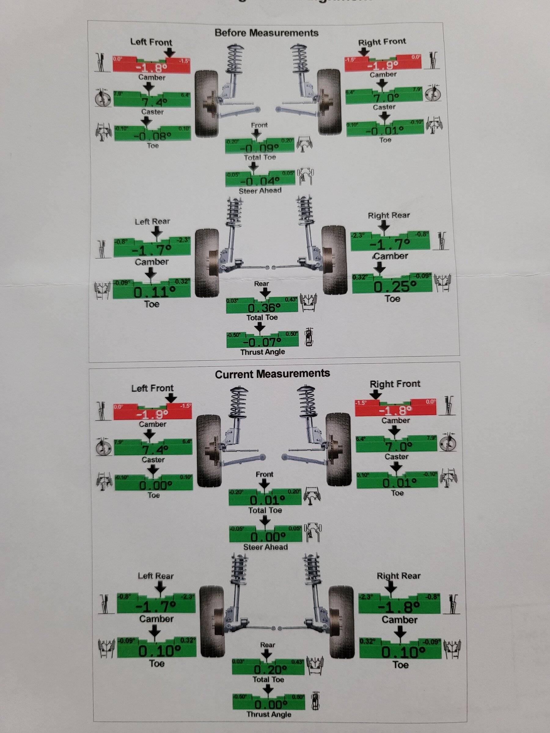

Hey Colin. I bought the ford performance lowering springs, dropped about .75" from CJPony. I have the 2020 PP2. and the springs made a huge difference.
quikcolin
quikcolin
Nov 13, 2020
150
277
Canada
Colin
2020 Mustang GT PP2
Hey Colin. I bought the ford performance lowering springs, the same springs on the gt350. dropped about .75" from CJPony. I have the 2020 PP2. and the springs made a huge difference.
Thanks so much, great to hear from another PP2 owner on the subject. Question, does the car sit perfectly level. Meaning the front isn’t lower than the rear? Gapping is the same?
To confirm, we’re the springs the following: Ford Performace M-5300-W?
I’m assuming you had an alignment? Did you have to adjust camber? If so, did you add camber plates? Or bolts?
