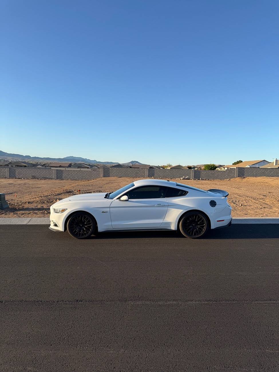

2015 Mustang GT 50th Anniversary
Decided to lower my car with Steeda Progressive Lowering Springs and Pro Active Struts/Shocks
Is anybody else running this setup?
Is there anything else I’ll need?
I don’t believe I have a place in town that’s able to align with camber/caster plates/bolts.
Any info appreciated!
