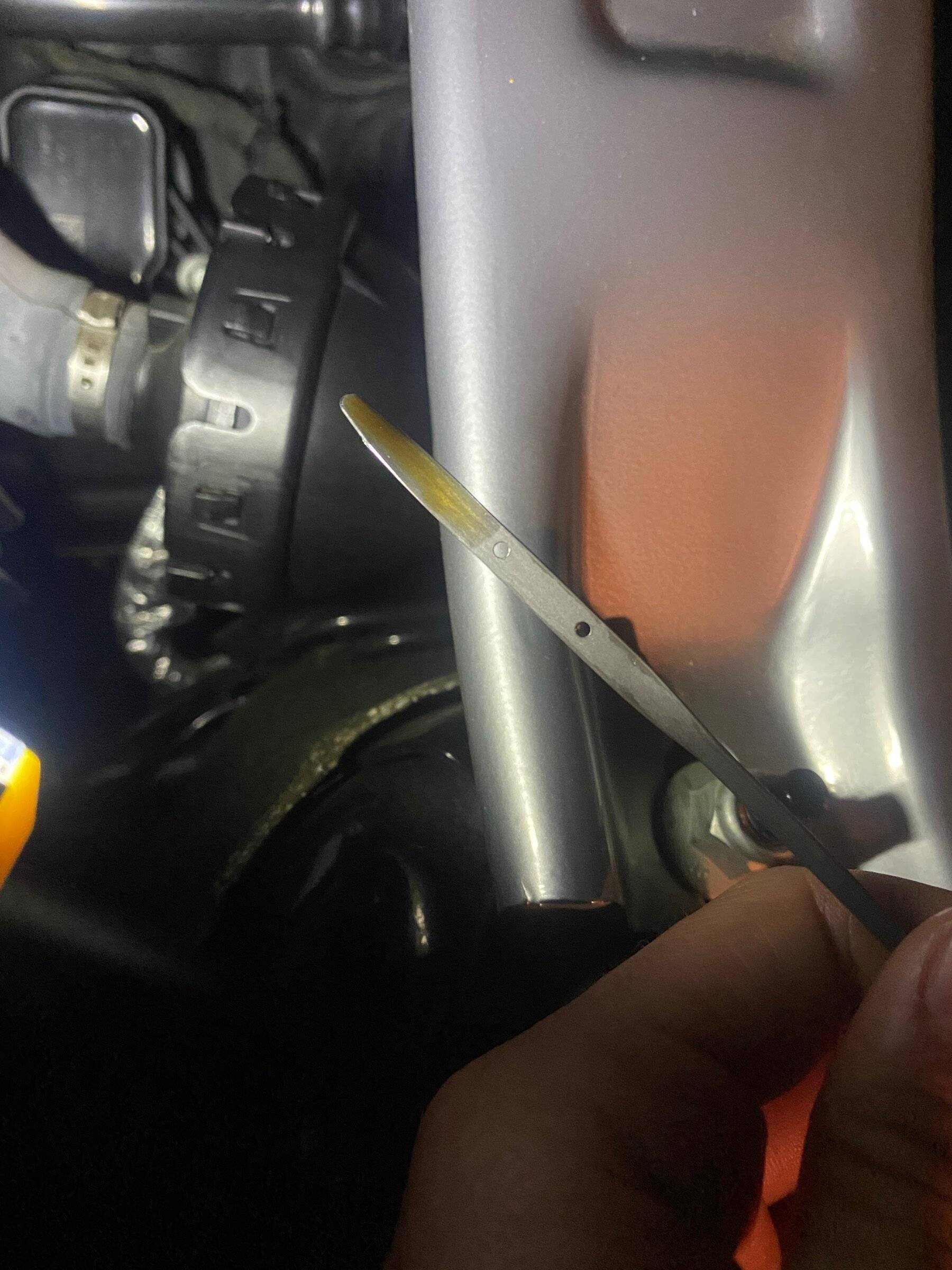

Checked my motor oil today (on a level surface, car sat and is still warm) what a disappointment its low.
Any ideas? Do new cars just burn or soak up oil or something? Is it mustangs specifially?
Been doing oil changes for the last 10 years and 10 quarts is hard to mess up ...so safe to say I poured 10. Last time was when I bought the car which was around 2k miles ago.

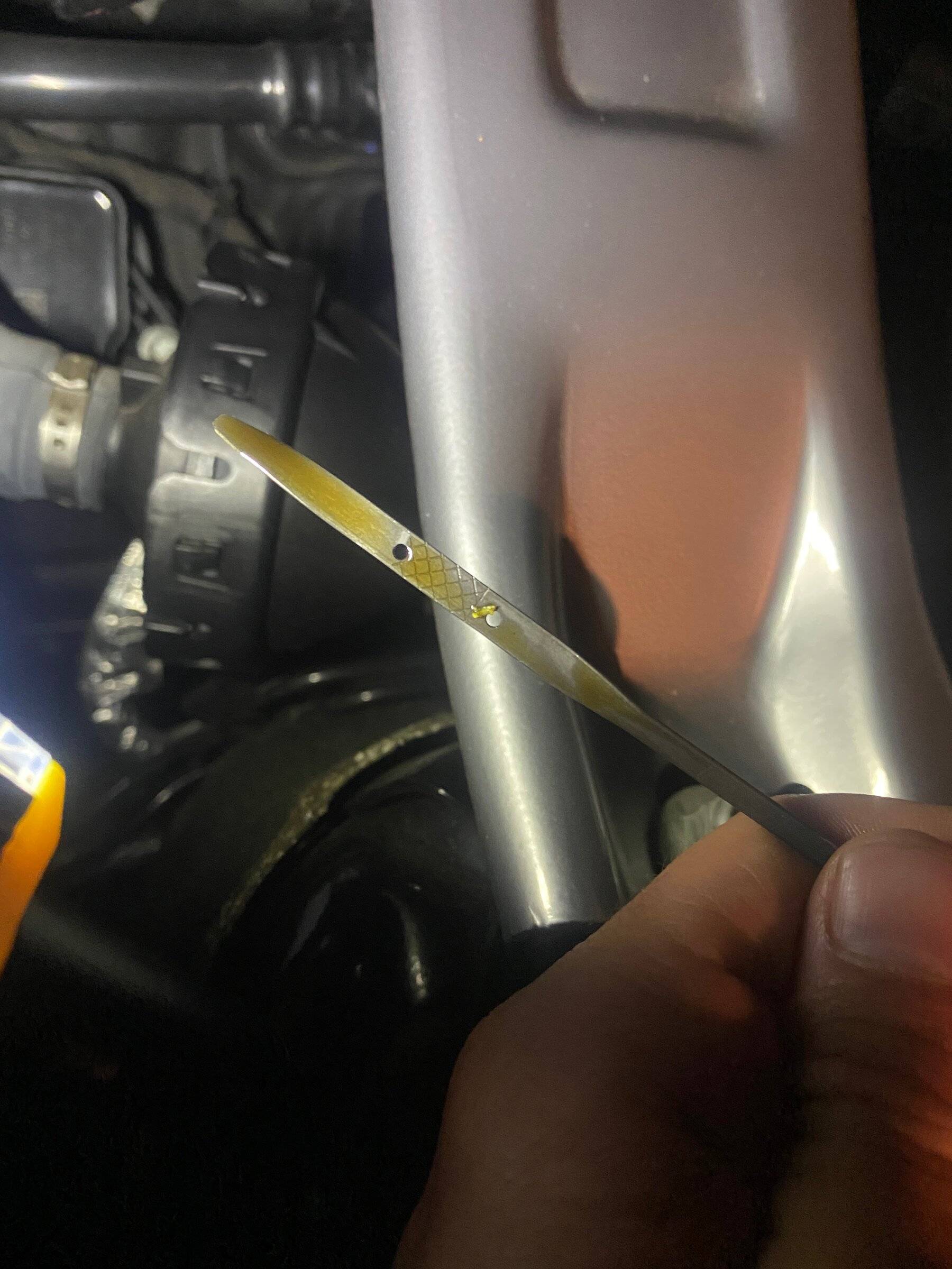

(BTW otherside of the dip stick 2nd pic is always covered in oil, the sides with the indiciators looks accurate IMO)

Hole to hole is 1 quart, so you burned about that much in 2000 miles. Not horrendous, especially if you drive spirited often. In the second picture it looks fine, although there's no film over the lower hole, so I dunno. I find with these cars it's better to check when they're stone cold. If you are under the lower hole, add a quart and monitor it.
Some of these cars do burn oil. Mine burned more when it was young, then as I got past 10K it slowed down considerably.
