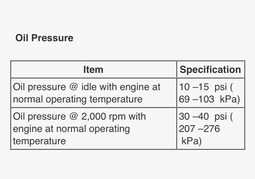

An old thread, but it highlights a feature of the Gen3 Coyote: an oil pressure solenoid, controlled by the Powertrain Control Module (PCM).
The Owner of that car should get back with the tuner, log specific variables to review, discuss and possibly make some corrections.
I'm not familiar with the coding parameters which might be involved.
https://www.mustang6g.com/forums/threads/idle-oil-pressure.174982/
https://www.mustang6g.com/forums/threads/2018-mustang-gt-15-psi-oil-pressure-normal.109015/
