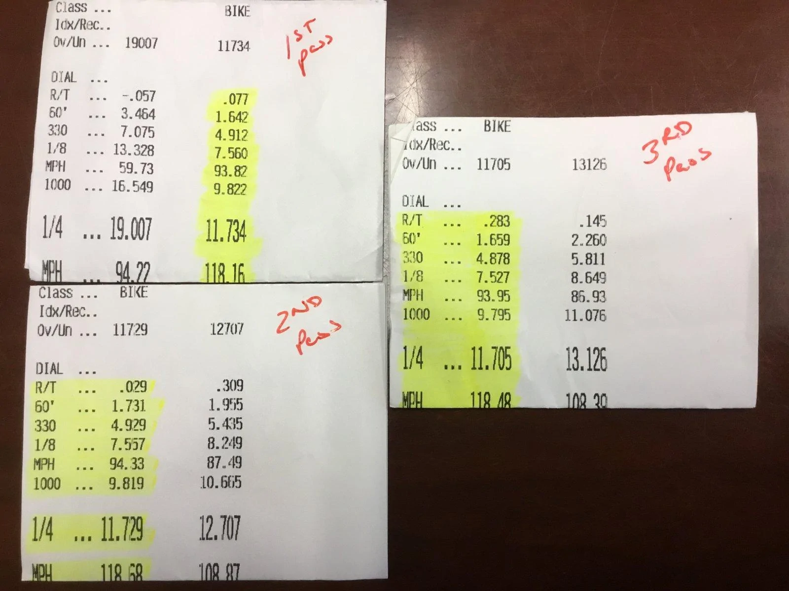

Well first time out with new setup. Not too bad. Spun hard on 2nd pass. Need to lower my 60’
Still have stock halfshafts,driveshaft,and shocks. Went with id1050’s instead of 47lb

Bad ass dude!
