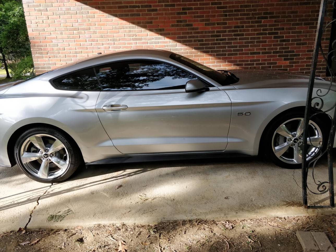

Looking to do 305/30 square setup on my S550
Canti
Nov 4, 2019
64
Atlanta
2018 GT Premium
I looking to do a square 305/30 setup on my new 2018 GT. It has the factory 19's that a non performance pack car comes with. I would like to upgrade to the PP brakes eventually, so I will be sticking with that size wheel. I am looking to get some konig dekagrams 19x10.5.
https://www.fitmentindustries.com/b...=2018&make=Ford&model=Mustang&trim=GT+Premium
And P4S' 305/30
https://www.fitmentindustries.com/buy-wheel-offset2/MIC10365/michelin-pilot-sport-4-s-305-30zr19-tires?year=2018&make=Ford&model=Mustang&trim=GT+Premium&bolt_patterns=5x4.5,5x114.3
(not getting from that site, I know I can get cheaper elsewhere)
I just want to know what I'll need to get these johnnys fitted right. Size and quality spacers and all that. I will be getting things like the steeda camber plates as part of my suspension upgrades, but would I have to get them when I get the wheels so that they will fit properly? Thanks in advance for the help.

A lot of camber. A 10.5” +23 is super aggressive, especially for the rear

I was thinking that it might too aggressive especially for a mostly street car. What square setup would you recommend for a mostly street but still good grip on track?

19x10.5 ET23 is going to stick out like 8/10" too far in the rear. A 19x10.5 should have more like a ET 40-45 offset to fit well in the rear.

^^^this. But those same wheels will hit the front struts big time. I’d step down to the 19x9.5A +35 and add small spacers to get the desired fitment

No, I'm not sure they'll hit the front struts. 19x11 ET 26 is a (pokey) but normal fit for a wide wheel with a 305 and clears the strut. With the wheels being slightly narrower and 3mm farther out, they should clear the front (and require healthy camber to tuck under the front fenders). Just embarrassingly pokey in the rear.

with a 10.5 the max you want to do is +32 for square. He isn't active on the site anymore but @NightParade was running Work wheels that were 10.5 +32 on coilovers. But he was running it with a 275. Another user did that same square set up but with 295s on Eibach Pro here is the link https://www.mustang6g.com/forums/threads/new-wheels-work-t7r-on-shadow-black-gt.93621/#post-2059659
