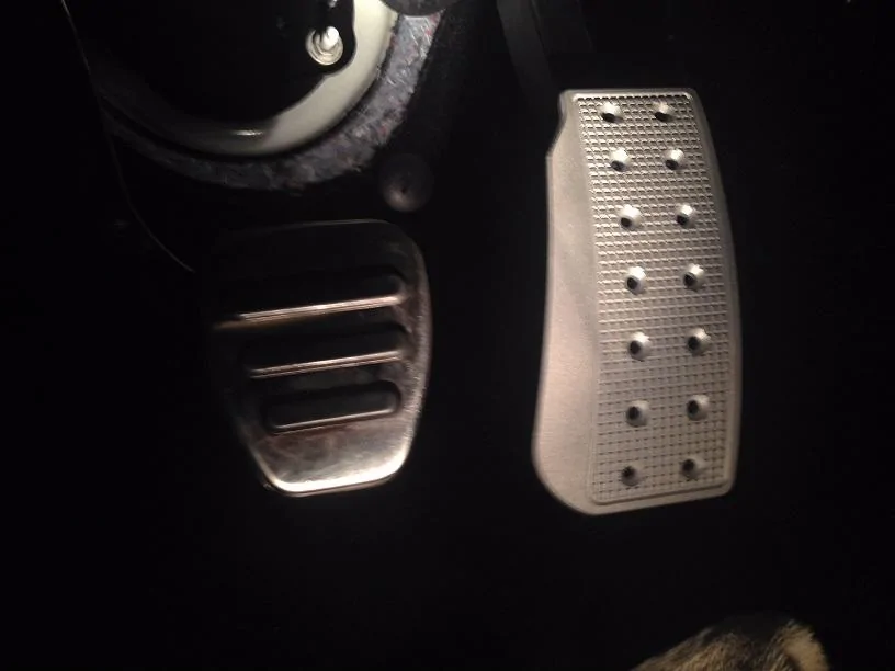

Interesting topic this one. I have tried to heel and toe but find its very difficult for me as the brakes on the 350 are just a bit too sensitive unless you are under threshold braking at 9/10ths or more. I was able to do it under these conditions in Utah at the 1 day track attack program. But there are many situations where you aren't needing threshold braking and then its so difficult for me. Regarding add on pedals I have put this one on top of my existing gas pedal thinking it would be a help with the heel and toe...it might have helped but not enough to suit me. So in the end I whimped out and put on the AutoBlip which I'll get to track test this weekend at Willow Springs....weather permitting as its iffy...we'll see. :shrug: Sorry for the slightly blurry pic.
