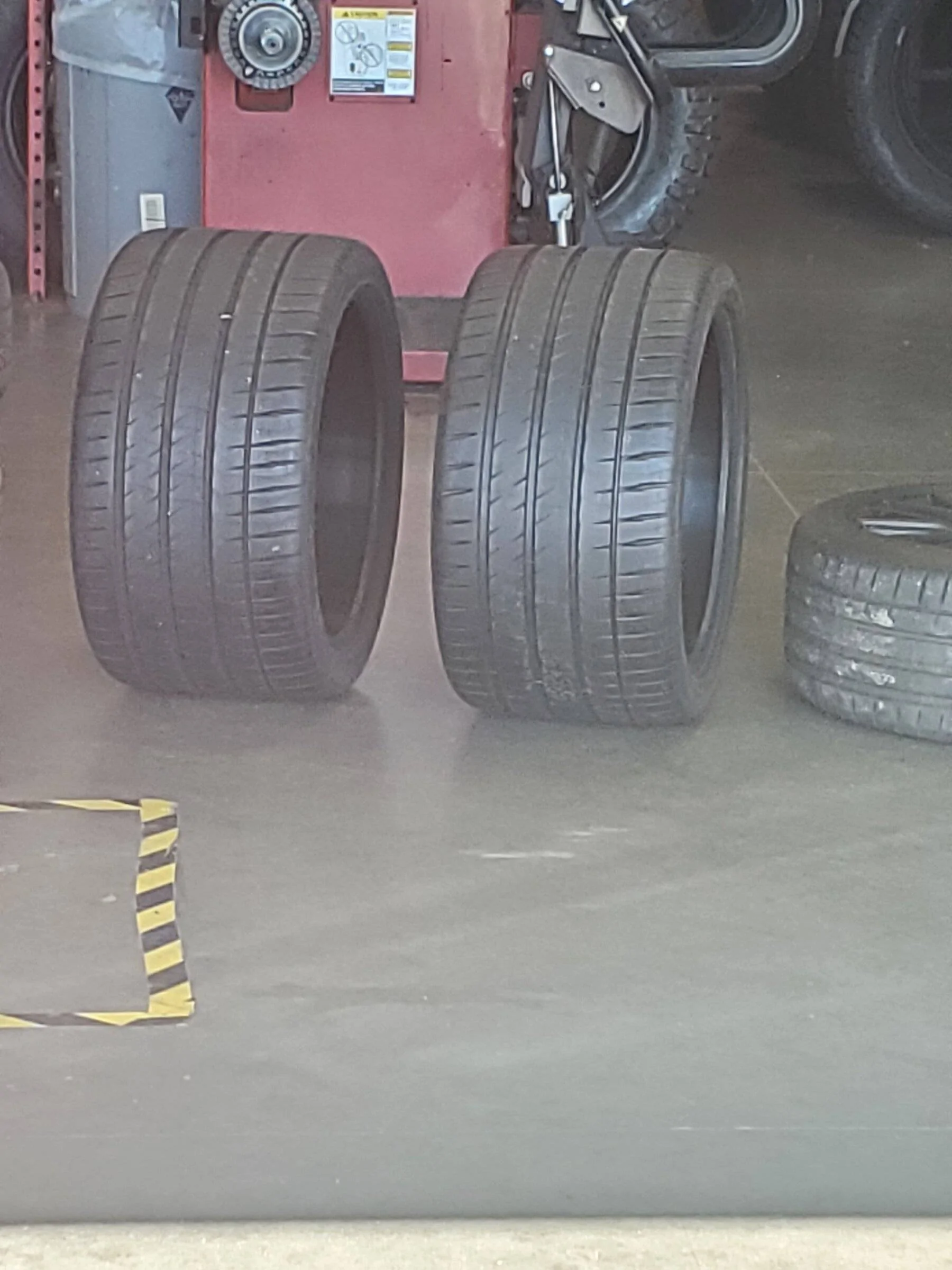

I was talking to Discount whom will buy these to sell me as a package reusing my 275/40/19 PS4S in the front and then 325/30/19 PS4S in the rear. How will it look with the 2 different sidewalls?

110mm vs 98mm. Depending on other visual references I don't think you'd notice any more than you already do, today.

OD of front tire is 27.7 and rear is 26.7. I think it would look realllly wonky not just in sidewall difference but OD.

If you put 285/35s on the front when the 275/40s wear out, the sidewalls and diameter will be really close.

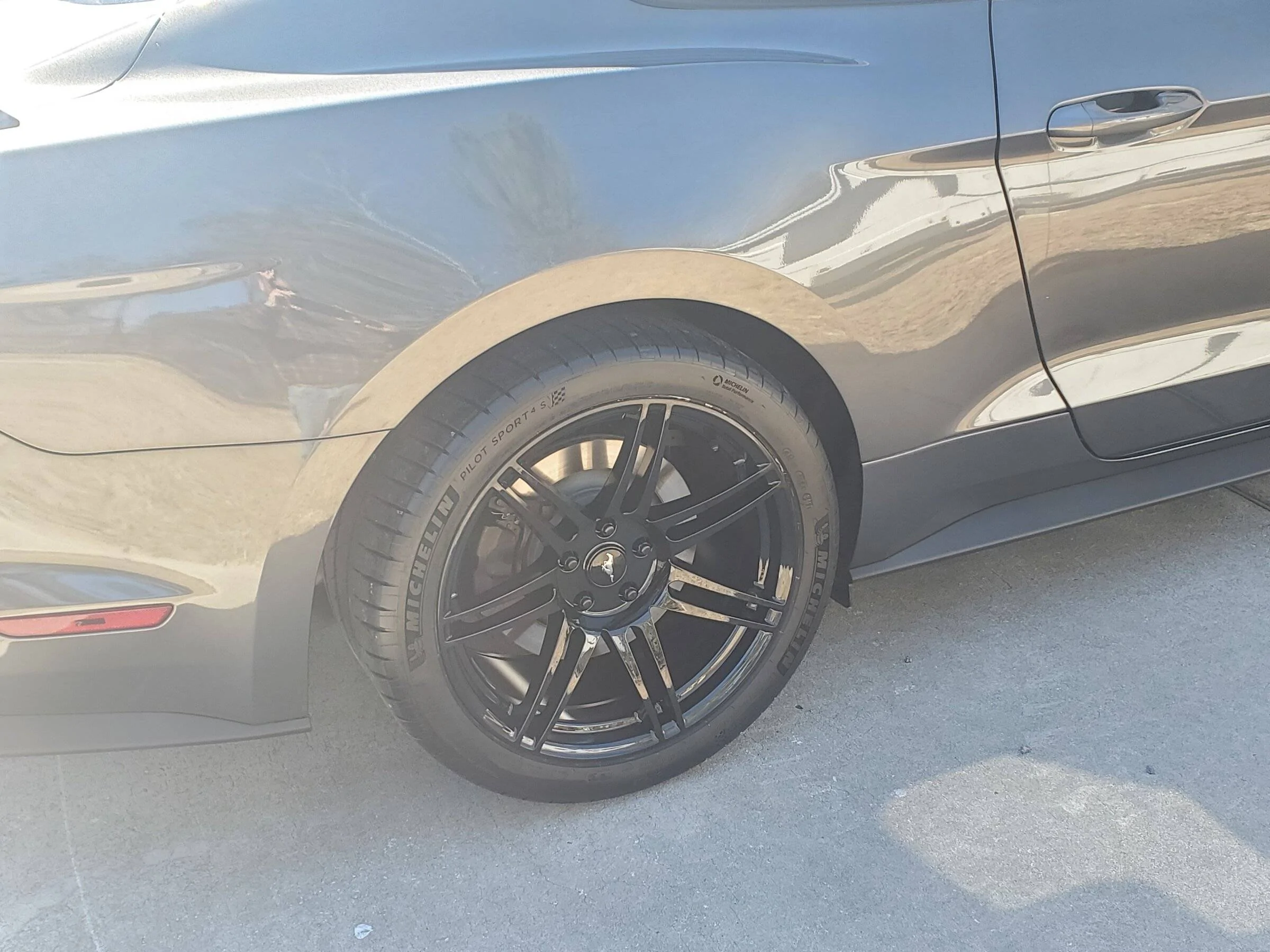

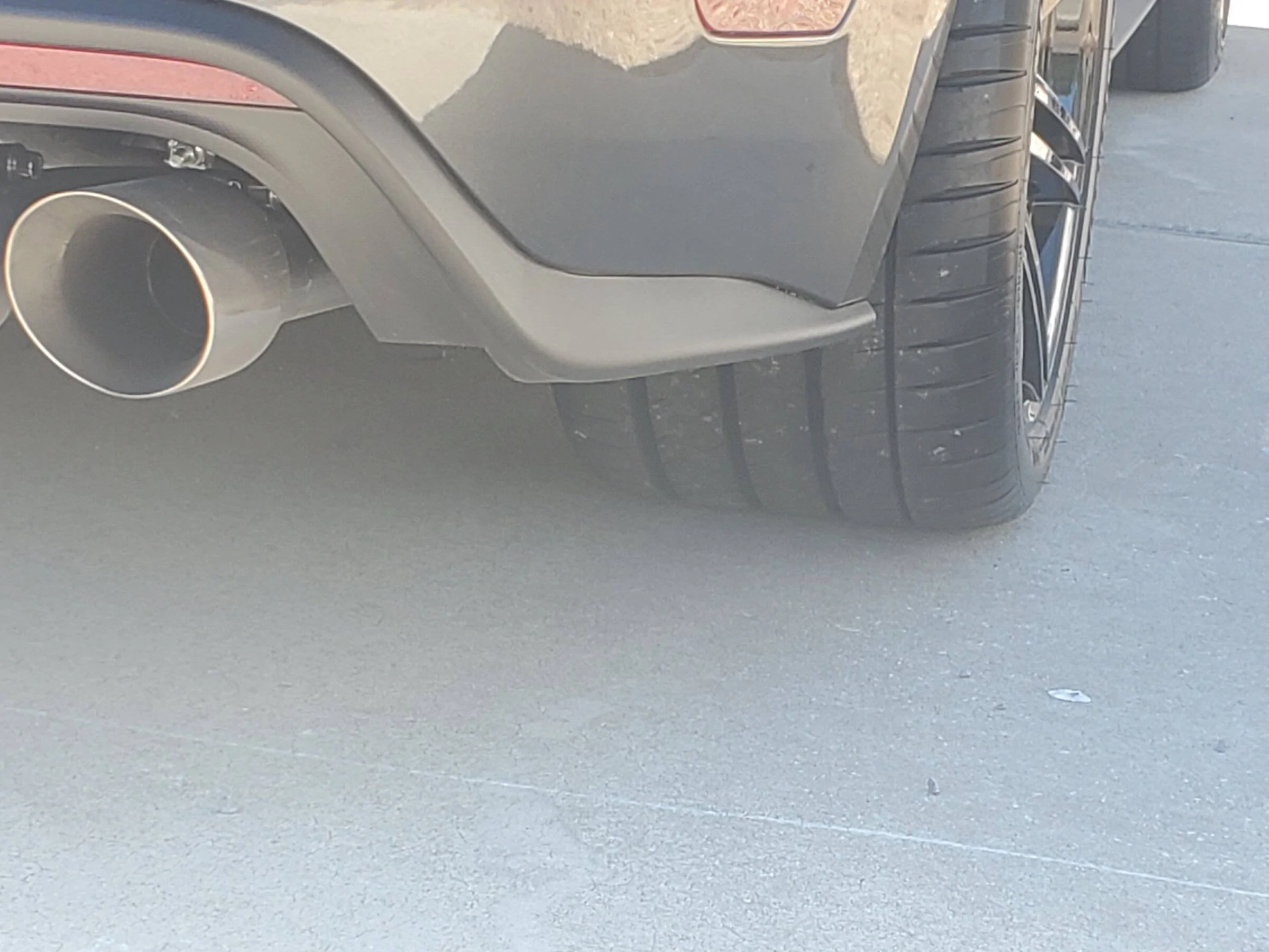

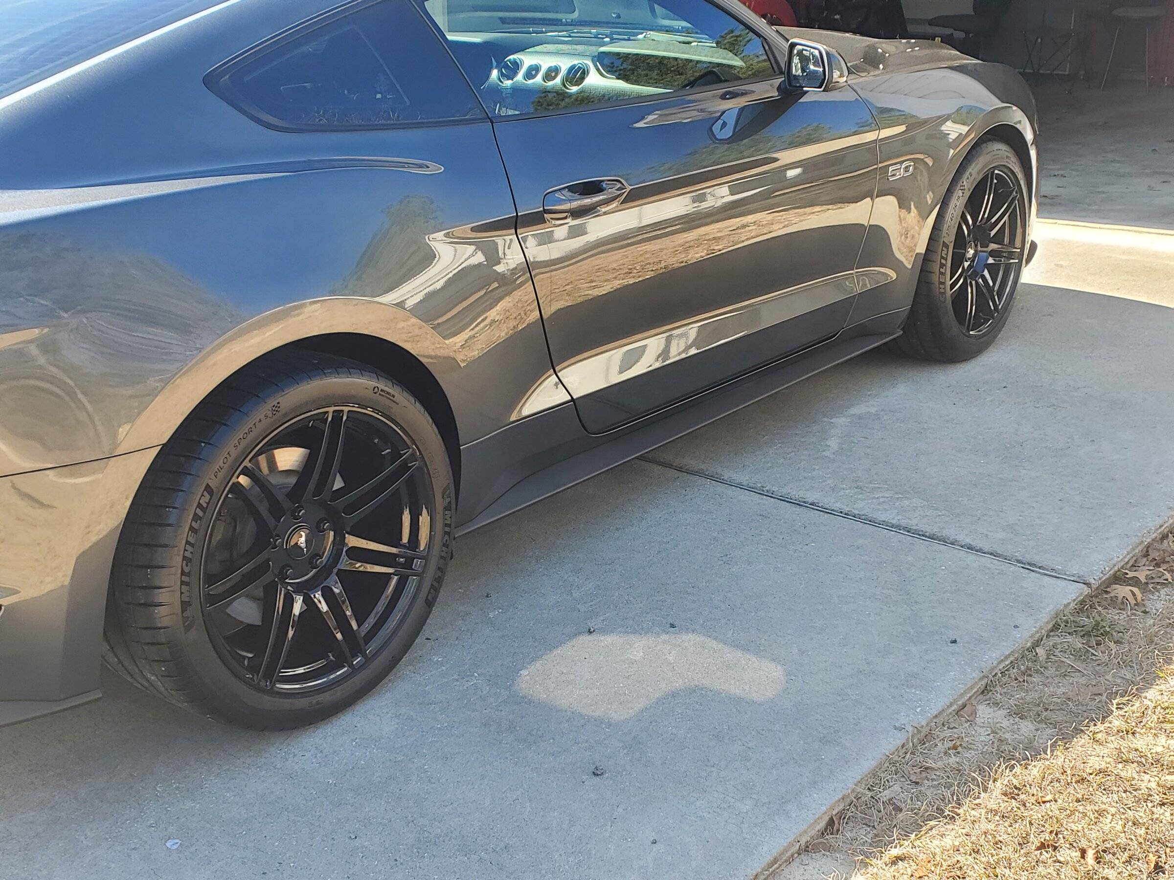

I got the 325/30/19 on the rear. I am in love with the look!

Man that rear tire really doesn’t fill that wheel well out, leaves a lot of gap.
I bought these exact wheels but just pulled the trigger on 305/35 and 275/35’s to keep my wheel gap to a minimum.
