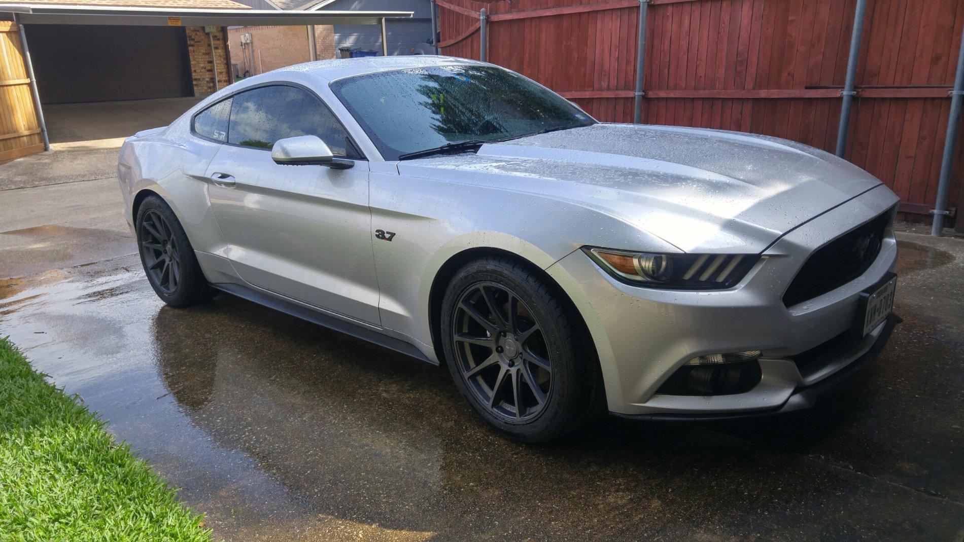

FYI, this is 270/40 on 19x9.5 ET33, not lowered. The +37 offset will be fine.
