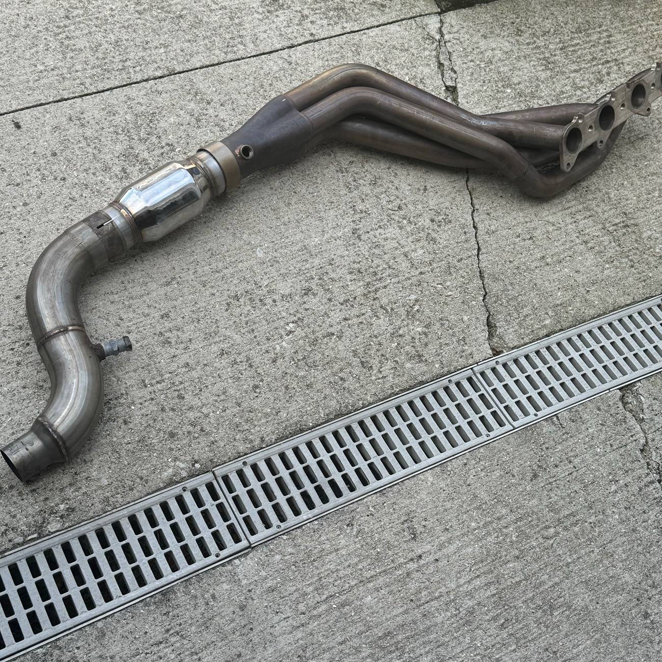

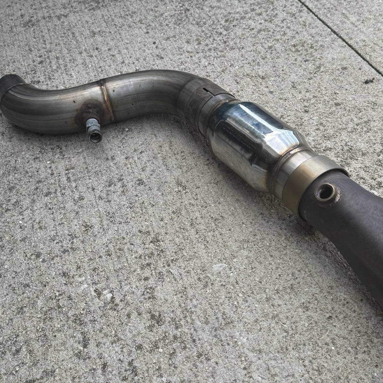

how many o2 wire sensor extensions do i need on each side?
do i need to plug either of the bungs on these headers?
these are catted texas speed headers going on a 2016 gt.

For what reason? To pass emissions?
Pre cats should have no spacer
Post cat should have no spacer on a catted setup, if they still throw codes, a small spacer could fix it, read the code and find out if its reading rich or lean to get a longer or shorter respectively extension

I would sugest Looking up your header manufacture and ask them.
i did ask them first, all they did was send me the link to the wire extensions.
so i figured i would see if anyone here could help as they are a fairly common header choice.

Call stainless works and see what they use or if you can order from them. My SP headers just came in and mine were included.
