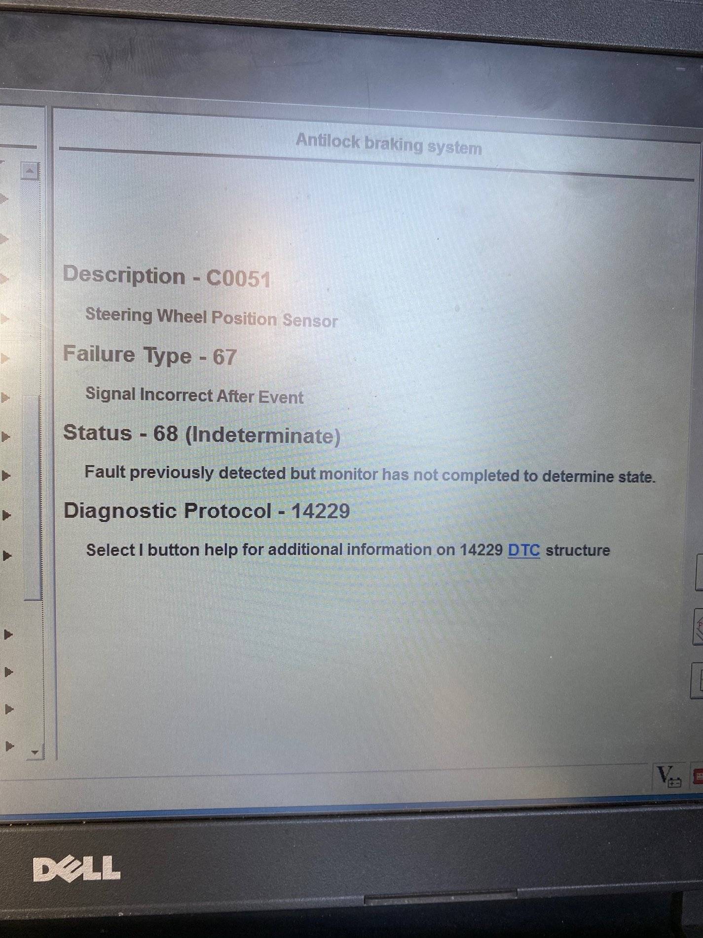

I still haven't heard back from my dealership but the great people at Galpin Auto Sports told me to bring it in and they would run the code for me. This is what we came back with:

different than my code
