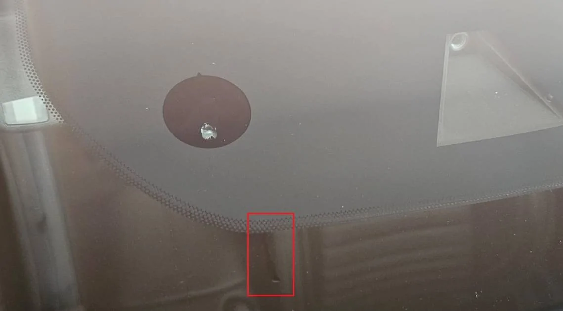

2021 Mach 1
I've had my Mach 1 for a few years.
In attached pic, in the red rectangle, you can see there is some sort of oil slowly leaking from below the rear view mirror.
I've had this happen twice before, and each time taken it to local Ford shop, who have replaced some sensor in the mirror. Then there is no leak for a while, but then it seems to start again.
My car spends most of it's time in a garage, so is very rarely parked in hot sun.
Any others had this happen to their Mach 1 or Mustang ?

Yes, my 2019 GT/CS is on its 3rd rain sensor. It only starts leaking when in the garage over the Winter but then continus in warmer weather. Cold temperatures start it.

Yep, @Mike Pfeifer had the exact link I was looking for. It is the rain sensor that will occasionally leak a little fluid. Nothing too alarming to be honest.

I wondered what that was as I saw it maybe 3 or 4 times on my car. The first 3 years it was in a tropical climate in a garage that averaged 90 degs. or more. I haven't seen it the past year and it's currently in the 20's temp. wise so I suspect it's more prevalent in a warm climate. It's probably the excess that was seeping out as my auto wipers still work fine.

If some rain sensors leak and some do not, then a leaking sensor can't be considered "normal". There has to be a reason that some leak. I'm saying that going into my 3rd replacement.
