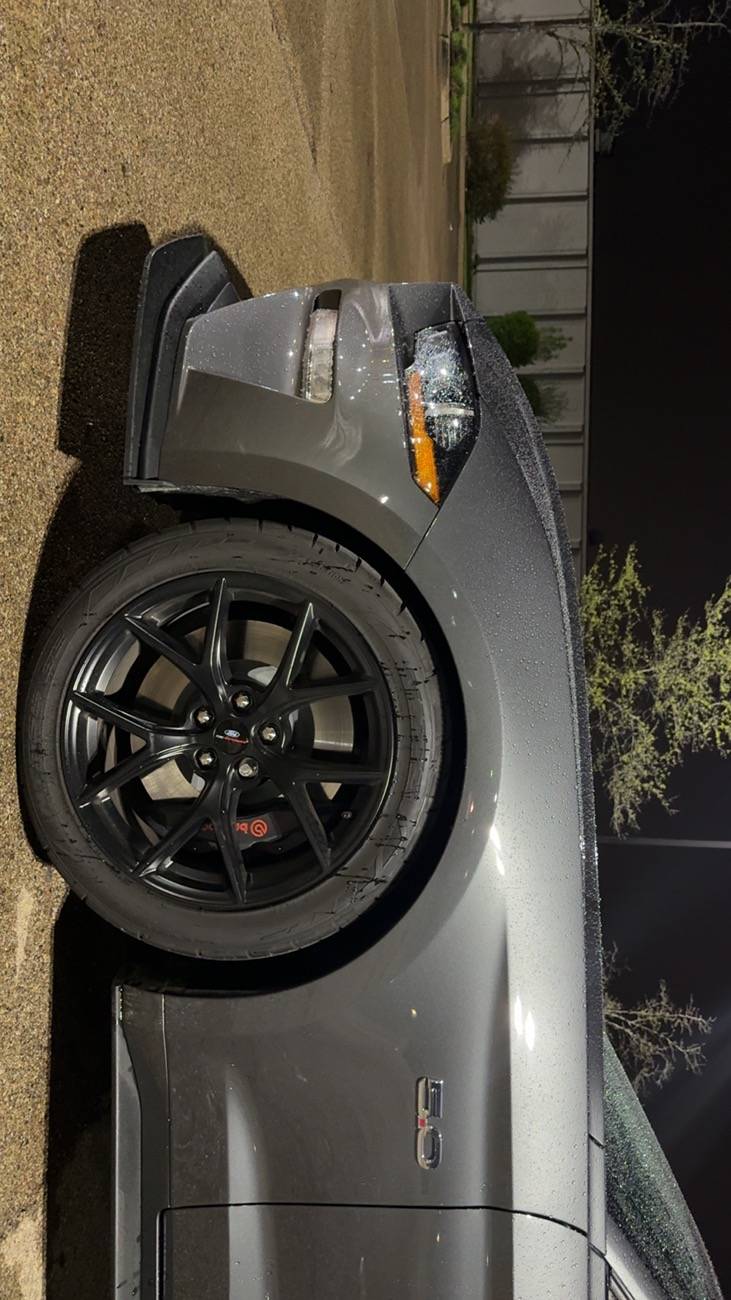

Any updates?
So I love the setup honestly, the shocks and struts are extremely comfortable over bumps and for day to day driving. Tighten up well around curves, car handles a lot better, plus all the bounciness of the stock suspension is gone. Also love the minimum drop springs I went with, from Steeda as well. They clean up the wheel gap to where I’d say it’s “performance” fitment, but very usable for daily driving, and curved driveways, I drive this car year round in Chicago and haven’t experienced any scraping in the first month of any kind. Just a warning from my experience, I’m currently having to replace the front strut mounts that only had 18,000 original miles on them. The bearing began to make noise after reinstall with the Steedas, so I just recommend doing those too because they’re $130-150 and saves you a lot of time or money. I wish someone would had told me that there was a chance of that happening prior to install, oh well. I did use Steeda billet shock mounts for the rear and haven’t had any issues with those. Any other questions let me know!

Have you noticed any increased harshness over stepped and small bumps?
Did you cut bump stops?
I wonder if installer over torqued the strut shaft nut ruining the bearing....

I used Steeda precut bumpstops, I’m sorry to hear the Koni’s didn’t work out. Quite honestly the car rides way better than stock in my opinion over bumps and road imperfections. Even my buddy with a supercharged 2017 GT with stock suspension who doesn’t care about comfort whatsoever commented on how nice it rides one day lol.
