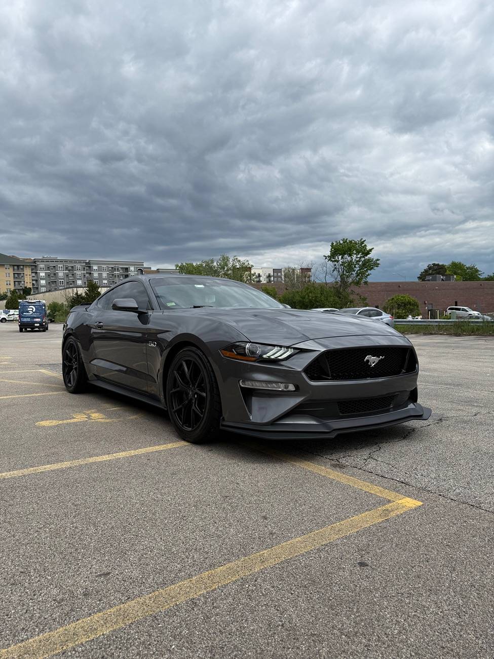

Got the car back yesterday after a little fiasco. I brought the shop new top hats to install from Ford Performance and had put the soft rubber part with the bearings in the front passenger seat and the metal top hats in the rear seat. Upon originally going to pickup the car, the shop had installed the new bearings, but reused the old metal top hats as they didn’t see the new ones in the rear seat that were in a closed package. The bearings were the issue anyhow not the top hats, but I wanted things done right and so they kept the car, took apart the suspension again and reassembled now with the new bearings and top hats. I now hear no sound anymore when turning the wheel back and forth to full lock like I did before. I mean, I have heard a pop like twice when full locking to the left specifically, but I’m assuming this is due to settling as I haven’t driven on the setup hardly at all since I got it back this time around (60 miles). The bearings on the old top hats were BAD. I had my friend who’s a technician examine the car when I got it home this time around after the top hat replacement and he said all looks well and is seated correctly so I’m not too worried about the popping sound I heard. I still hear some noise (what I think people describe as groaning? idk) when angling into steep driveways and stuff, but I’m assuming this is normal on a lowered car due to the change in geometry. We’ll see, I’m starting to think some noise is normal with aftermarket suspension parts. I’m sort of a perfectionist and while I love this setups feel, when I have the funds eventually I may call it quits on aftermarket stuff and go Ford Performance track installed by the dealer to avoid any sort of BS. I will say though I’m happy with the look and ride of the car overall and don’t have the energy or funds to keep chasing any small nitpicky sound issues, so I’m going to enjoy it, barring someone tells me anything I’m experiencing sounds dangerous or detrimental (which I doubt due to ride quality feeling normal and not having sound during normal driving conditions over bumps etc).
