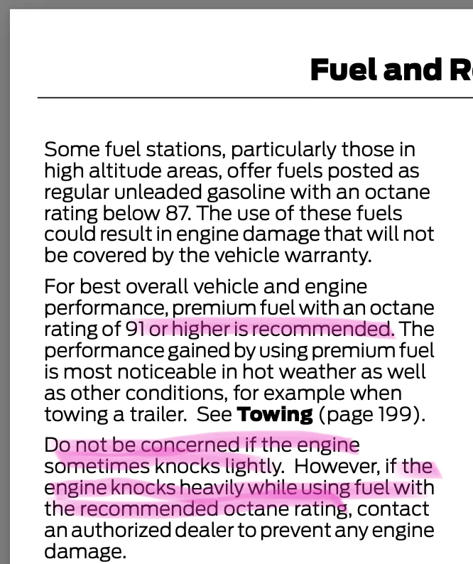

from the owners manual:
Have you confirmed that it is actually knock, according to the knock sensor?

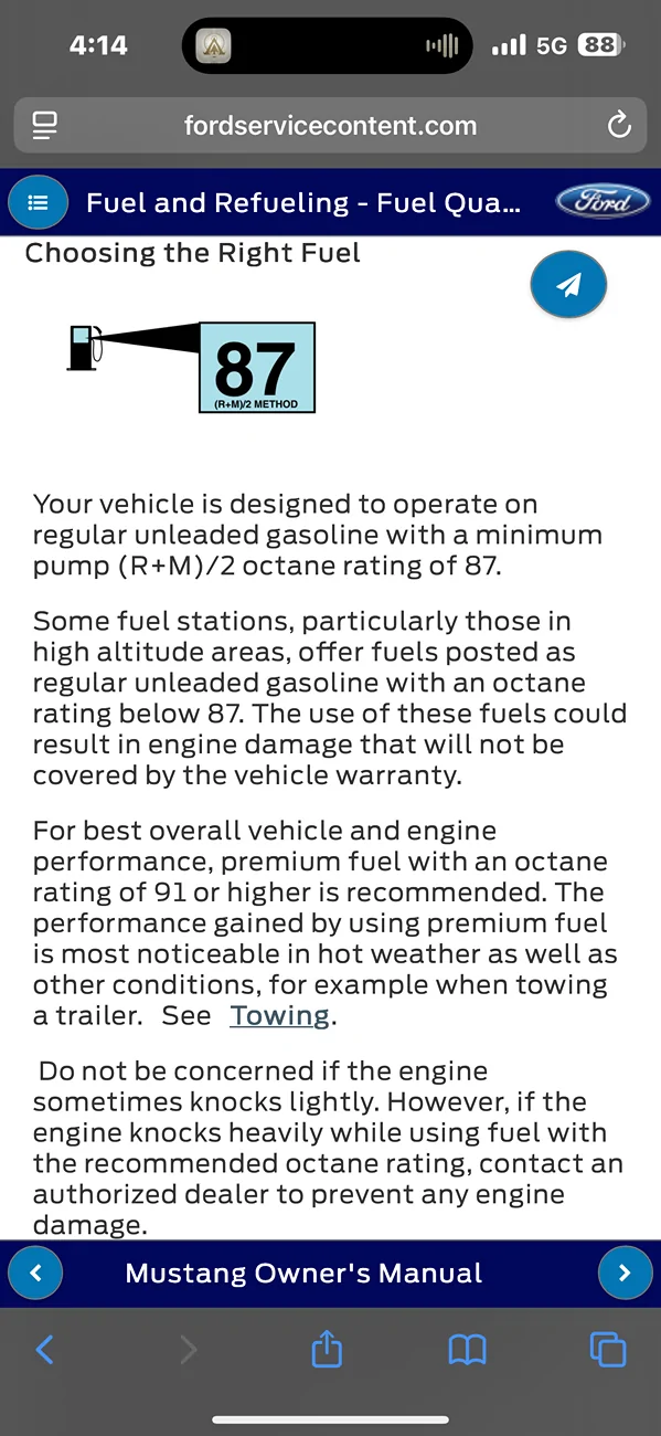

No need to be rude to the guy… Ford clearly says the car can run 87 so if yeh guy isn’t racing or whatever and wants to run 87 he should be able too as ford engineers say it can be done.
You literally cropped out the part that says “your vehicle is designed to operate on 87 octane” come on man…. If you’re gonna show a picture show the entire thing🤦🏼‍♂️.
He says he hears a knocking sound when going 50% or more on the throttle and says that it goes away when he puts 91...
Again, common sense isn't so common.
Nobody said it wasn't able to run on 87 octane.
No one is saying it isnt knock… it probably is. you said you need to run 91 … clearly you didnt read the manual as that isn’t true. Of course 99% of people run 91-93 octane. I was just stating that the manual says you can and some People do run 87 and are fine… which points to either bad gas or another problem with this guys car.
GR1MxREAPER
Aug 30, 2021
373
458
Minnesota
CJ
2019 Mustang GT Premium
The guy above literally just did bro 😂. And you
Showed a picture with 91 gas highlighted . You can’t make this up. 🤦🏼‍♂️🤦🏼‍♂️🤦🏼‍♂️
