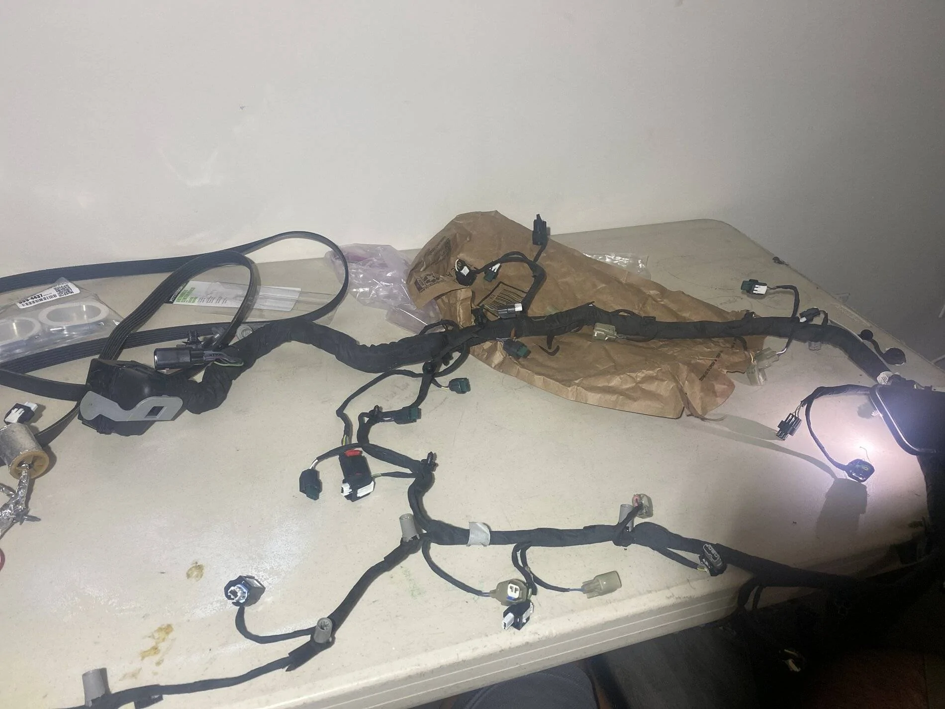

We’re working on a 2021 GT. We just installed a ported manifold with lockouts and did oil pump gears. The car was driving great and then suddenly we blew fuse 40 (vehicle power 2). This fuse powers the O2s, VCTs and a number of other essential sensors keeping us from doing WOT pulls. I’ve read through other posts on this issue but haven’t found a solution that works for me. We’ve checked over the harness and replaced the O2 sensors but are still getting a blown fuse. We’re pulling the manifold now in hopes to find a bad wire. Anyone got anything else we should check? Thanks.

Just update we pulled the engine harness and are gonna check everything one at a time

I had a short on wire for the rear O2. The edge of the transmission rubbed through the wire. Addressed that and never has an issue again.
