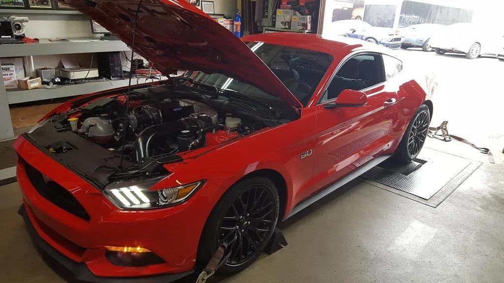

Also, looks like I'm first in line for the dyno. No one is at the shop yet. So I should get in this morning :)
Awesome! Good luck and let me know what she puts down!

Viddddeeeoooo :)

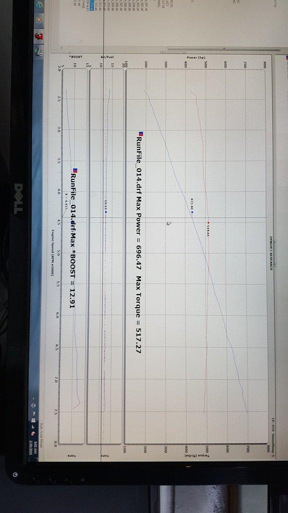

Holy shit :)
Sent the data-log over to Lund. There may be more timing in it.
That's on plain jain 93 octane my friends!

What pulley is that to get 13 pounds it can't be stock pulley lol
