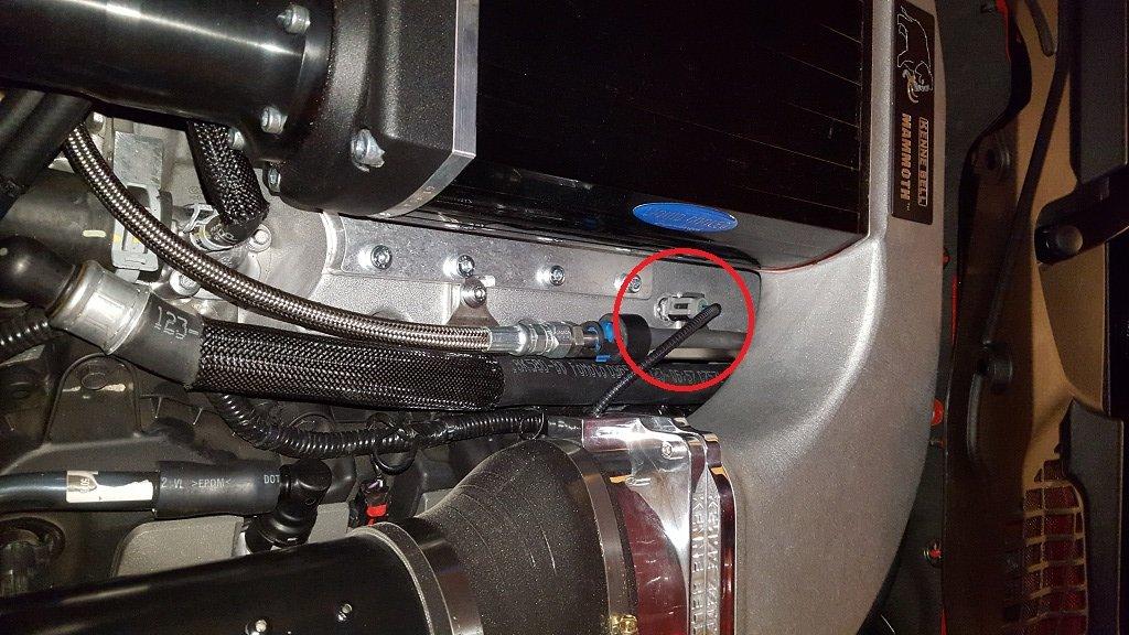

Those IAT numbers sound like pre compressor, coming from the MAF IAT 1. As far as I know Lund doesn't have an accurate IAT 2 post compressor hot side measurement.
I know theres a sensor connected to the discharge manifold, and thats what i hard wired into the MAF harness. I don't quite know where the other would be if thats the case, unless the mass air reads IAT as well.
But those temps would be POST compression.

I'll snap a pic of the KB setup in a second, I HAVE an IAT sensor in the discharge manifold. I'm pretty sure that's it. The harness looks similar too!
I don't know where it would be taking it's initial reading though.

That's the sensor. It's sitting in the compressed air, i had to tie this into one of the wires in the MAF sensors harness.

Ok, so we're talking about the same thing. Yeah this one came with the KB kit

Yep, looks like it. I know that Lund will what the see the temps after the blower prior to finishing the tune. I had to order the vmp IAT breakout separate from my whipple kit before he would finish my tune.
