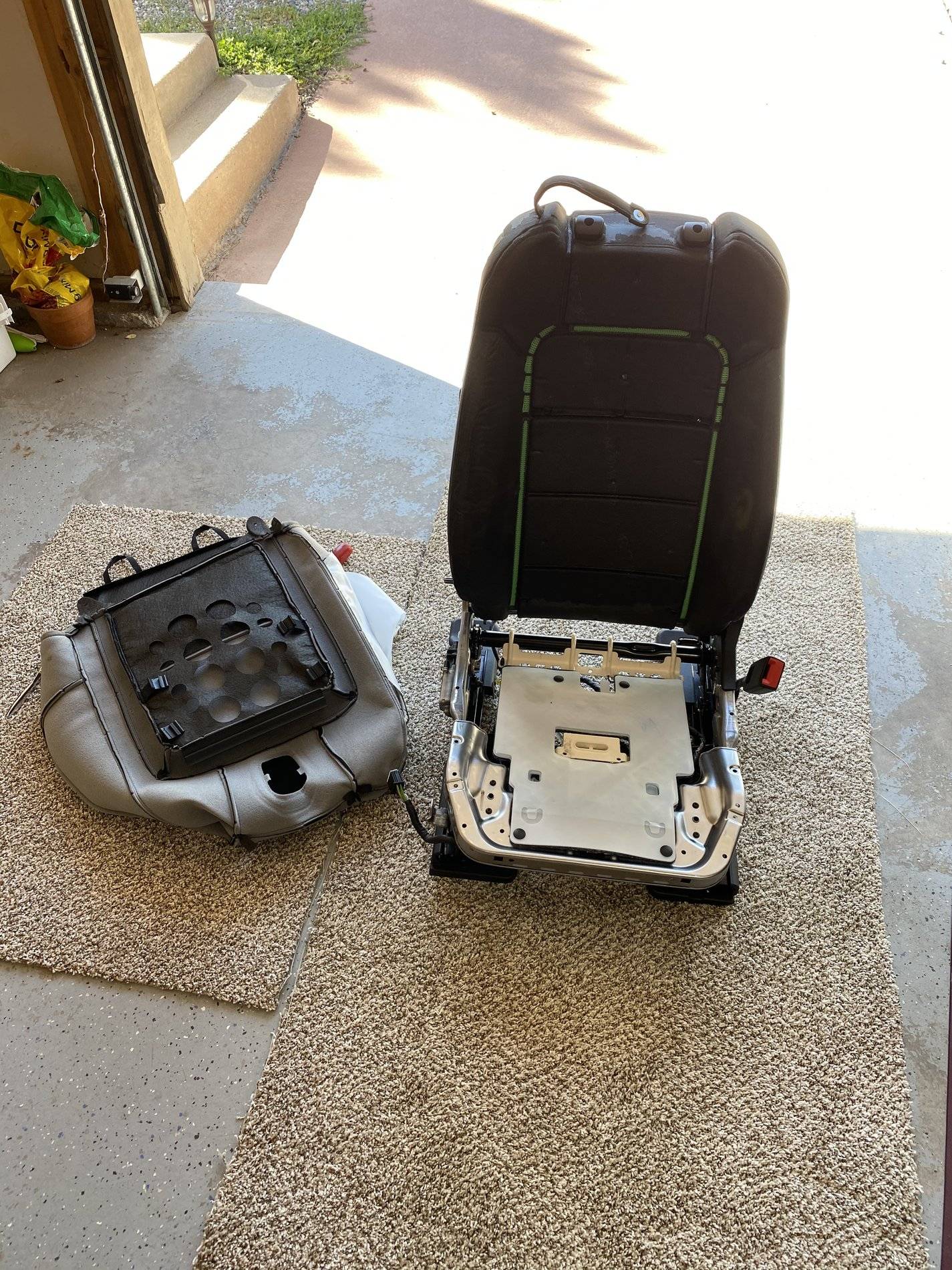

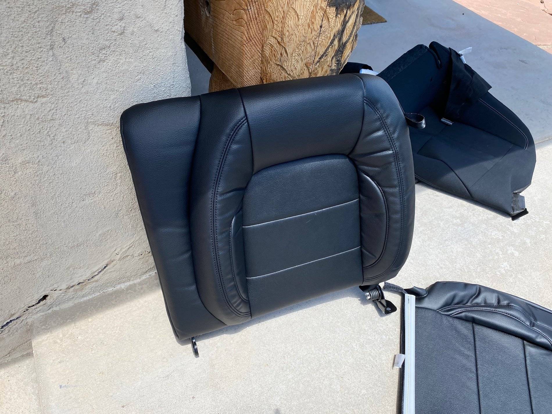

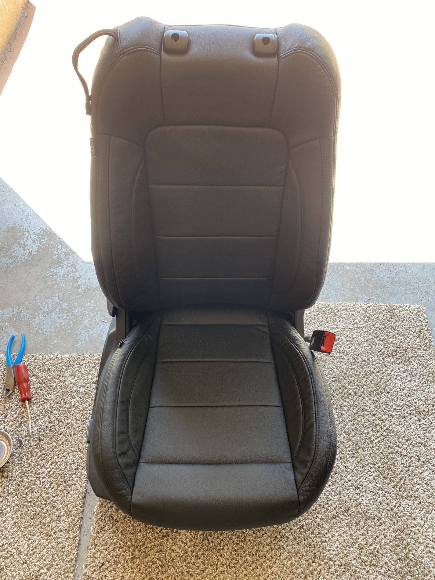

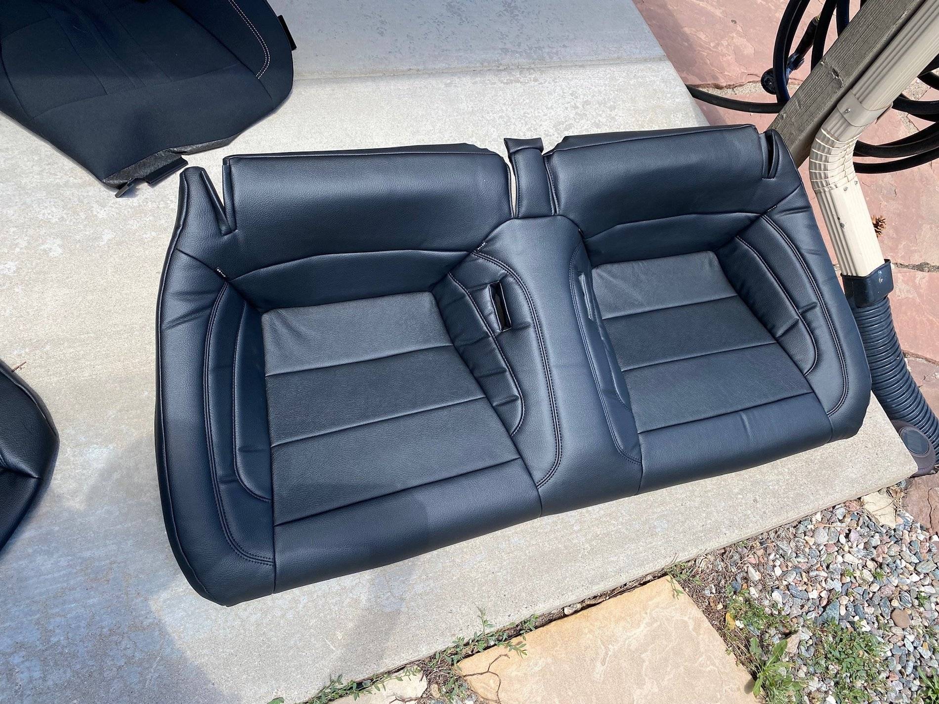

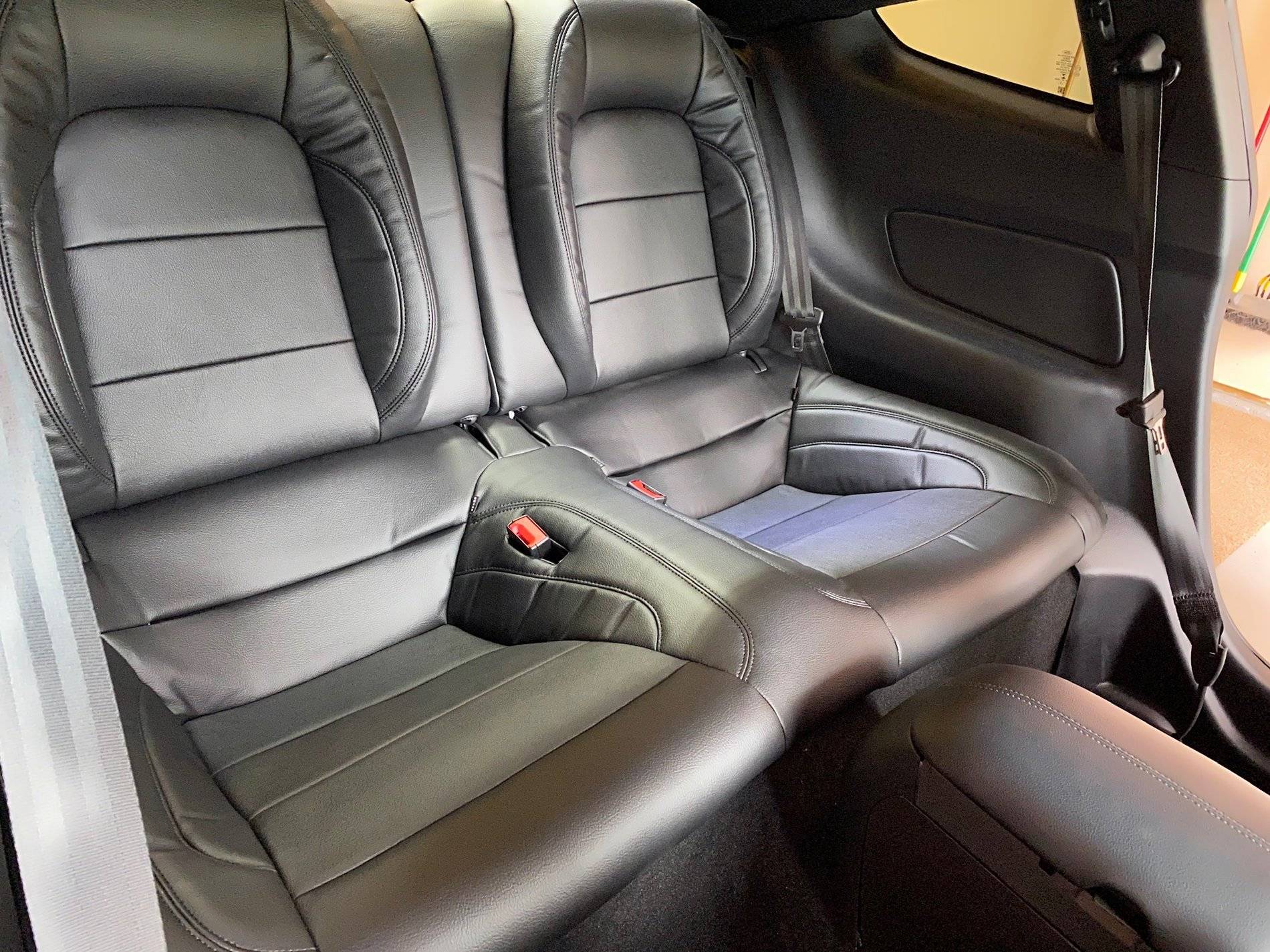

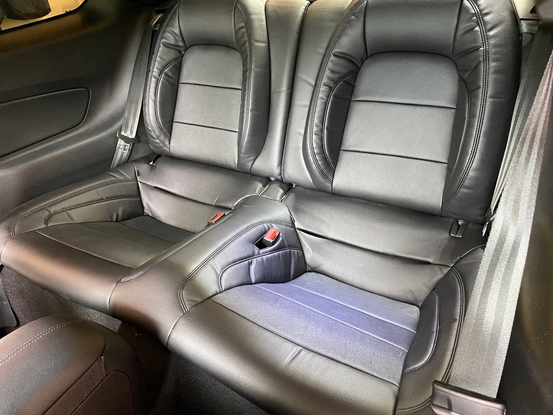

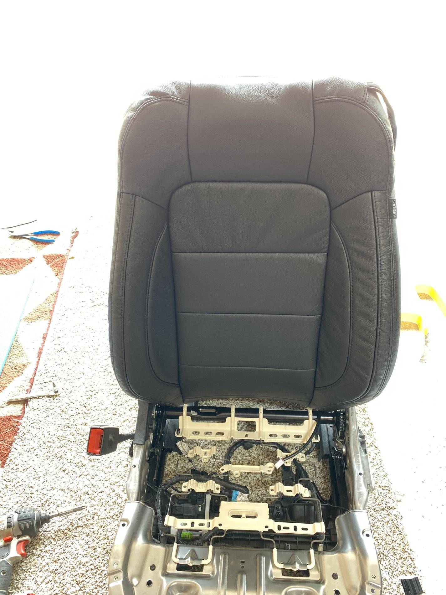

Started my Katzkin leather install and sound deadening. Finished the rear seat and deadening the other day. I will do the fronts 1 weekend at a time. The rear seats were easy. The hard part was climbing back there and using the peel and stick and mass loaded vinyl. Not many pics but here are a few. I was going to install the Shrader Performance rear seat delete I have new in the box, but decided to just keep the leather. If anyone I’d interested in the Delete, PM me for a super deal.
https://competitionmotorsport.com/shrader-performance-rear-seat-delete-mustang-2015-19

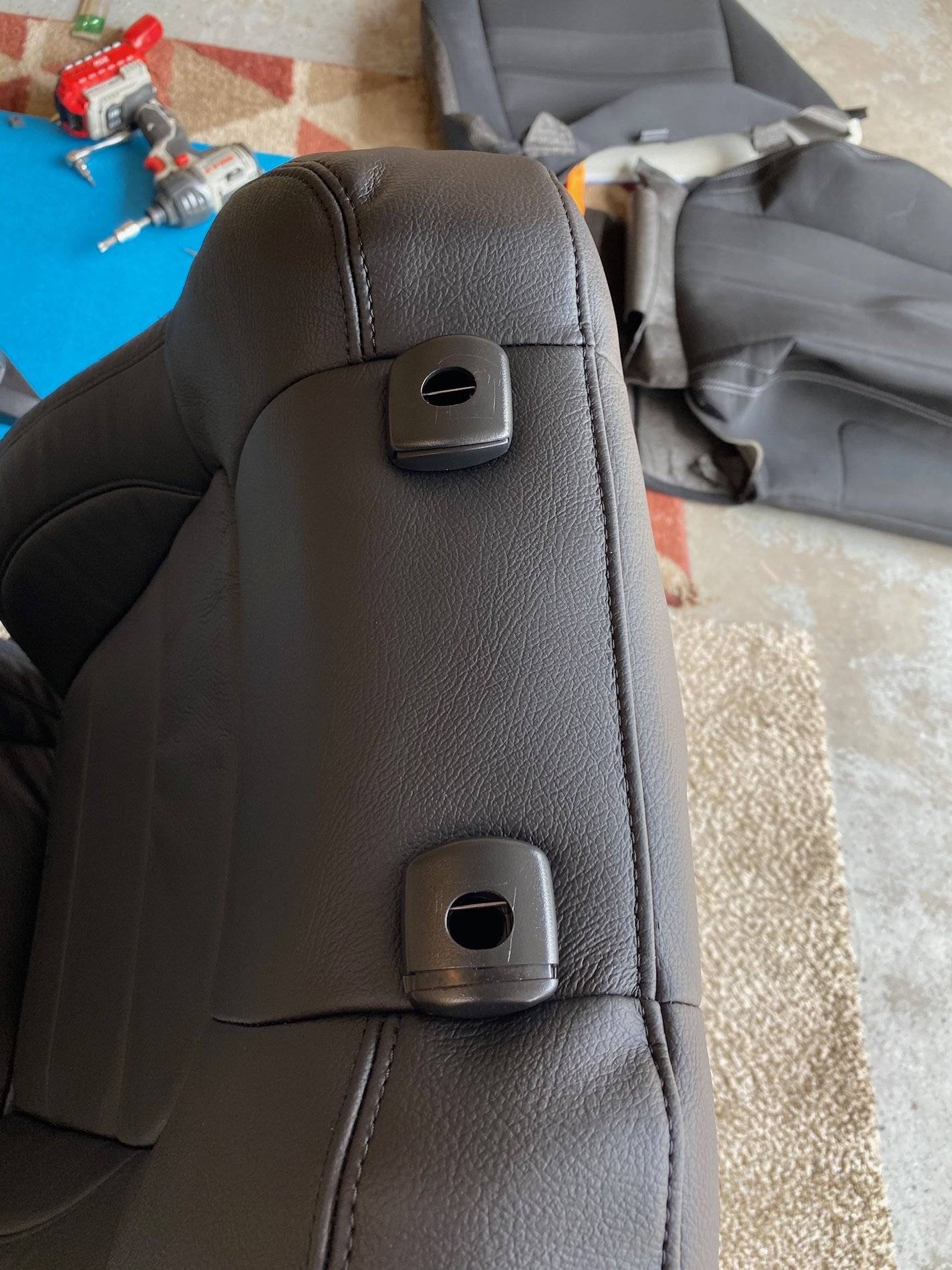

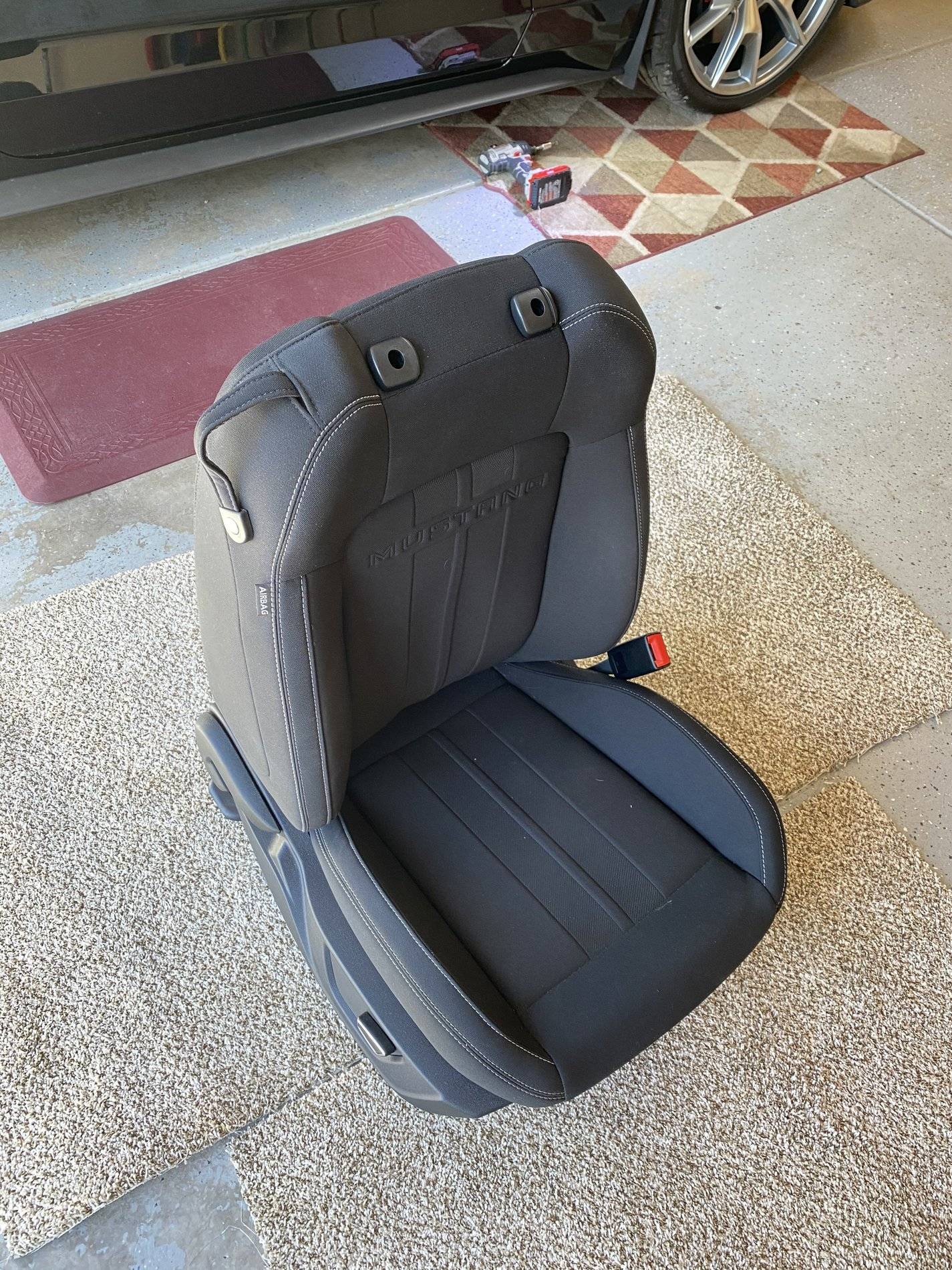

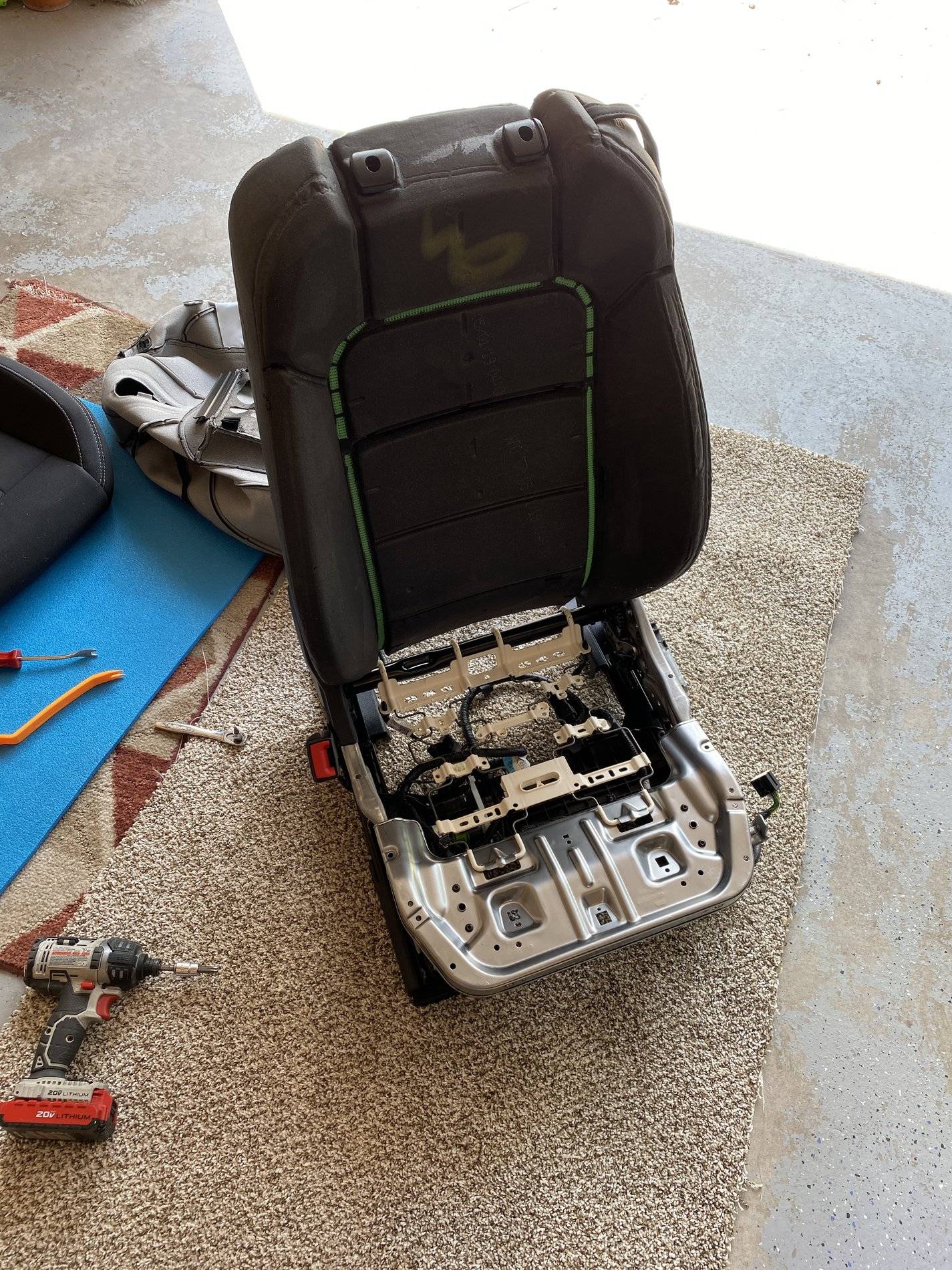

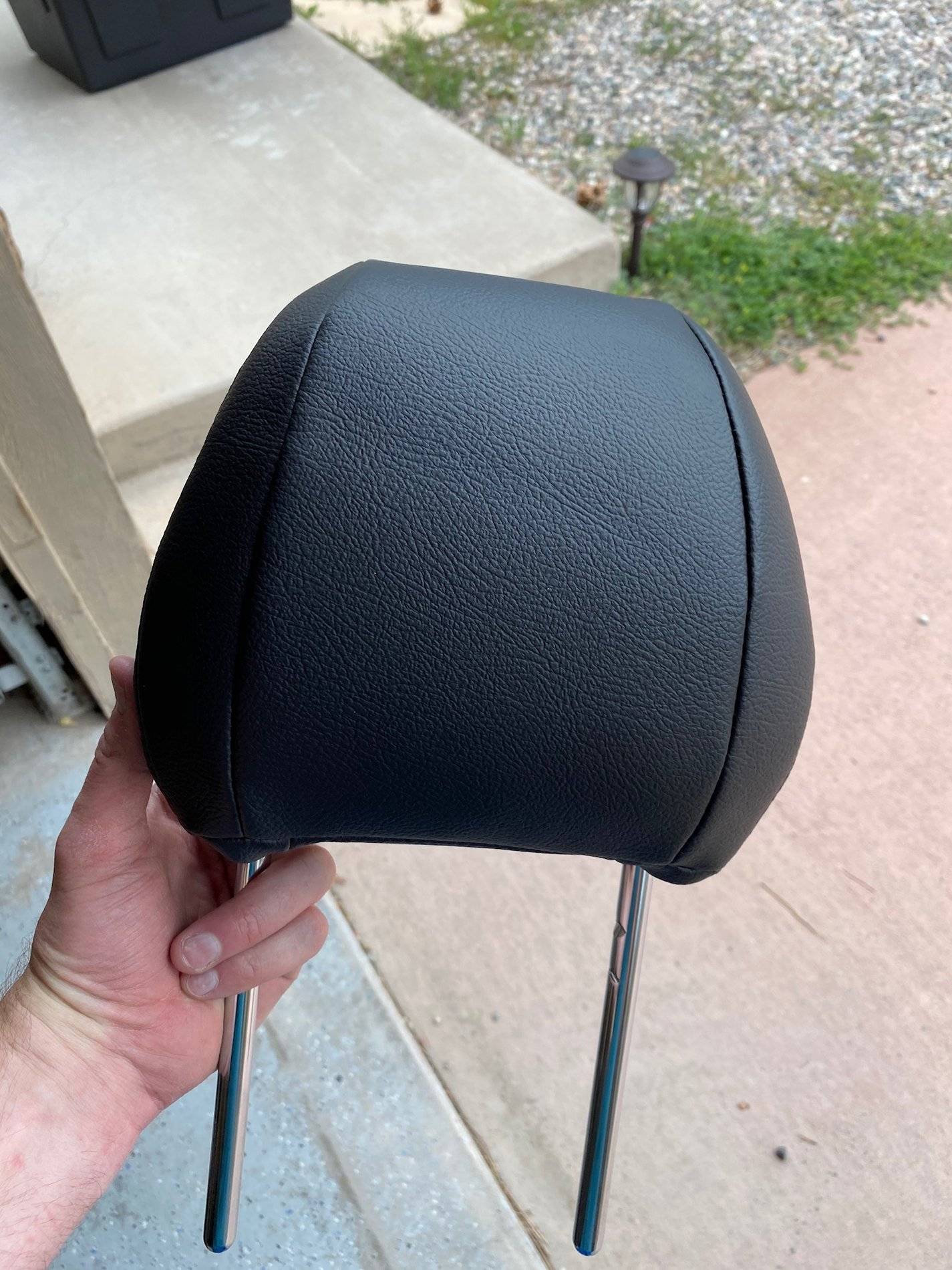

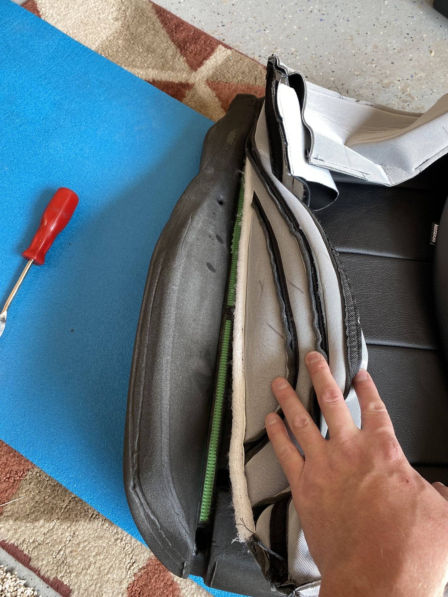

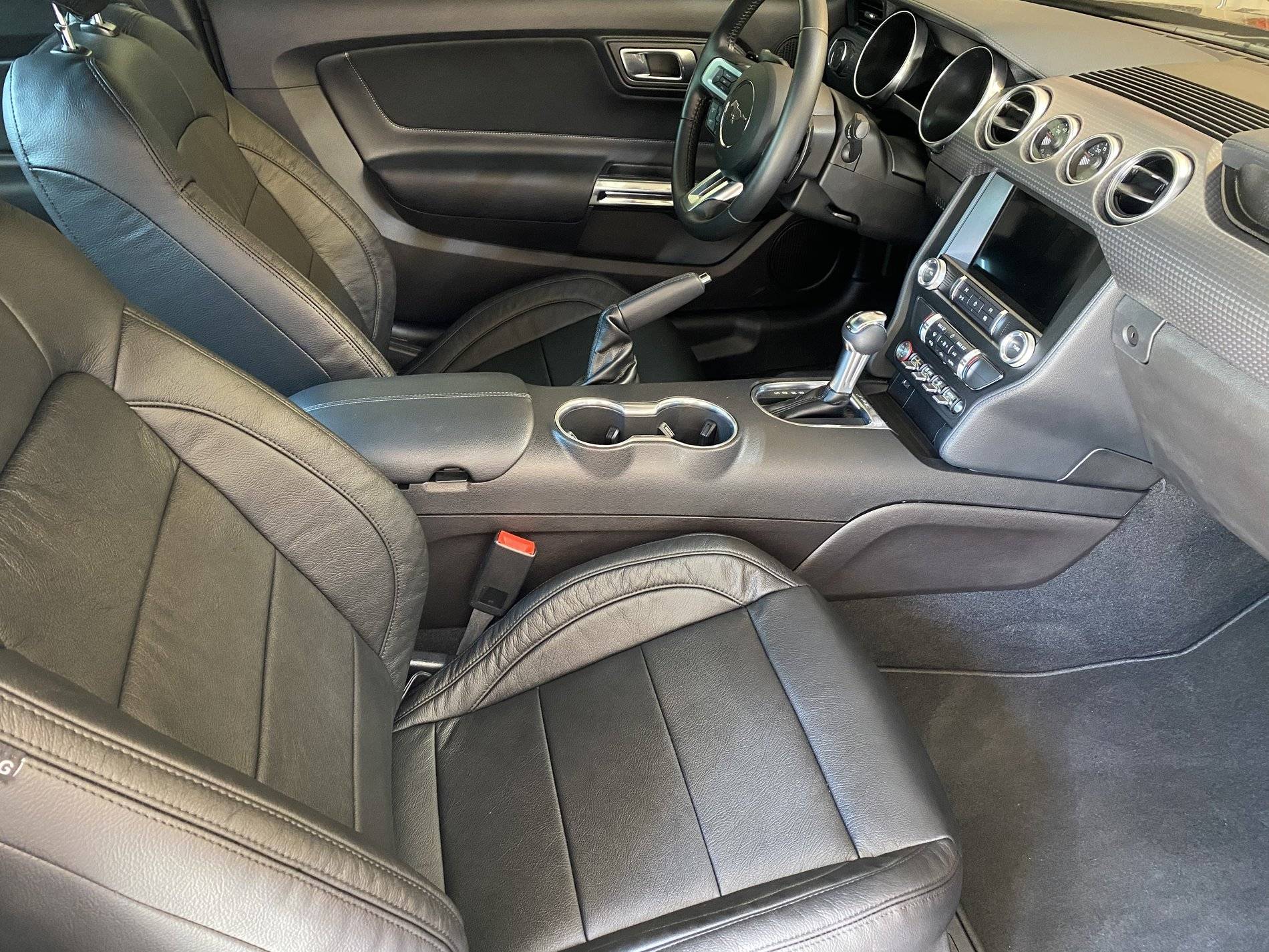

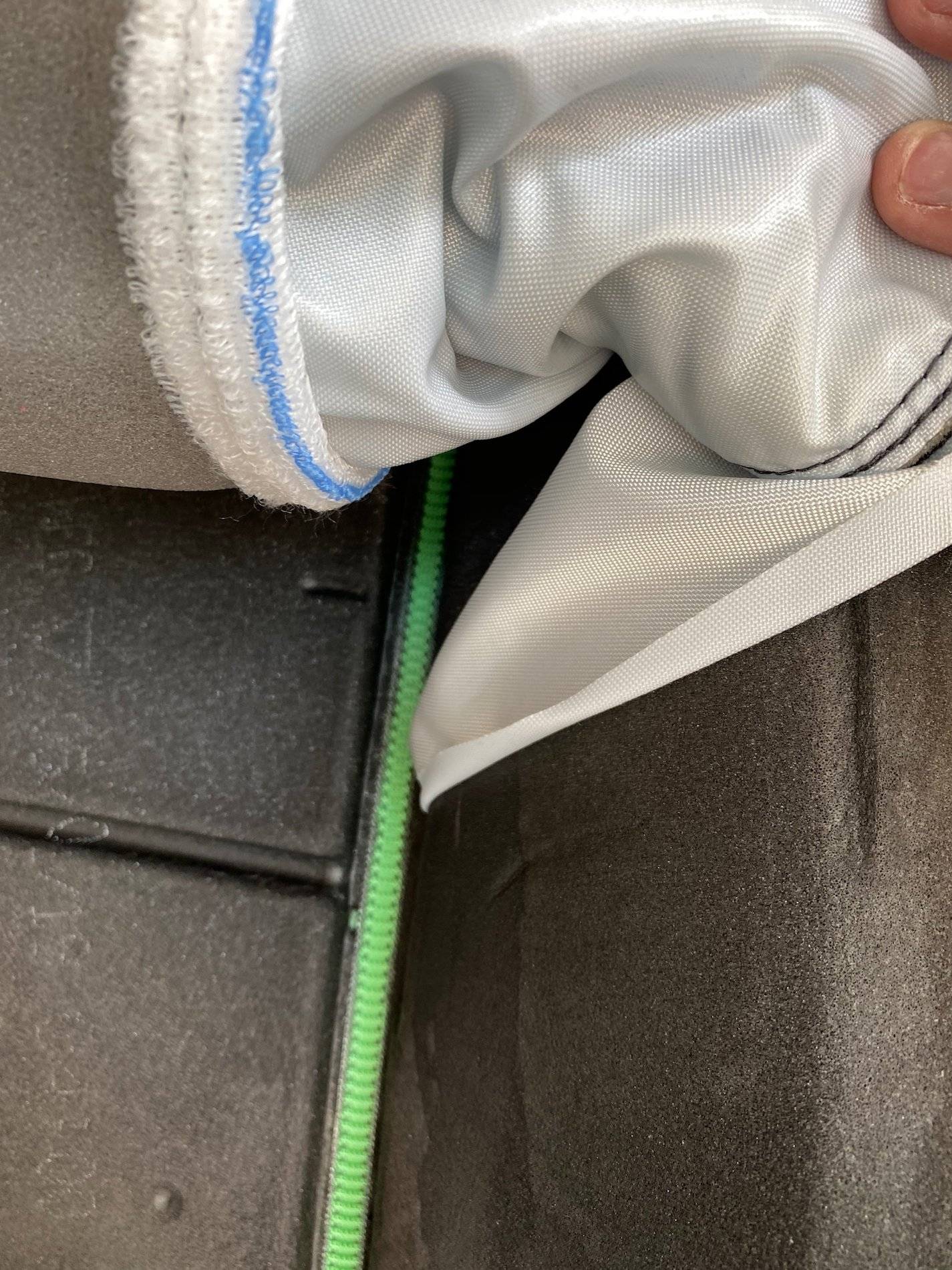

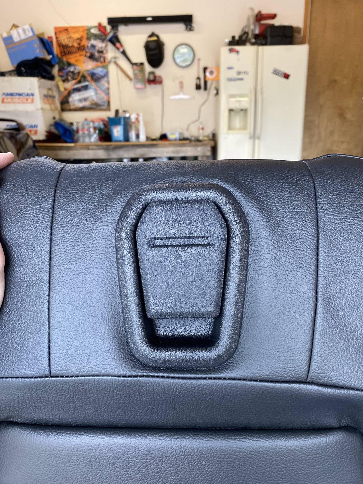

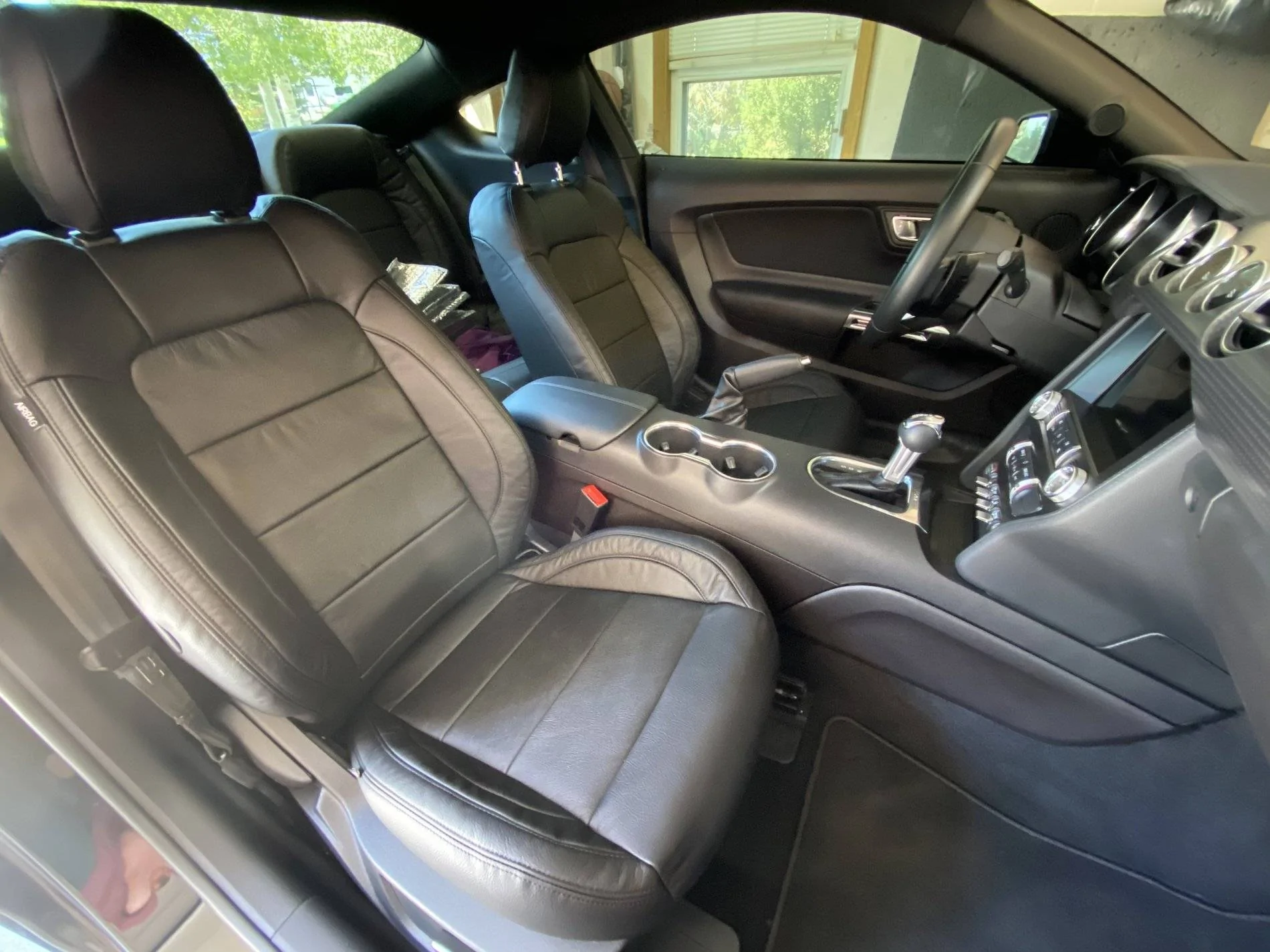

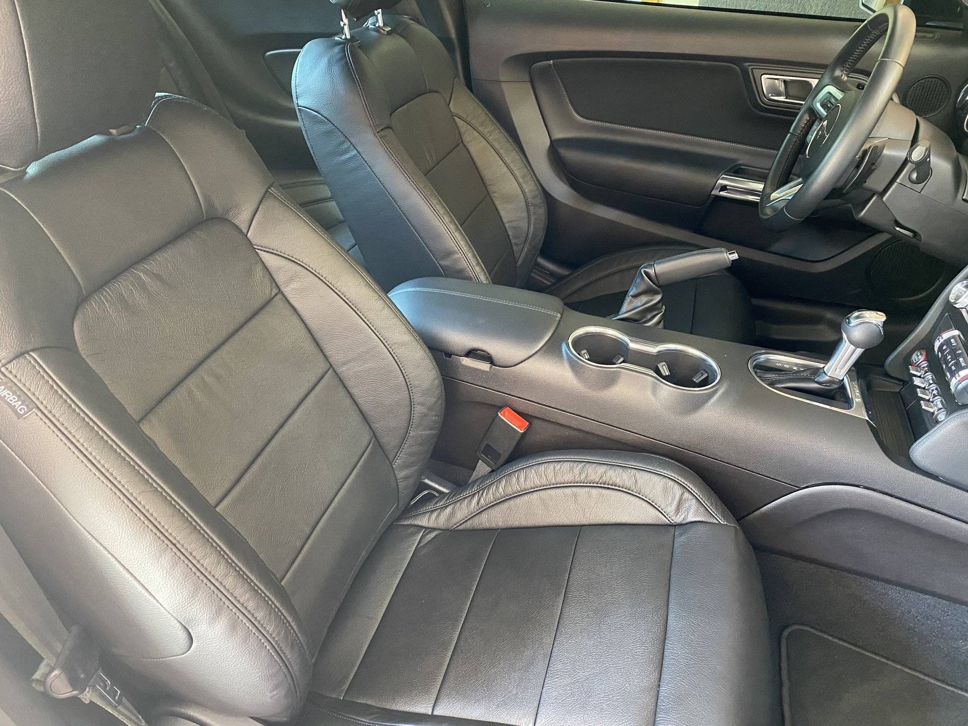

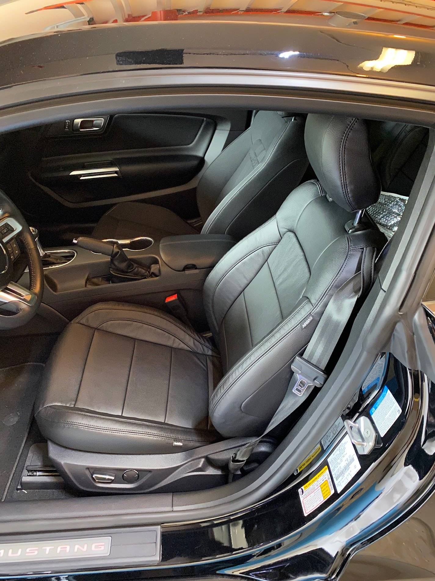

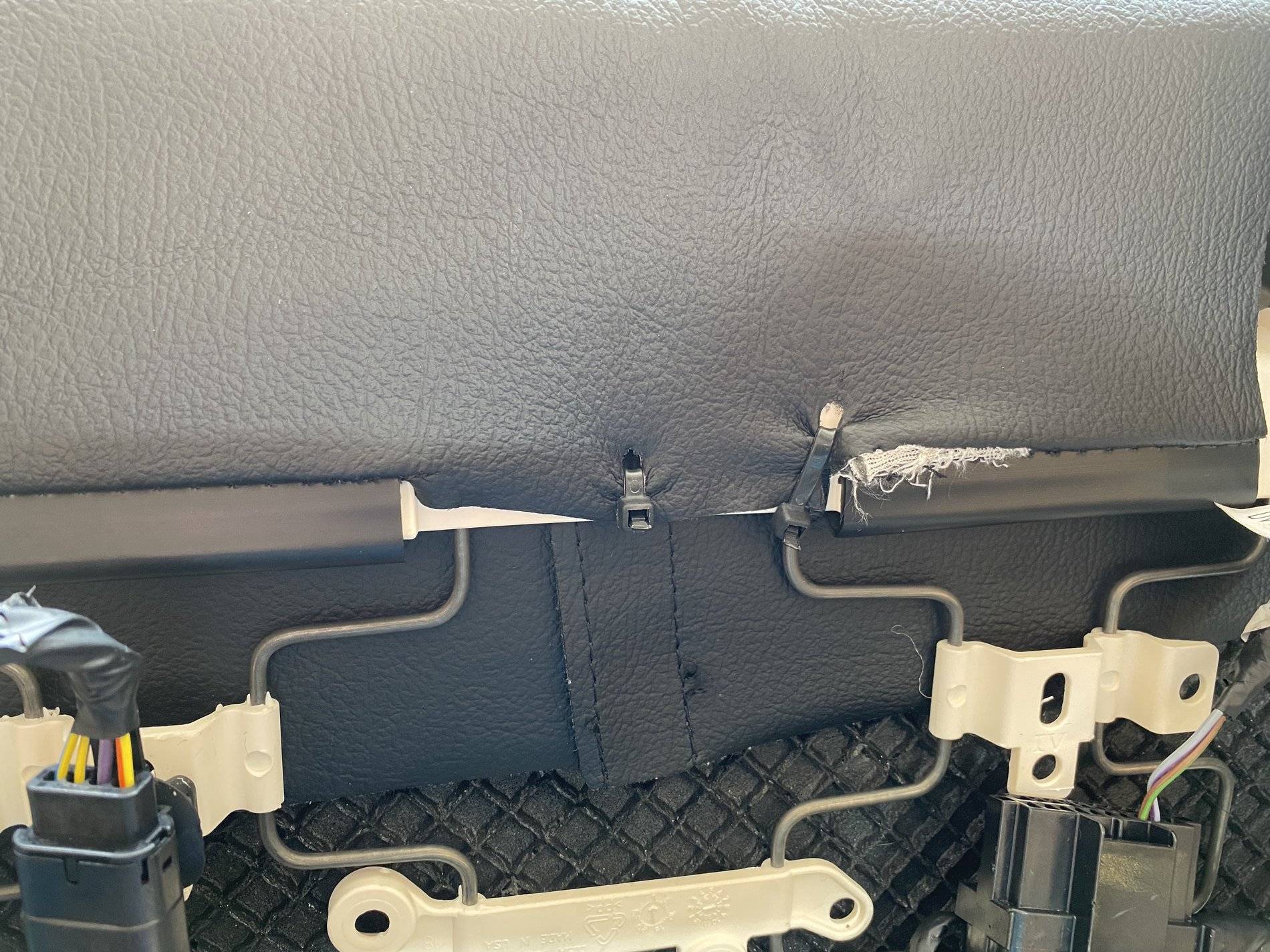

Finished the drivers seat today too. Here’s a few pics. Had one clip tear on me underneath but I just poked a couple holes and zip tied them. My car didn’t have the hanger on the headrest which is fine with me. I used zip ties where the 3 hog rings would have been. I’ll finish the pass seat next Saturday. Overall it was fairly easy taking my time. Just tough on the hands. I left the seats out in the sun and they were super easy to stretch. Honestly the easiest thing to do was the headrest. I got that done, literally in like 2 minutes. I was dreading it.

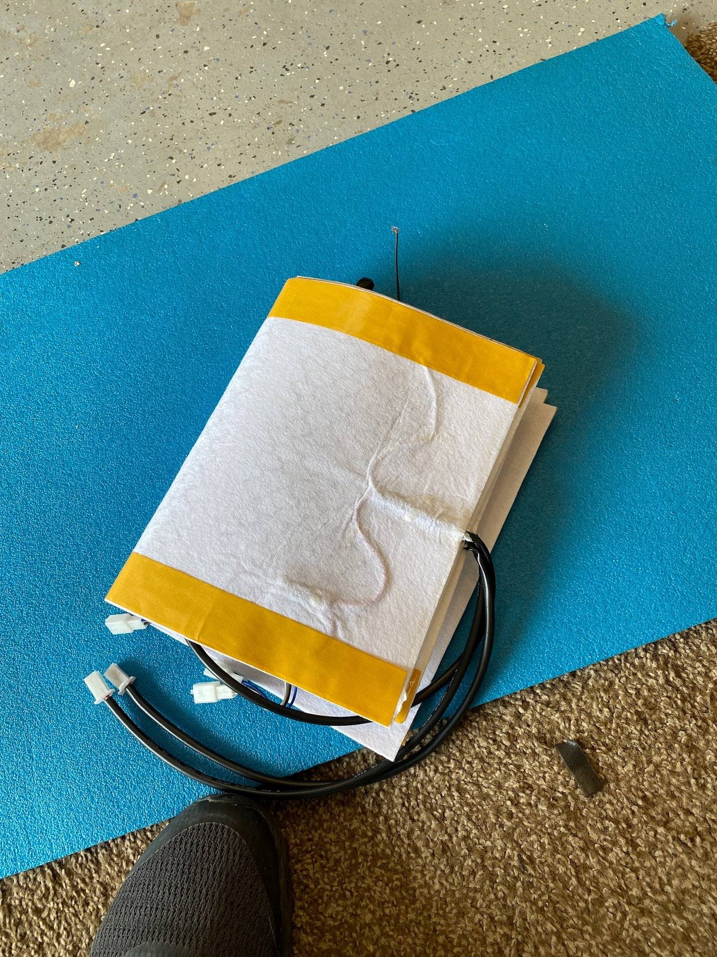

I also installed heated backs. I didn’t install them in the bottoms, as I don’t like the heat because I use them in the summer too for my old back. Lol

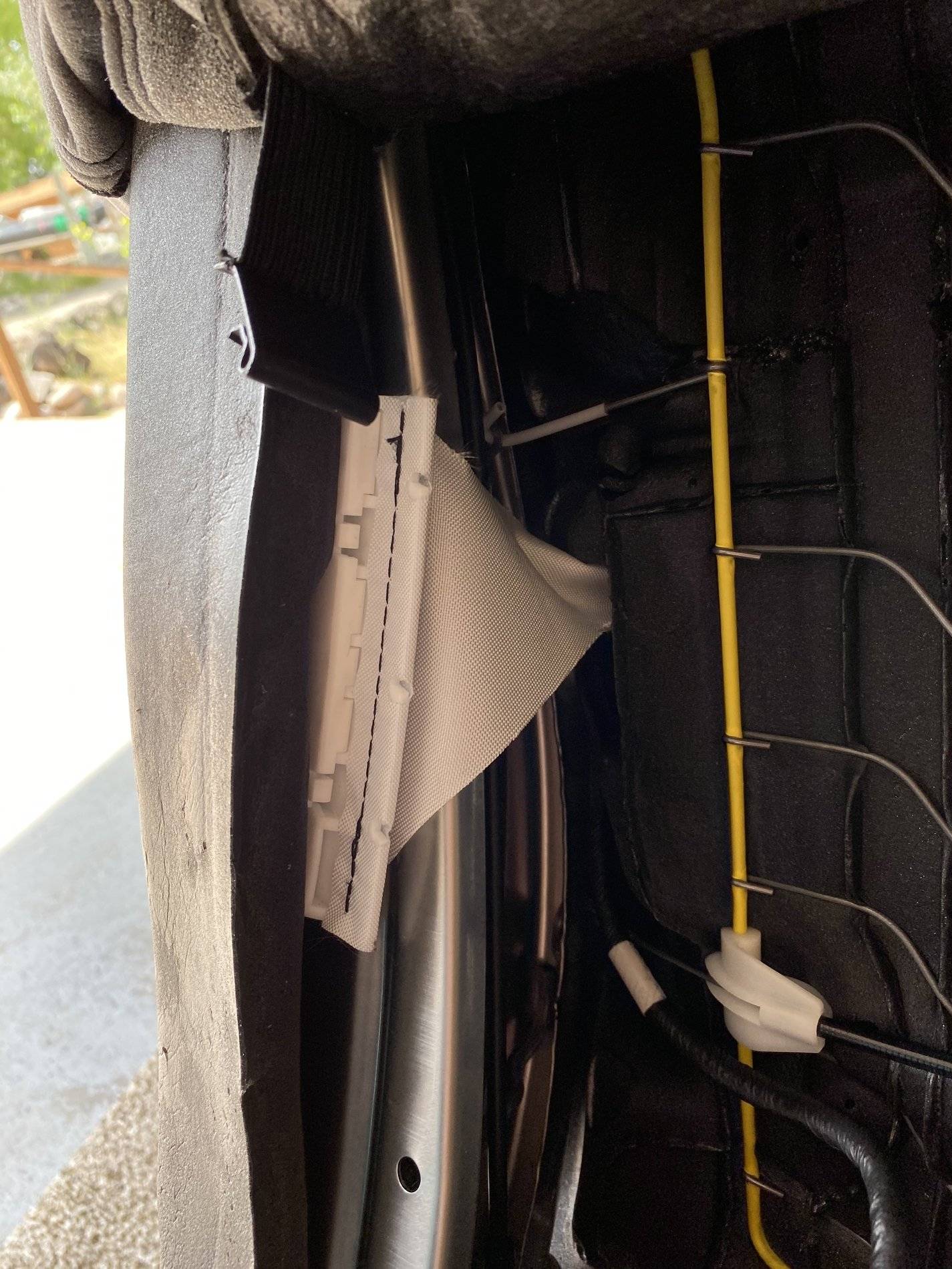

Last one where it tore on me.

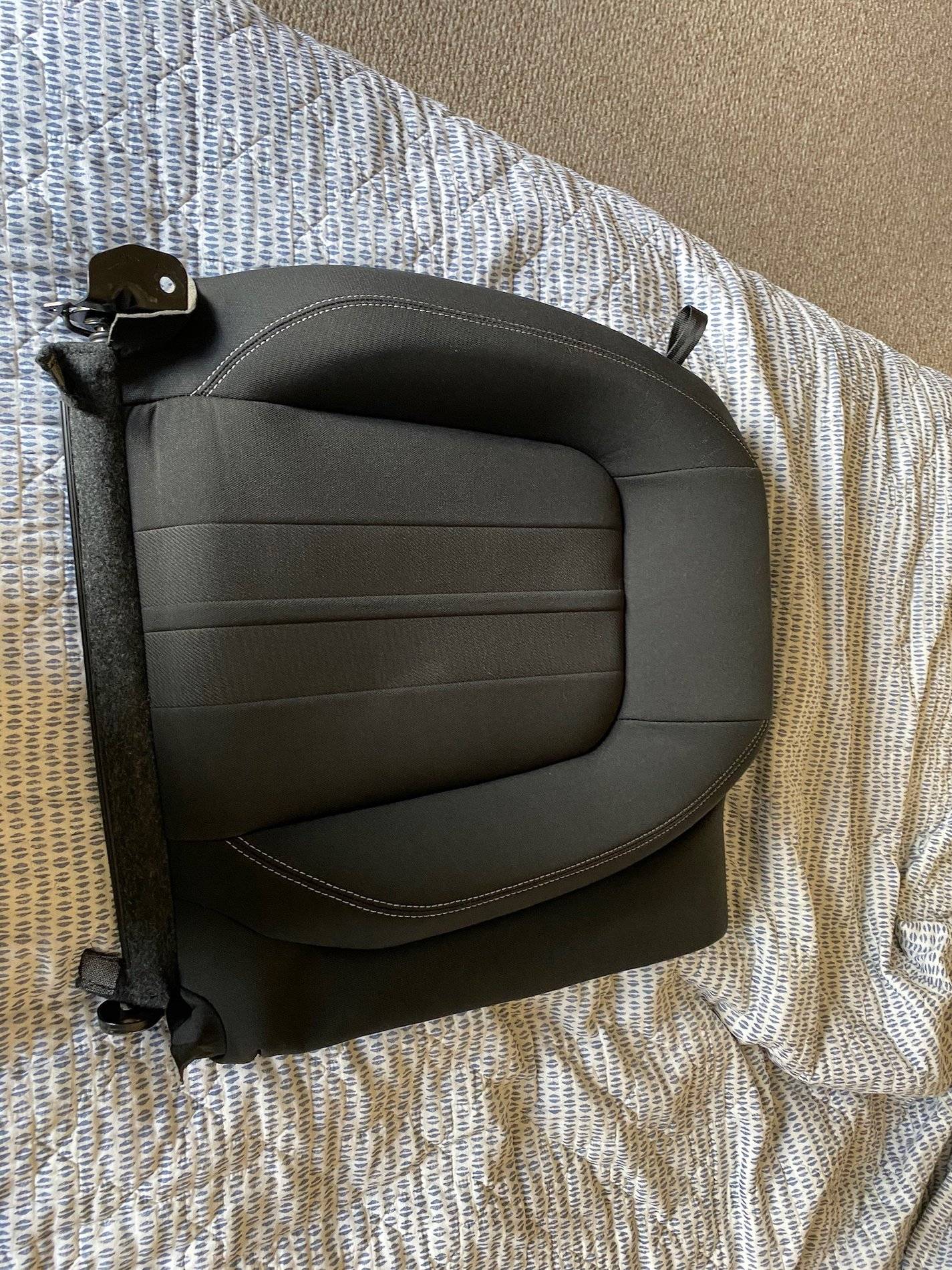

Yes, cloth. In hind sight I should have just cut it off rather that being careful about it. I figured someone around here might want some new cloth. I doubt it. Lol
