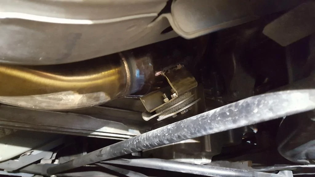

I have the Steeda 4-point and it in no way interferes with an aftermarket downpipe on the EB.
Pic for reference
Pic for reference
When I had a conversation with someone at steeda they said there was a downpipe that was very close to contacting so I decided to just get the 2 point to be safe. Plus for half the price it will still add plenty of rigidity compared to stock for my uses.
