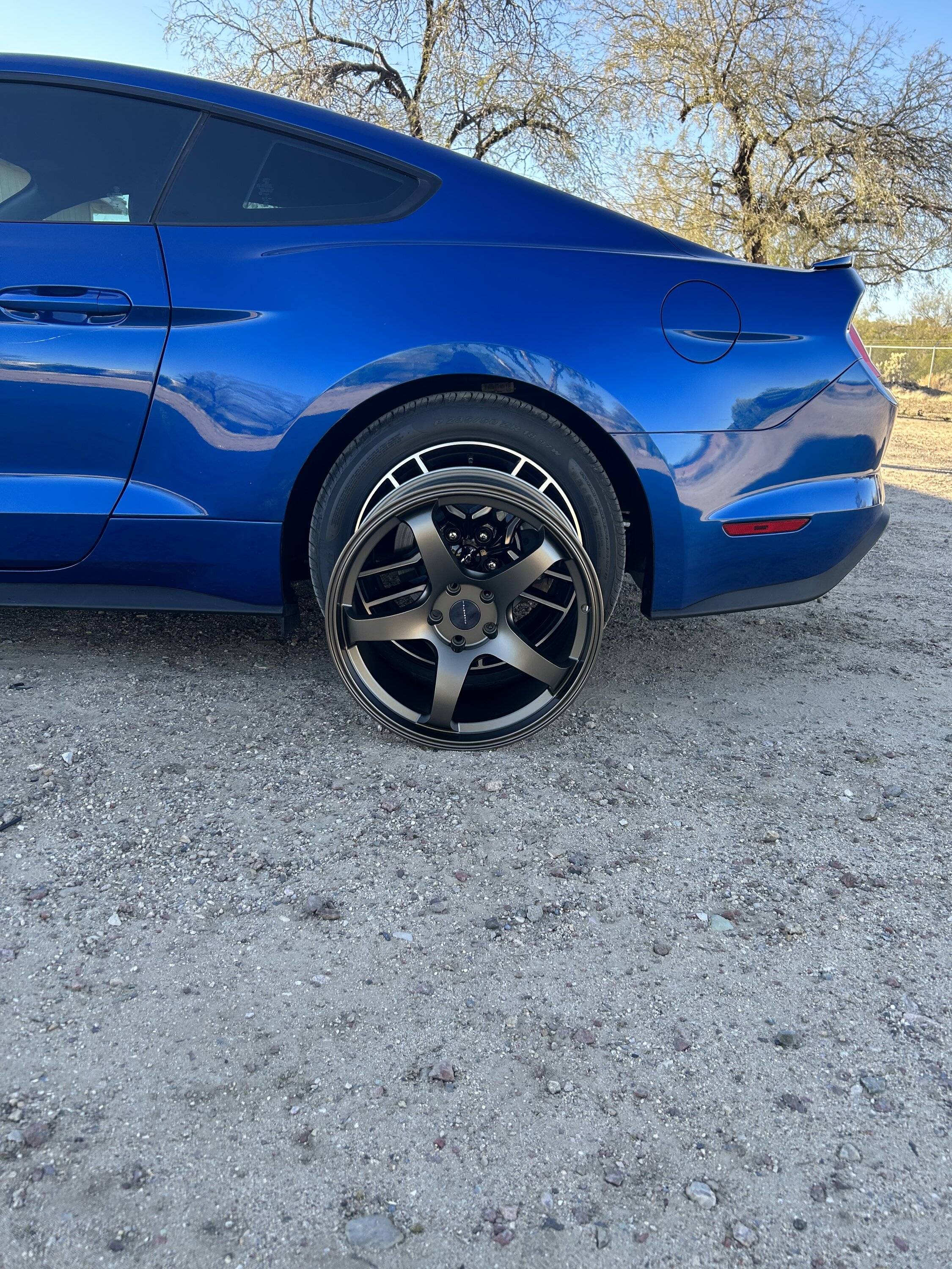

Wheel diameter won't effect ride height. Tire diameter will.
A 1.75" drop on a 30 aspect ratio tire? I'm guessing you don't want to be able to have much straight line traction? You will have less weight transfer and combined with a rubber band stiff sidewall tire, so it's going to be a great drift car!!!
Good looking wheel though.
I had 1st gen ToyoR888s before with a 30 aspect ratio if I remember right(it’s been a few years lol) on my old corvette. I had pretty good traction on the streets even with a 200 hit of giggle juice, but I definitely wasn’t doing dig races on the streets either.
Getting a 35 aspect ratio, for a bit more grip is no big deal. I can go with Falken Azeni RT660 which is a 305/35/19 sticky tire or a Nitto NT05 same size sticky tire. Tire size and compound can be adjusted. But I was definitely leaning again towards the R888rs.
The car will stay NA and sometime in the future might add an N2O hit depending on where I want to go.
Thanks for the heads up.

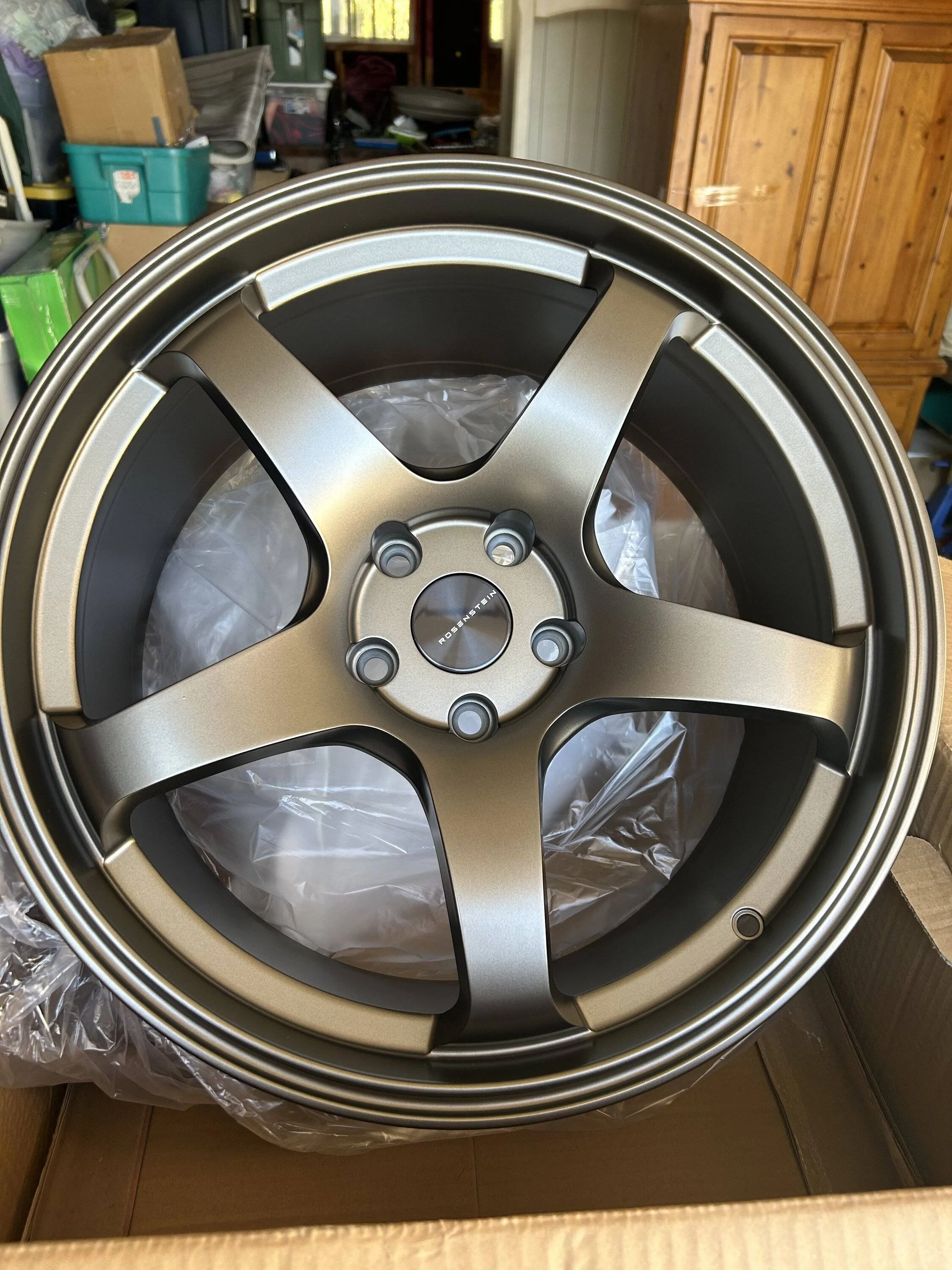

Just came in. Definitely excited. Ordered the hub rings for it. Tires are next and springs. Should have it all set up here in a few weeks. They look great and are really light. Excited about the project.

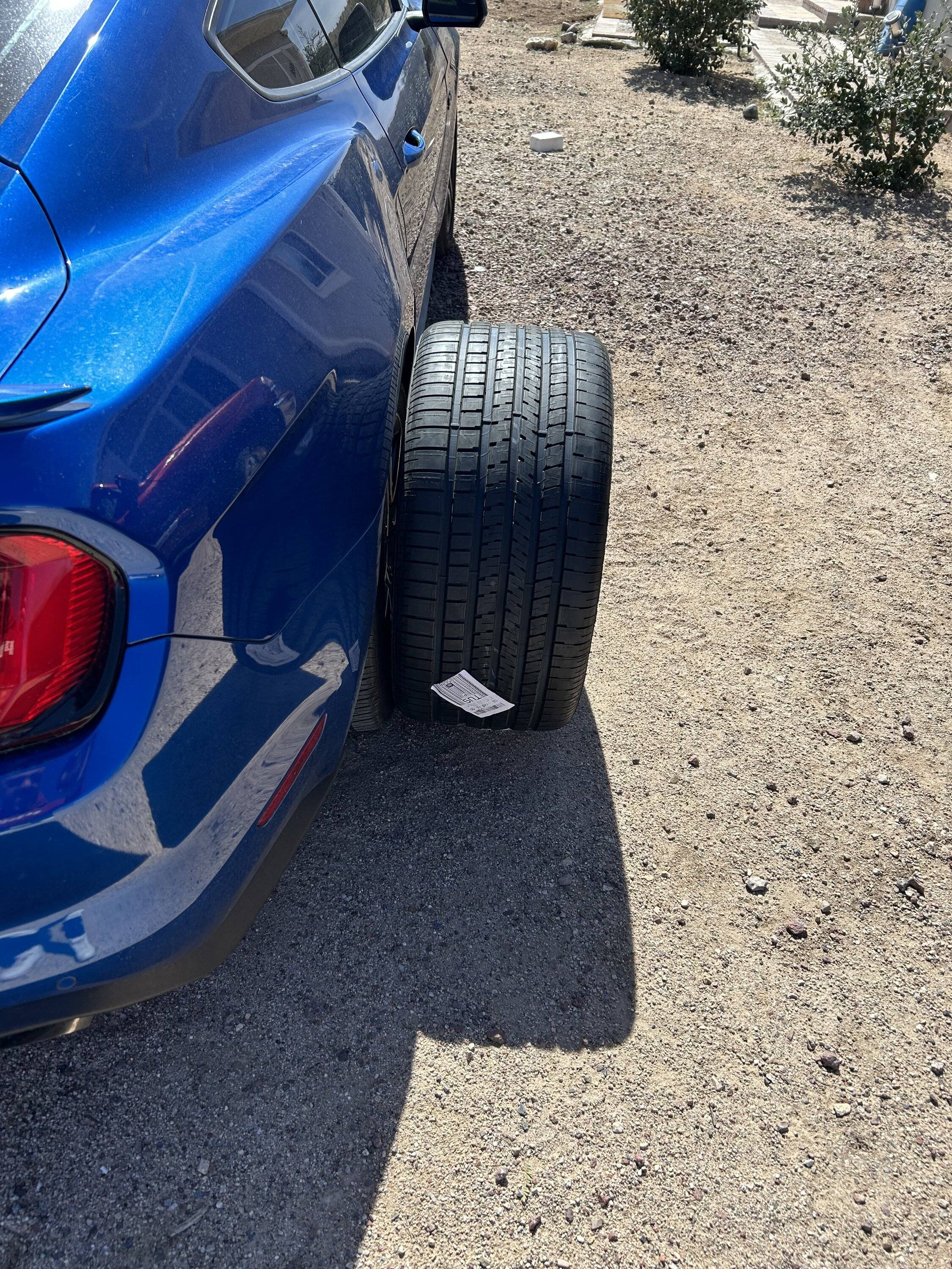

Got the rears in 👀. Waiting on the 2 fronts. These are 315/40 19 Goodyear Eagle F1 Supercar🥰
