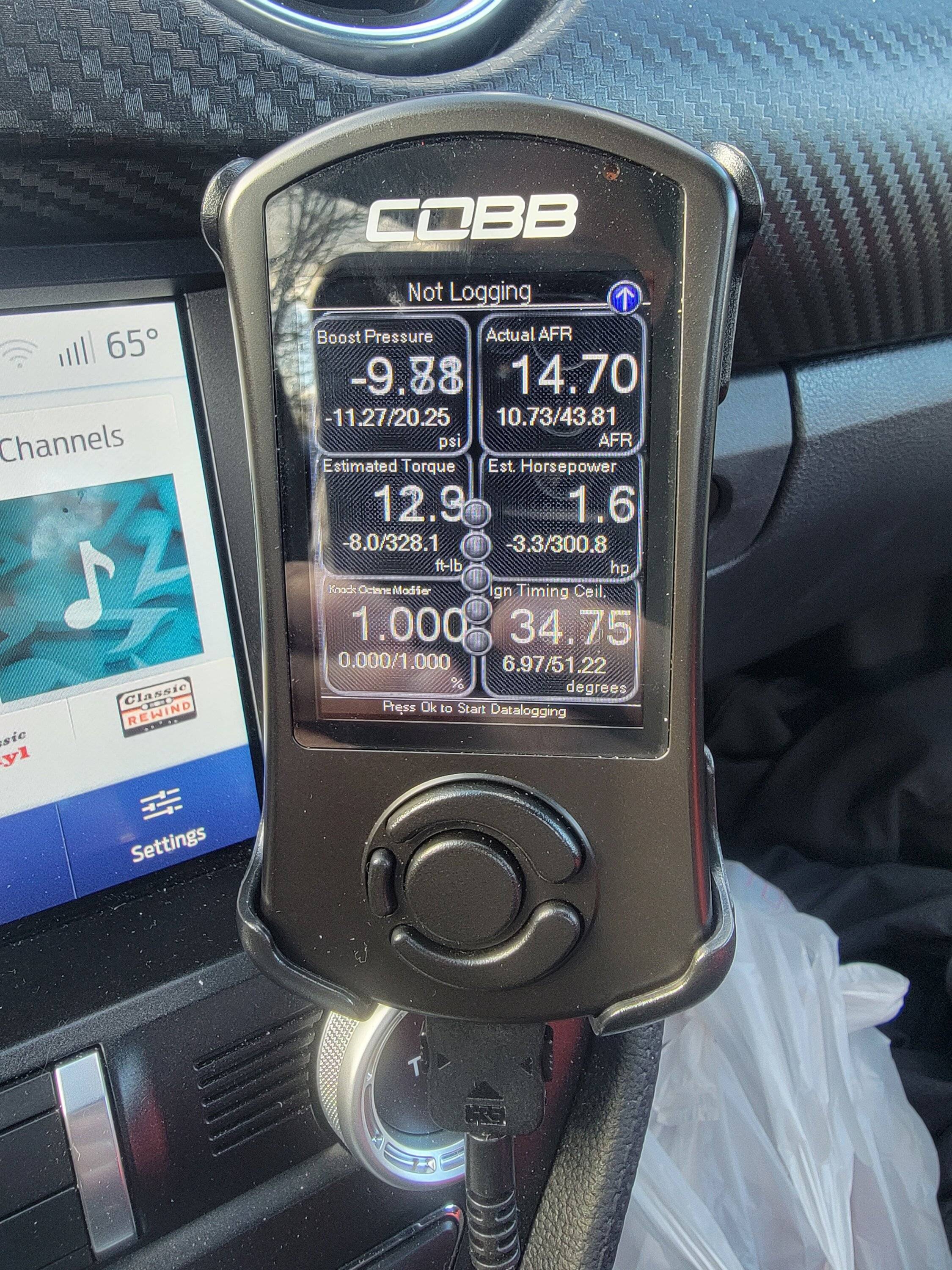

Yes Ranebowcyxx, I am just about to install the same part number turbosmart boost regulator. I am assuming your talking of an Ecoboost Mustang. If so what kind of boost is this 7 p.s.i. unit delivering. I asked because the stock boost is about 20-22 p.s.i.
Am I missing something here?

I am new to turbos so i have yet to understand myself how a 7# wastegate turns into 22#. The way I figure it is like base timing and then the advance comes on as demand increases.

Thanks for the quick response here. Can I ask if you are actually seeing 22 p.s.i on the boost gauge?
Thanks

AS RECIEVED MY ECOBOOST RAN JUST A SHADE OVER 21 P.S.I.

7# is the stock springI have seen posts and reviews that show 10# can be run without a tune. I tend to be a little more conservative and would get a tune anything over stock spring rates. Beside you can always go up on springs as your mods and tunes dictate. It was lightly raining here yesterday so i was limited going all in. I was able to see the boost gauge in the car matched up to the COBB readout.
