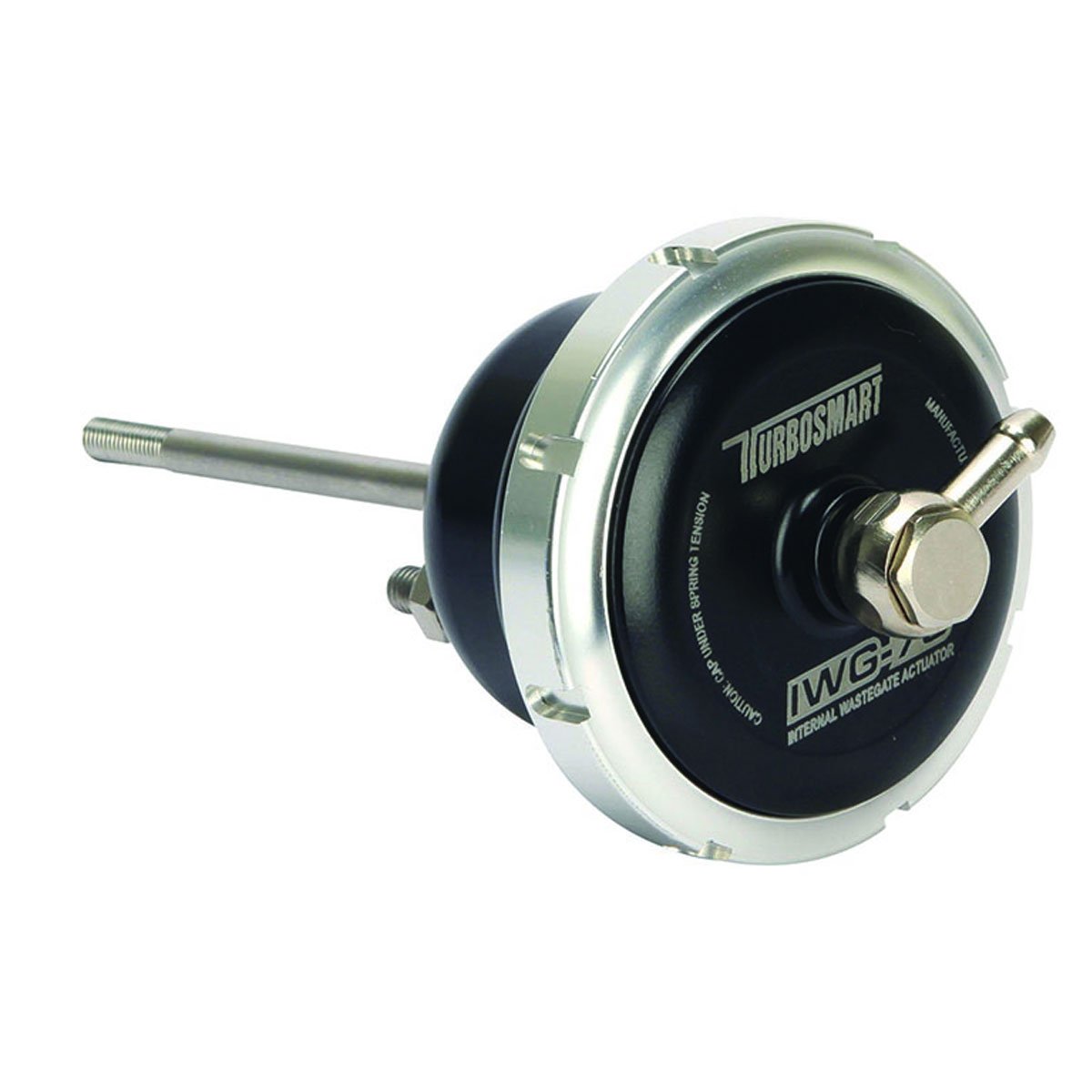

What psi wastegate is the taftory wastegate set at? I see that Turbosmart id offering a 7 and 10 psi option. I know its been stated that its not needed but for the price what can it hurt. Just not sur ethat the rate on the factory unit.

The factory unit is roughly 5 and then massively pre-loaded to around 7.
Get the 10psi unit and only run the recommended 2-3mm preload. ;-)

I tested the turbosmart wastegate actuator on my 2015 Fiesta ST R&D car. It definitely makes a different and is good for some power.
Check out my blog post/write up: http://goo.gl/vbl7KZ
