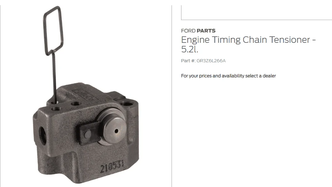

I will say this, when I replaced my primary tensioners with the GT500 ones, my 2K rattle disappeared completely. Perhaps a coincidence, as the Voodoo gets the ratcheting tensioner from the factory.
Some people seem to think that the 2K rattle on GEN3 Coyote is due to the high pressure fuel pump for the DI system coming online, which the GT350 and GT500 don't have.
just for clarity - the voodoo uses this tensioner too. it's actually from the Boss 302 engine program
Yes, that is what I was saying. Meaning that it may be concidence that when I switched to this tensioner, my rattle went away.
