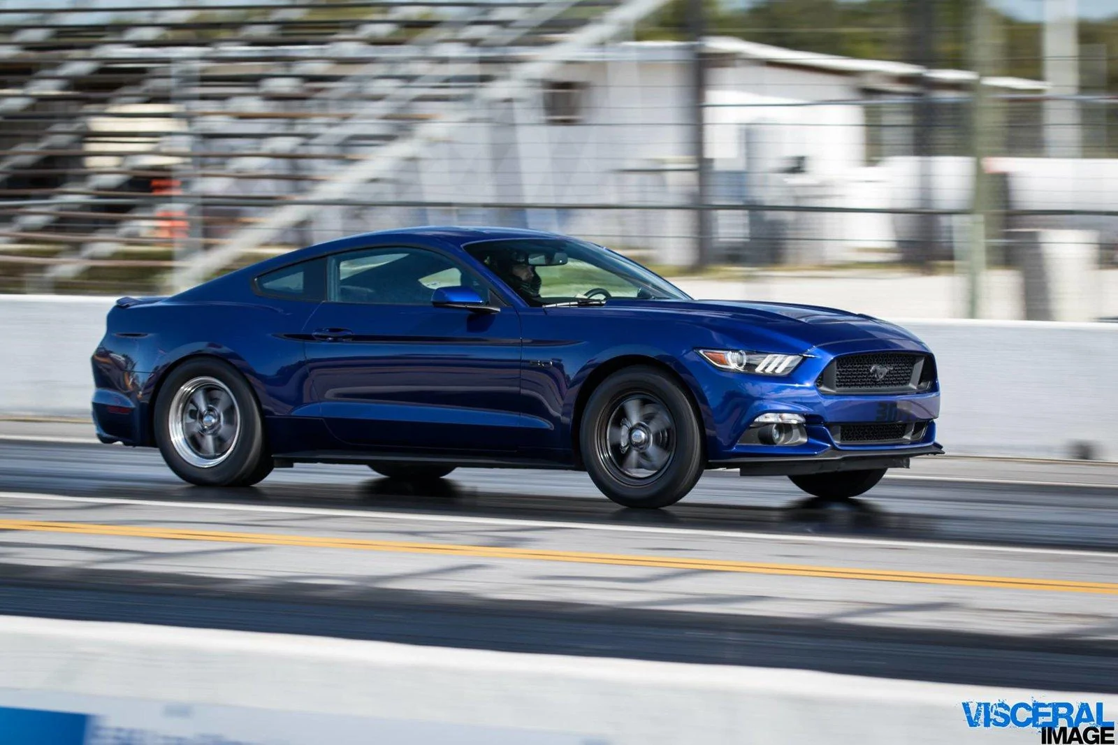

The chassis is like a seesaw. The rear of the S550 squats, and when it does the front rises.
The quickest and best way to get rid of the feeling you mention is to limit how much the rear squats, or to drop the front of the car.
A set of lowering springs that has more front drop than rear, with a linear spring rate that is stiffer than stock, is a good idea based on my experience and perception of your post.
