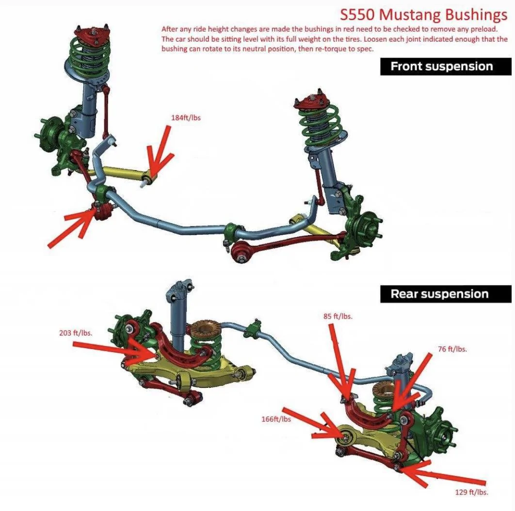

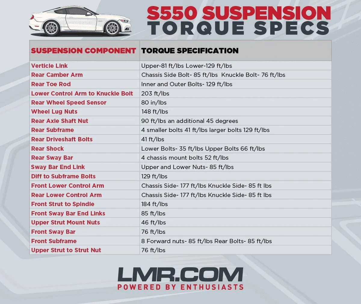

Here are all of the torque specs you need.
Torque the components in red while the suspension is loaded. Easiest way is to jack up the corner of the vehicle right before it lifts off of the jackstands and then torque to spec.

Great info for thise torque specs, thanks. As far as the rear goes I'm also going to be doing the stop the hop starter install. With that said, would it be easier just to drop the rear subframe on both sides while supported with a jack to install the springs and everything else with the stop thenhop kit?
I will be using a lift and replacing all rear suspension components.
Wanted to make sure, I understand, I can put everything back together loosly and then jack up the rear lower control arm and then torque the bolts? Would that work to preload the suspension?
This is my first time.
