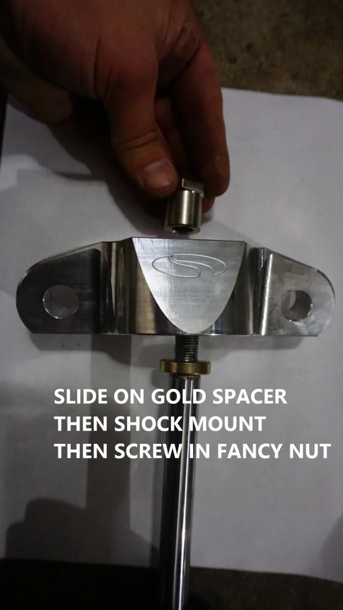

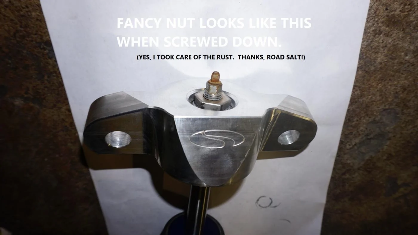

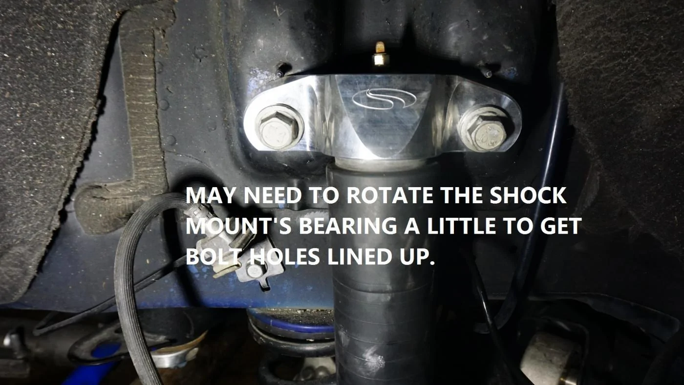

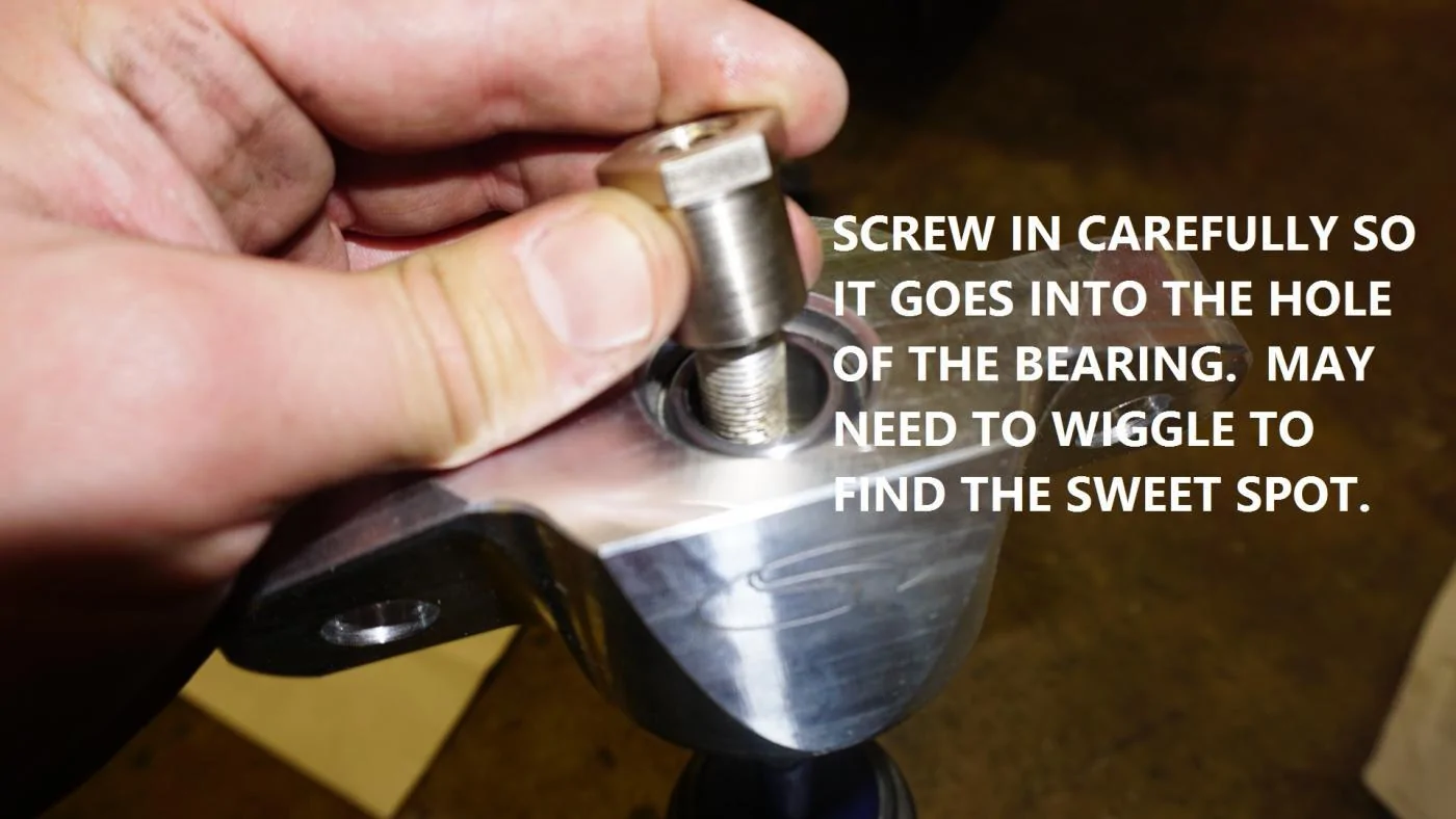

Sometimes instructions don't include enough detail. Here's some tip-a-roos for installing the Steeda Adjustable Bump Stop Kit and the Steeda Rear Shock Mounts (I installed the 12mm for Pro-Action Adjustable Shocks).
Not noted in the photo, I used some anti-seize on the outside part of the fancy nut that seats into the bearing. Don't know if that was a good idea or not, but... that's what I did.
I hope I did these right... given I'm tryin' to be all helpful 'n sheeet.

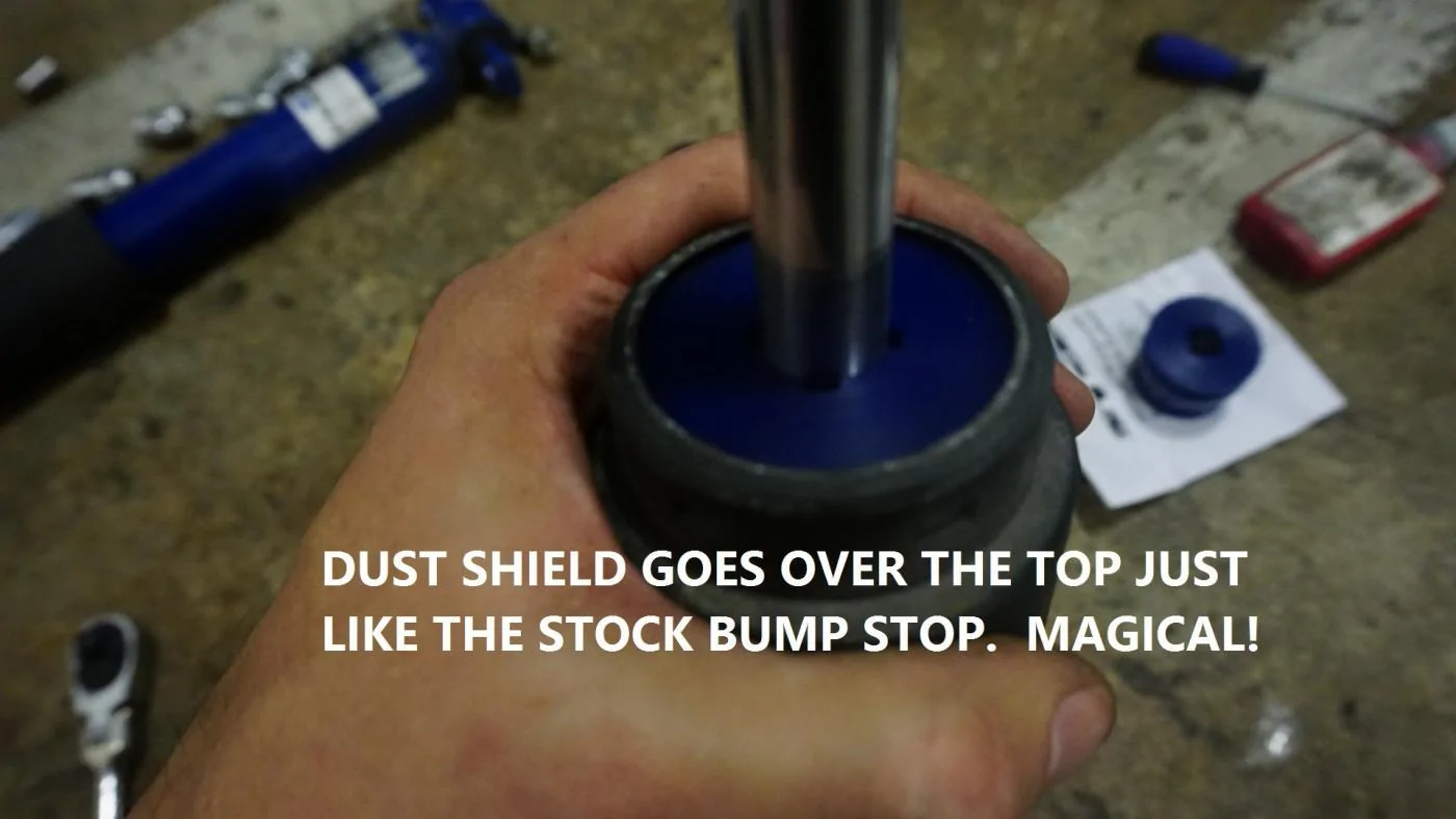

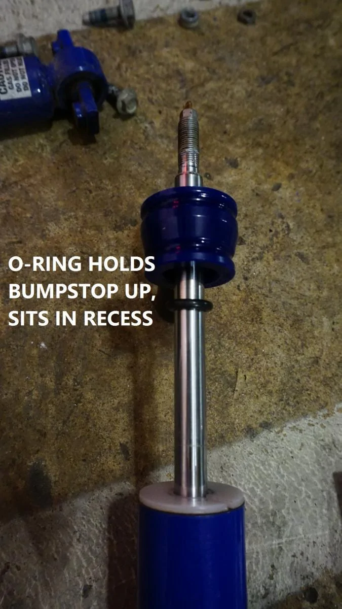

How far down should the bumpstops be placed on the shaft? Or does it matter.
Good if you keep the rear stop, rubber o-ring and dust boot at the top. The boot will nestle into the shock mount keeping the shaft clean.
For front, not sure it matters all that much since the boot doesn't attach to the bump stop.
Push them up just like you see in the picture of the shock mount before installing. Doesn't matter where you leave them when installing, though... once you drive the car and go over a big bump they'll seat themselves.
