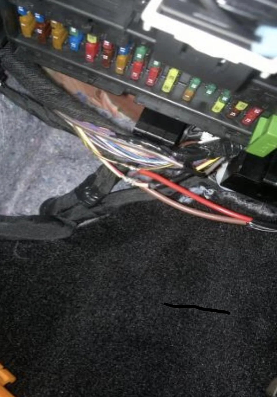

Snider
Apr 8, 2019
Fort Worth
Ryan
2016 GT/CS (race red)
There’s a brown wire with yellow stripe that acts as a true “accessory” wire that turns on and off with the ignition with no delay in either kick panel. Near the fuse box on the passenger side, and from the wire loom entering the driver door grommet.
Same circuit is available at the harness going into the rear view mirror (same color wire) and is available at the amplifier on premium and shaker sound systems.
