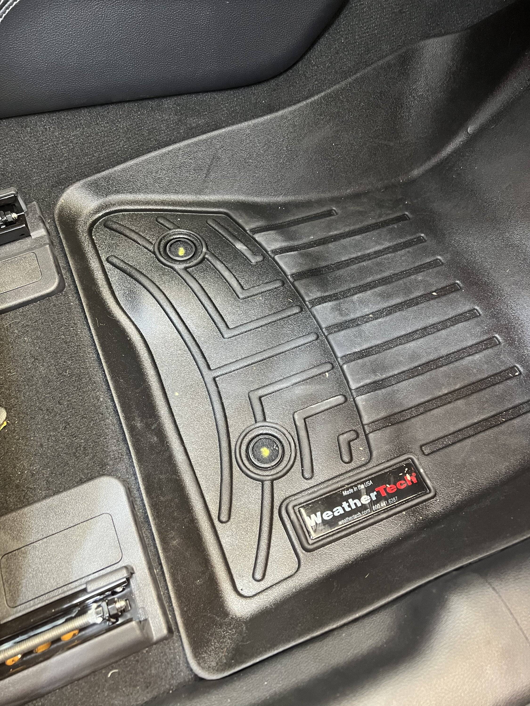

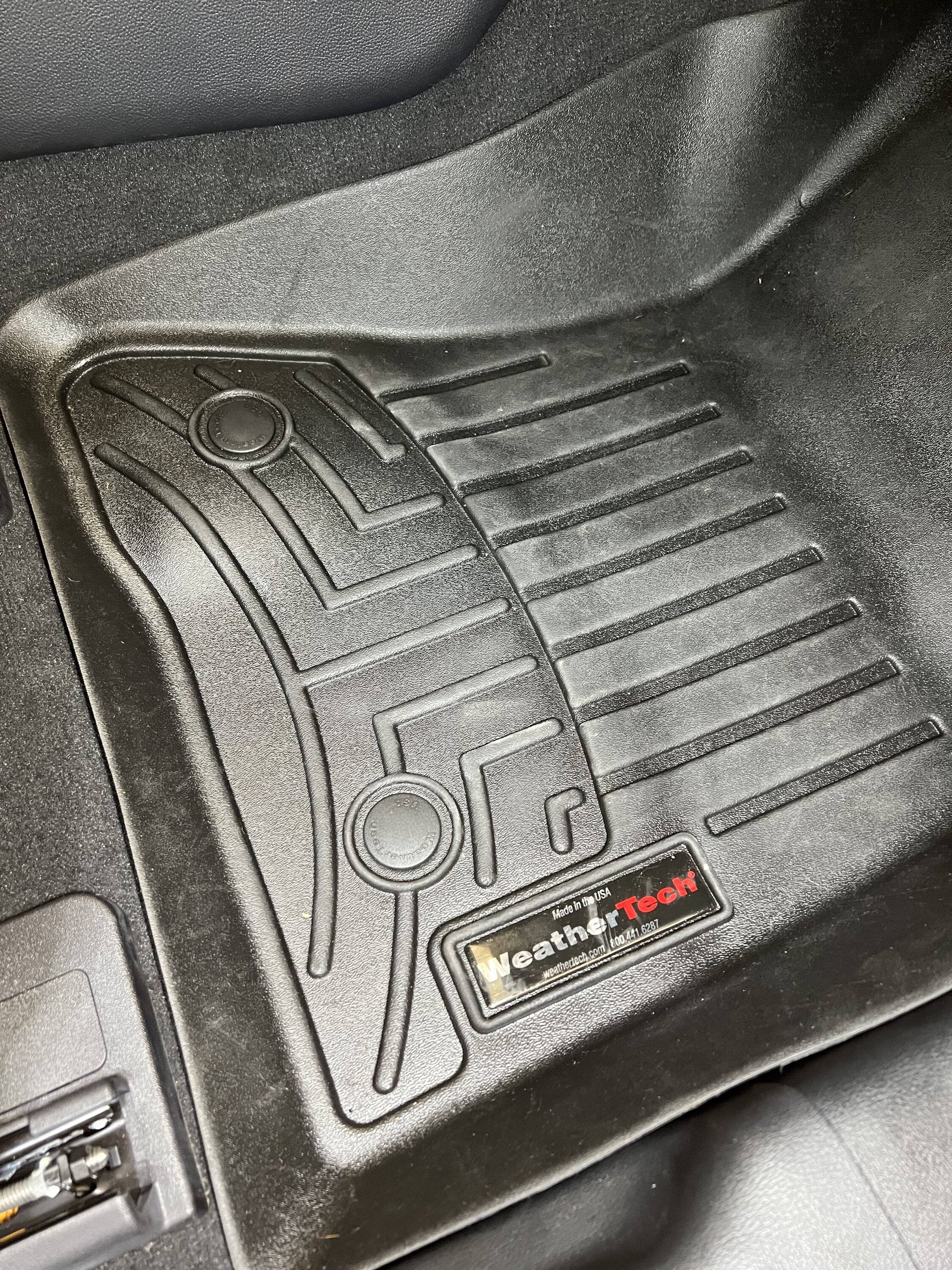

Installed passenger side floor mat retainers today!
Highvolts
May 13, 2022
332
537
Ohio
Jason
2022 Mustang GT, 1965 Mustang 289

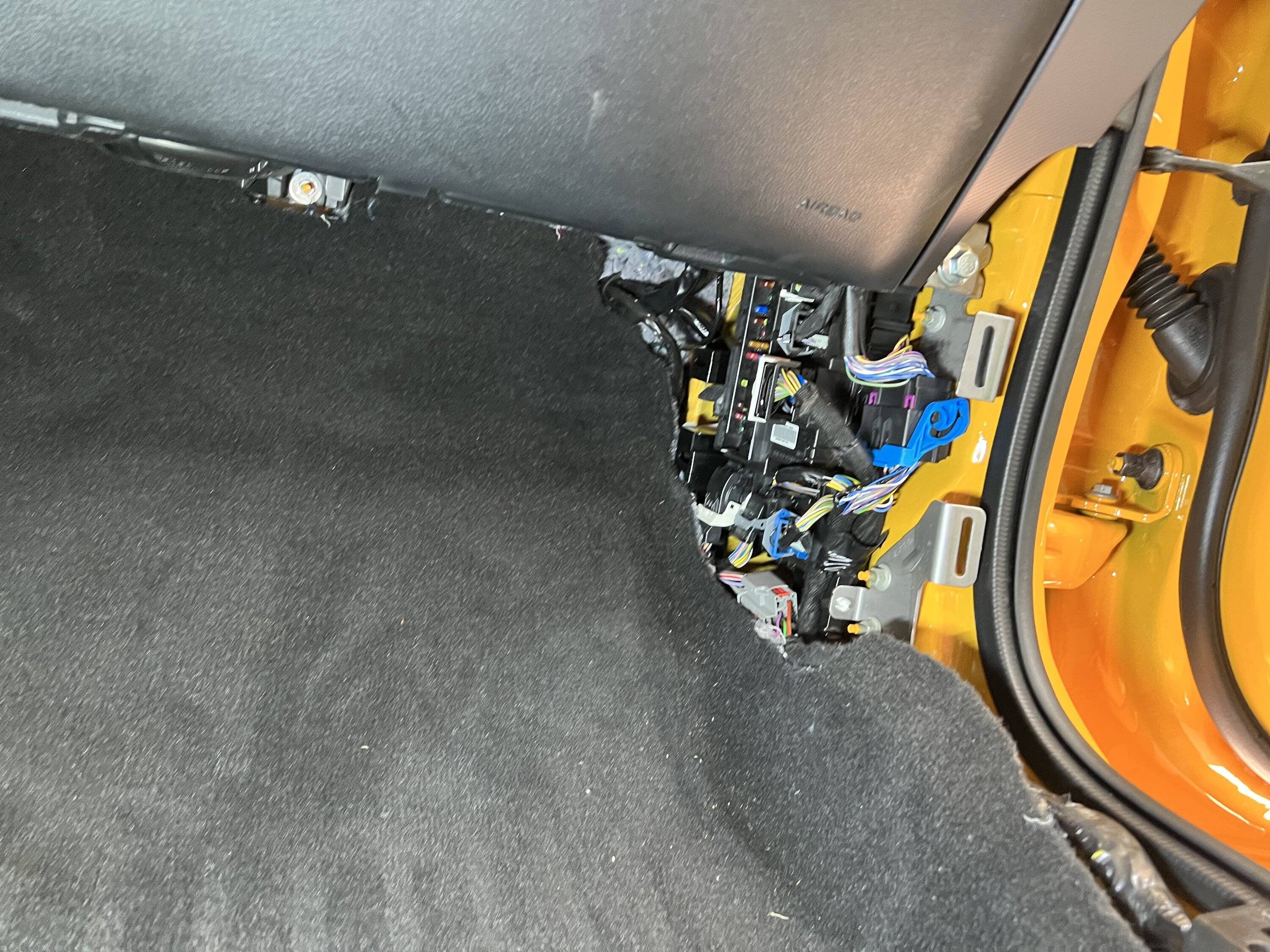

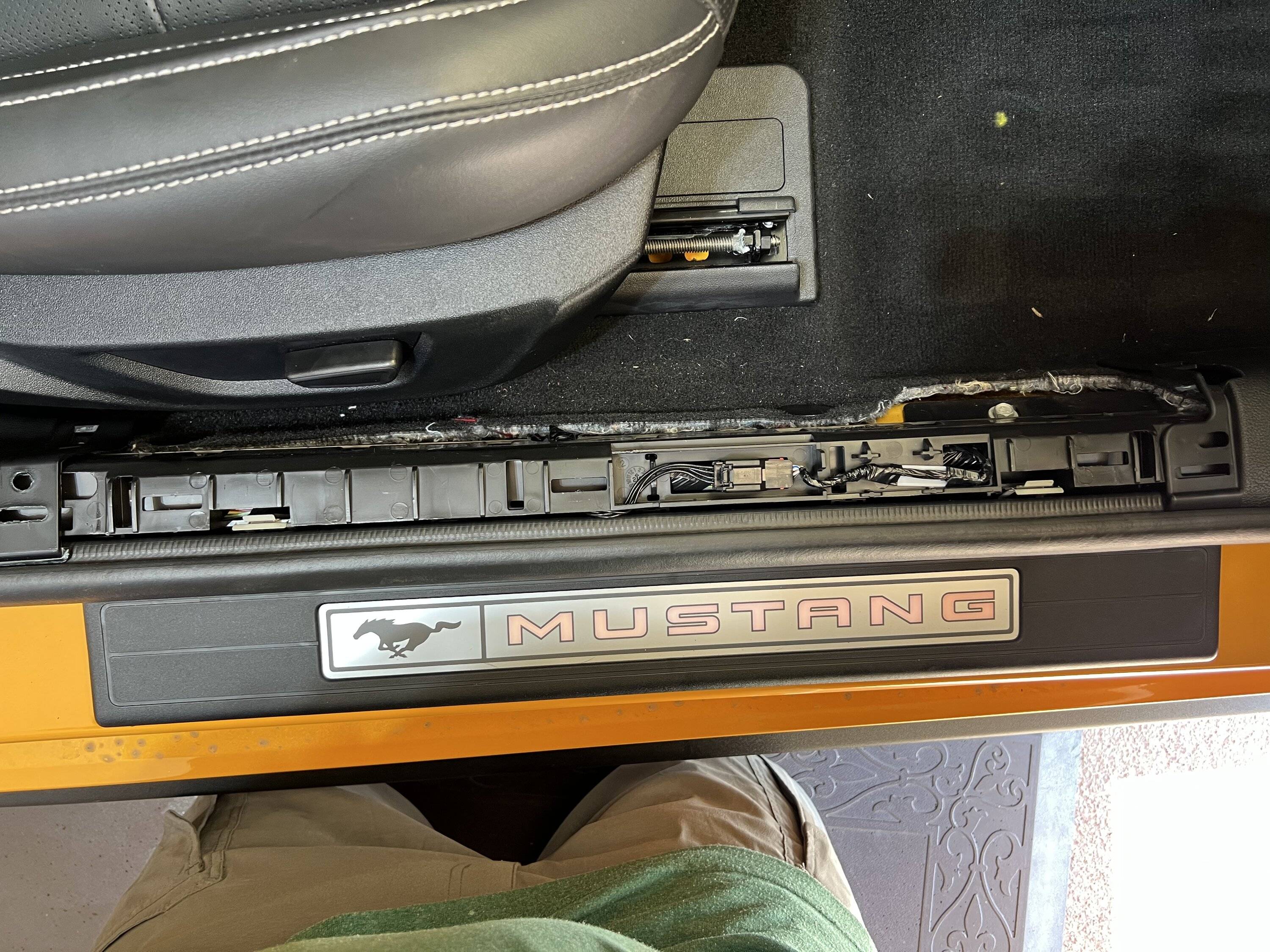

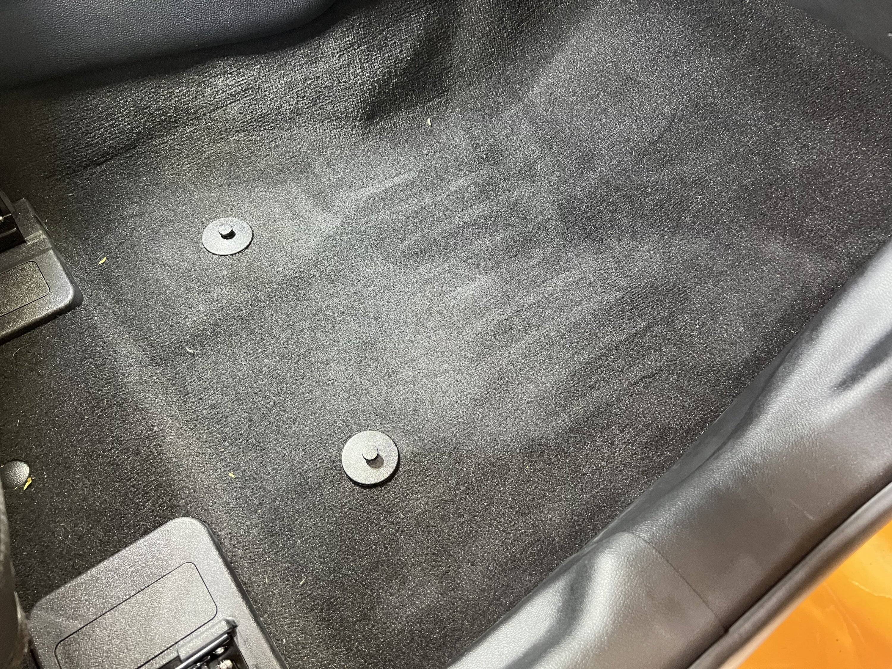

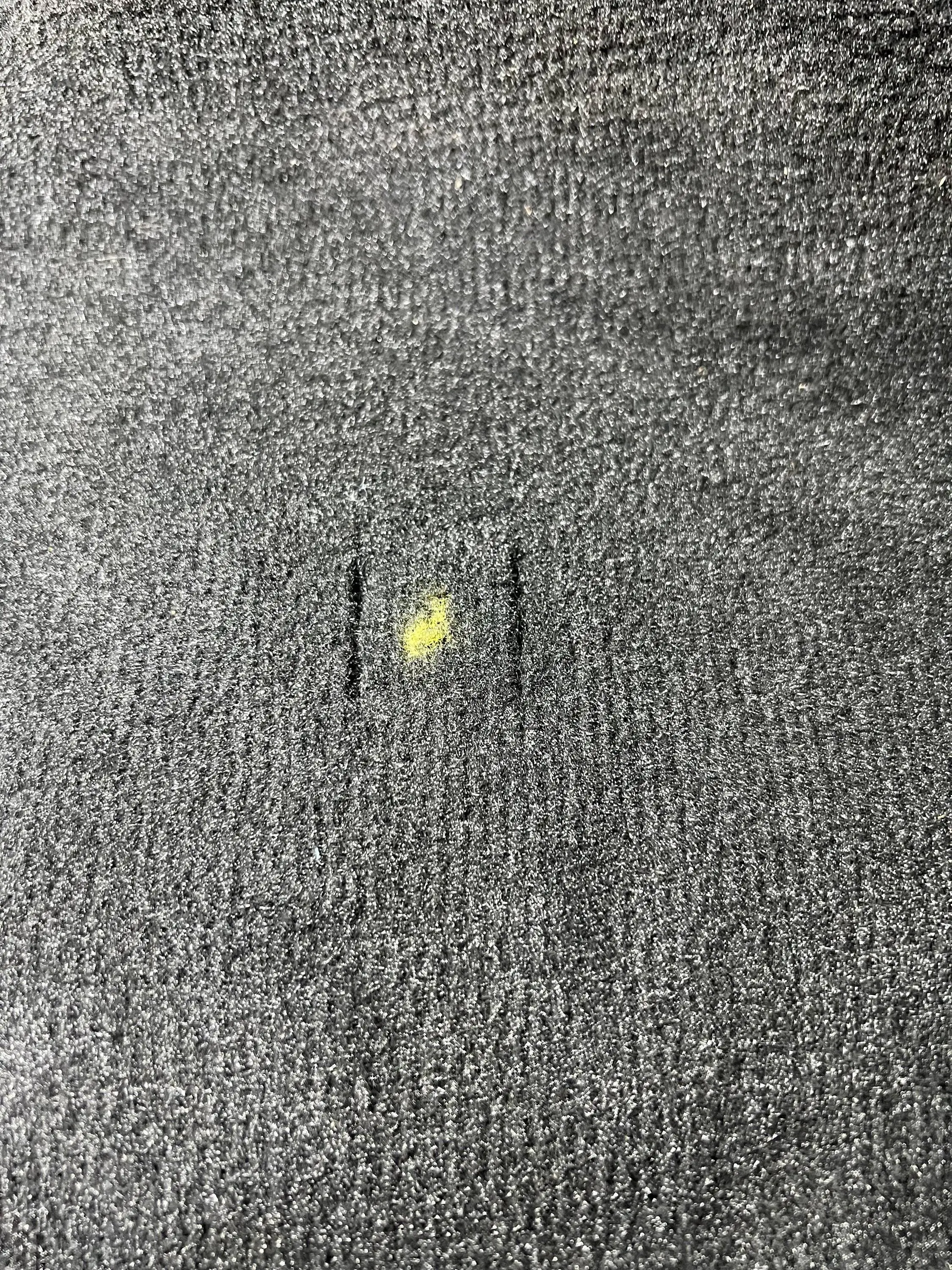

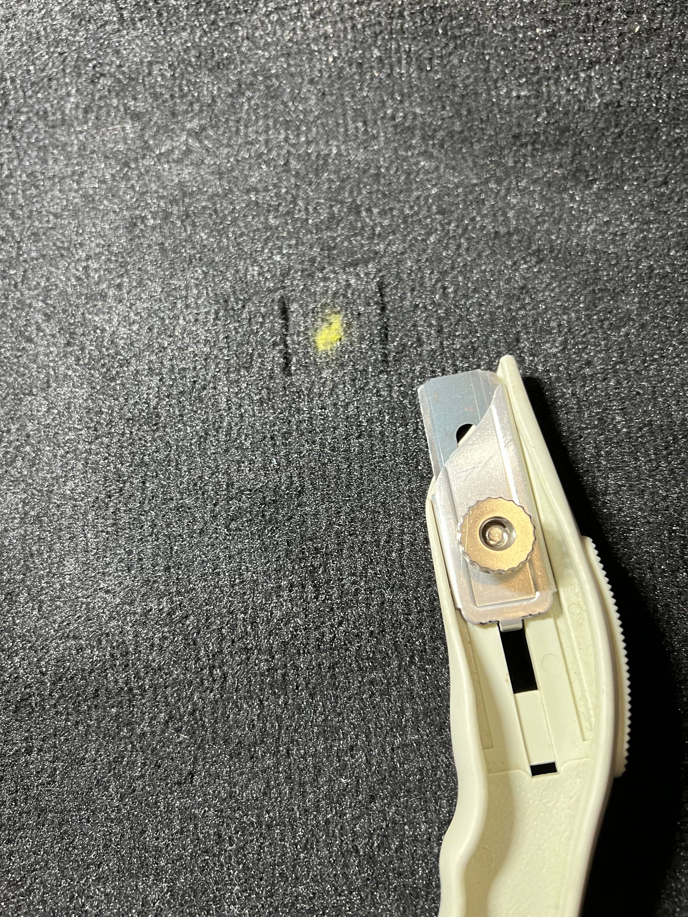

Got the parts (2x - W715014-SS3JA) from Levittown Ford and marked where my WeatherTech Floormats naturally laid. I removed a few trim pieces to get under the carpet to make sure I wasn't cutting into anything. Cut two 1 inch slits one inch apart in the carpet for each retainer.
I think it came out well!

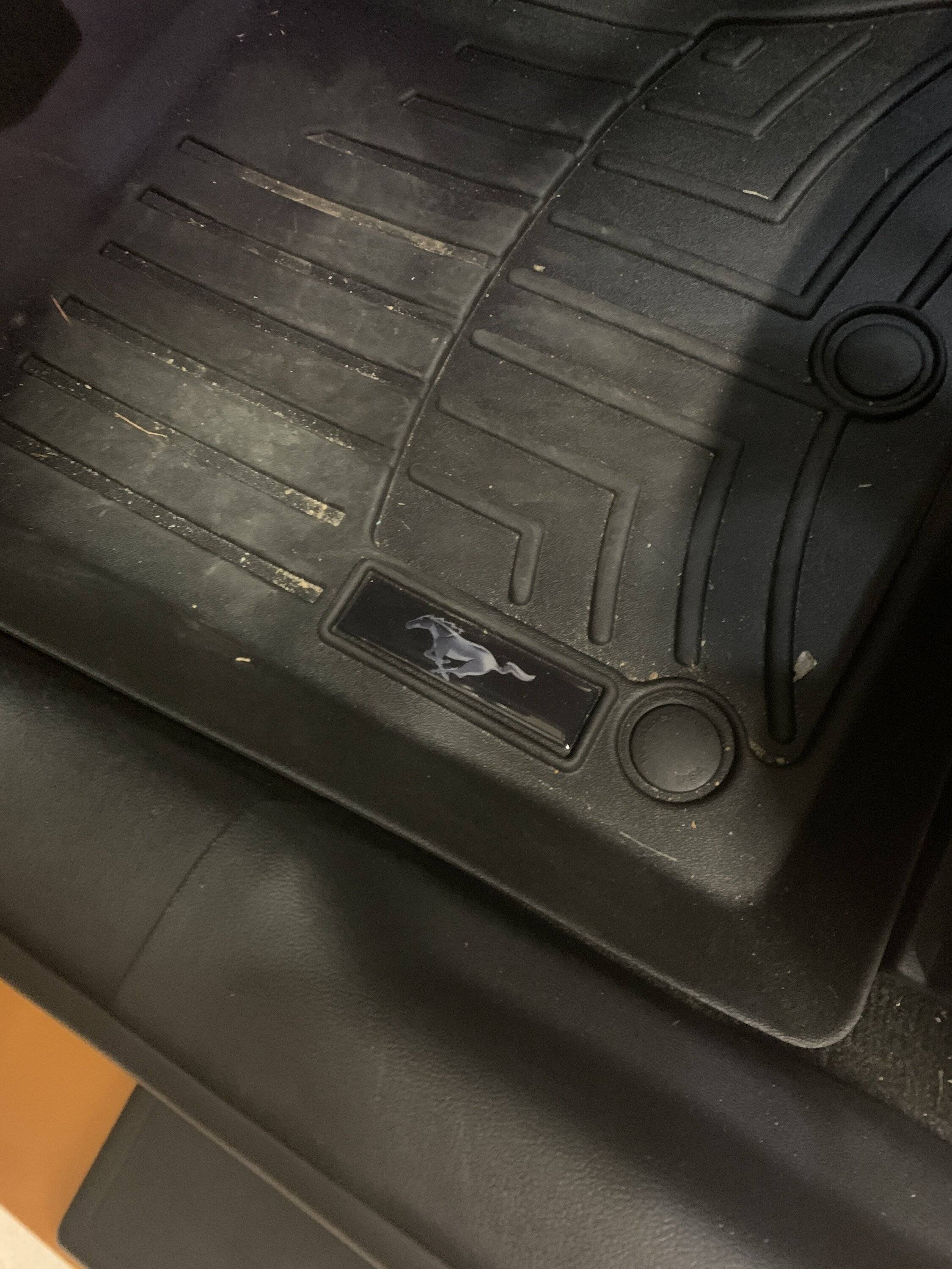

Nice! I got some pony badges from Etsy to replace the weathertech badge to make them look more OEM. Just wanted to let you know options are out there if you are interested.
Oh! That sounds nice - would you mind sending me a DM with a link?
Thanks!
I'd love to see those.

That is great :)

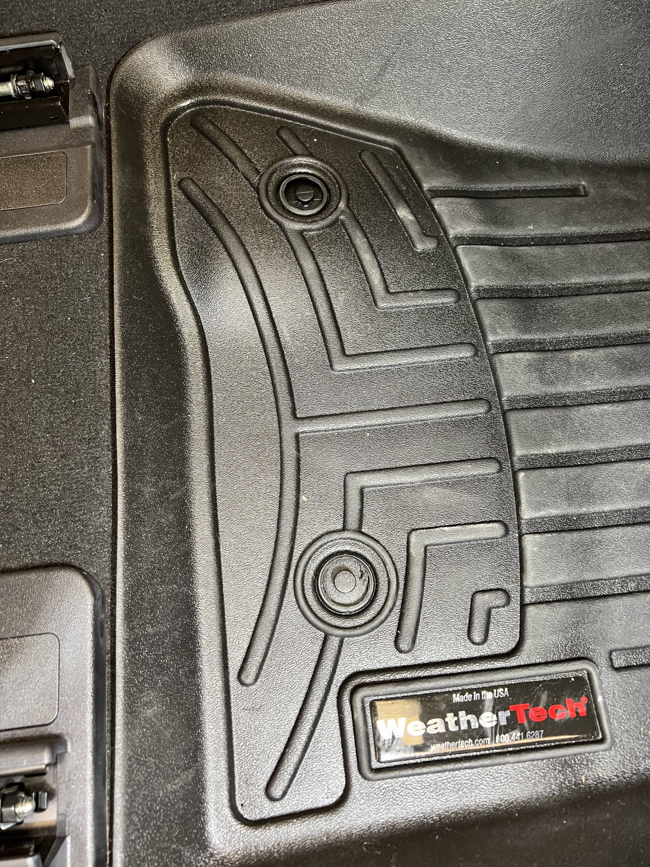

I have passengers most the time. So for $15 this was an easy fix. Perhaps the weather tech mats should have some grip studs on the back. But they don't.

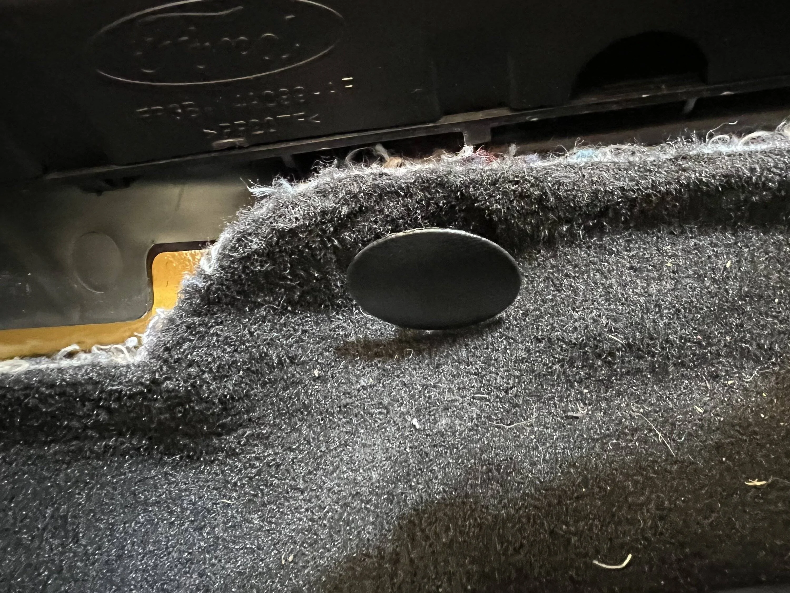

So, do 2015+ Mustang weathertech mats have the clips for the retainers that aren't present on the carpet of the car? This is one thing that REALLY irritates me - coming from a 2014 GT that had the retainers LH/RH to my old 15 and now my 21 that are LH only....
You are exactly right. The clips were on the mats already, but no hooks from the factory installed on passenger side.
I wonder - could I remove the clips from a LH carpet mat, install them on a RH carpet mat - buying an extra set of mats to do this...and then install the other clips into the carpet, and accomplish this same thing with carpet mats?
I think all you would need to do is install some grommets in the stock floor mat and then they would slide over the carpet retainers.
That's what I'm thinking...Ford does not sell the clip separate from ANY floor mat

That looks SOOO much better.
